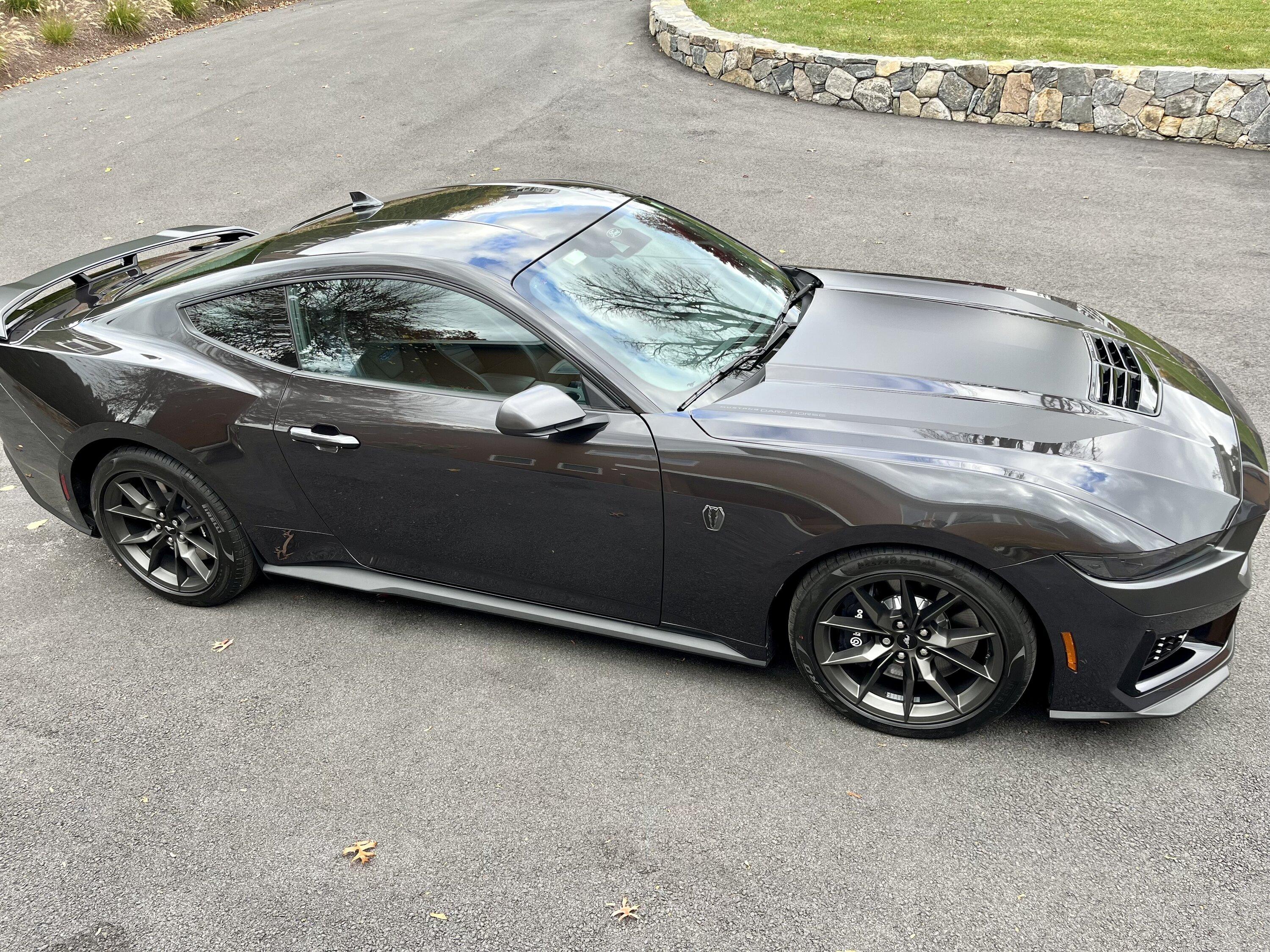

Picked up my Dark Horse today! Drove it home and all was well. Took my wife out for a ride and all was fine. Parked for 10 minutes while I showed my car to a neighbor and then it would not start. Dashboard lit up like a christmas tree with all sorts of error codes and service items. The radio worked and there was power but the car would not start. I called the dealership who was actually awesome and they sent a tech to my house at 430 pm on a Saturday night!! He ran a diagnostic and all he got was a low voltage code but by then the Car magically started. He decided to replace the battery with a brand new one and then he was able to clear the code. Car started fine the rest of the evening. Still kinda concerning after 75 miles. The rest of the car is awesome and it’s a blast to drive. I hope that’s the last of that issue.
