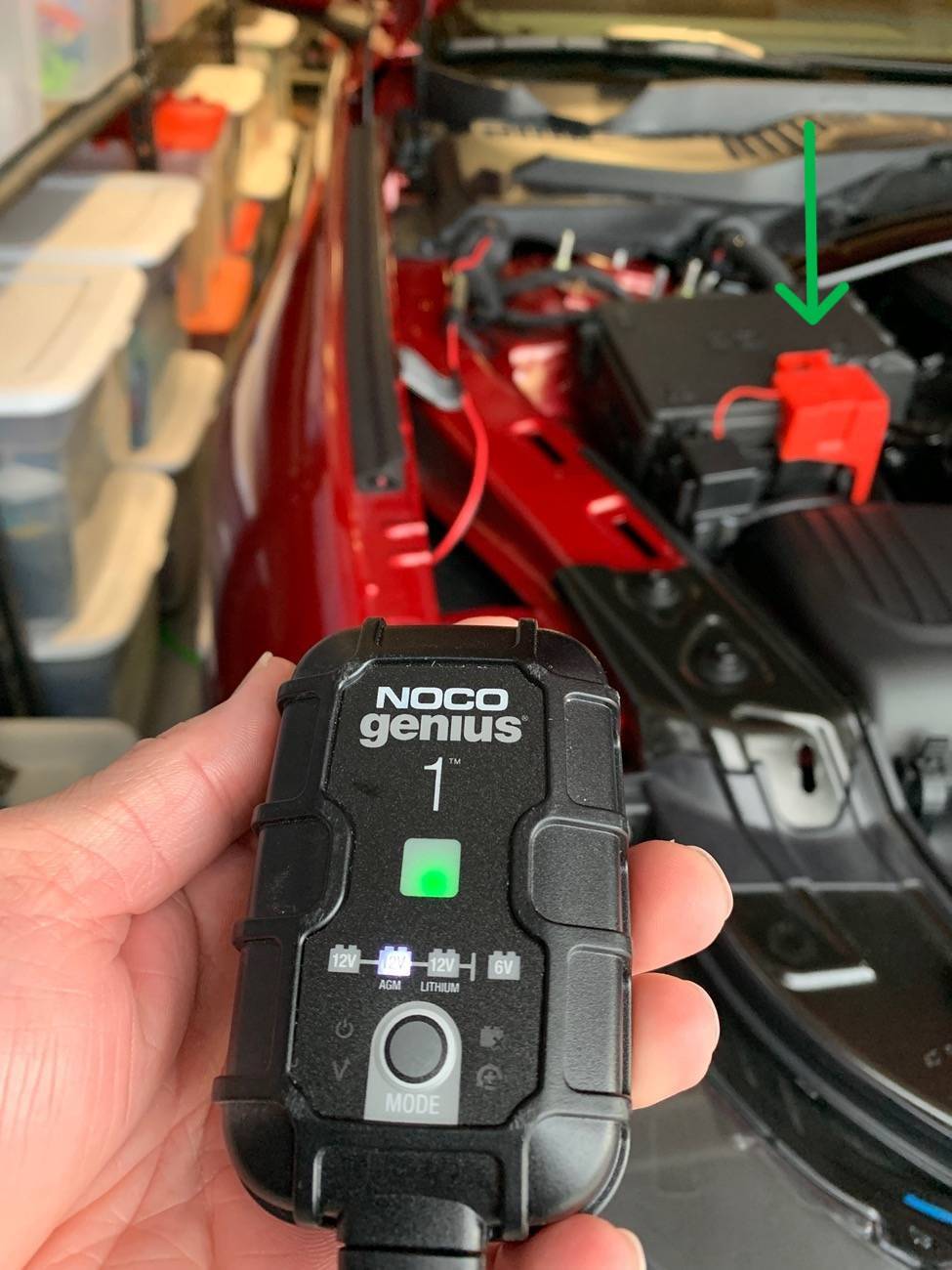

S650 Mustang My Car Would Not Start. Please Help IMG_0771

It appears you have the battery maintainer connected directly to the battery which is bypassing the battery management system. If so, I suggest relocating to this location (green arrow).
okay Thanks I will move them..
