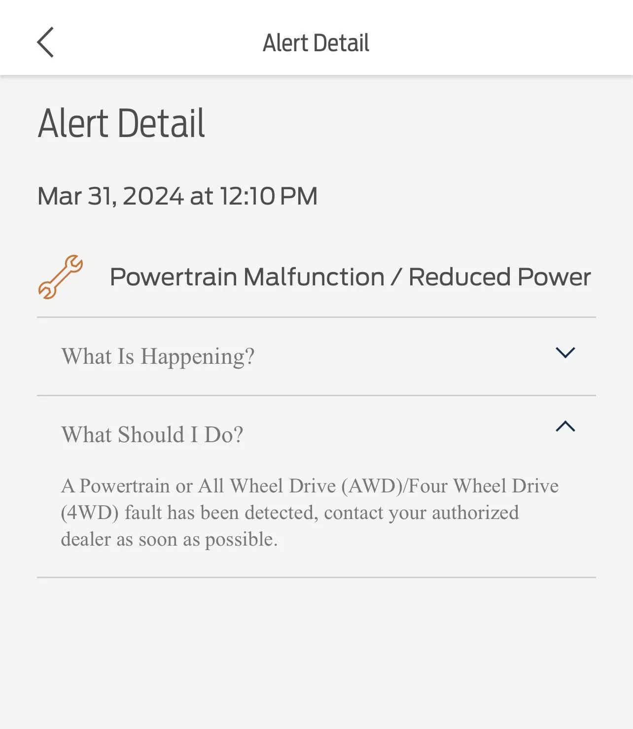

My 24 Mustang wouldn’t start. Dealer did oil change yesterday. Drove it home and drove it this morning and it wouldn’t start when I finished my errand. Lots of error codes popped up. Finally got it started. It stopped when I put it in gear. After sitting for a while got it to start and drove it to the dealership. Got this message on Ford Pass.
S650 Mustang 24 Mustang wouldn’t start.  Loads of error messages IMG_4206

I just updated my post. The voltage on the battery while driving to the dealer was between 13.5 - 14 volts. Read on a previous post that it might be the Gateway Control module. We’ll see what the dealer says

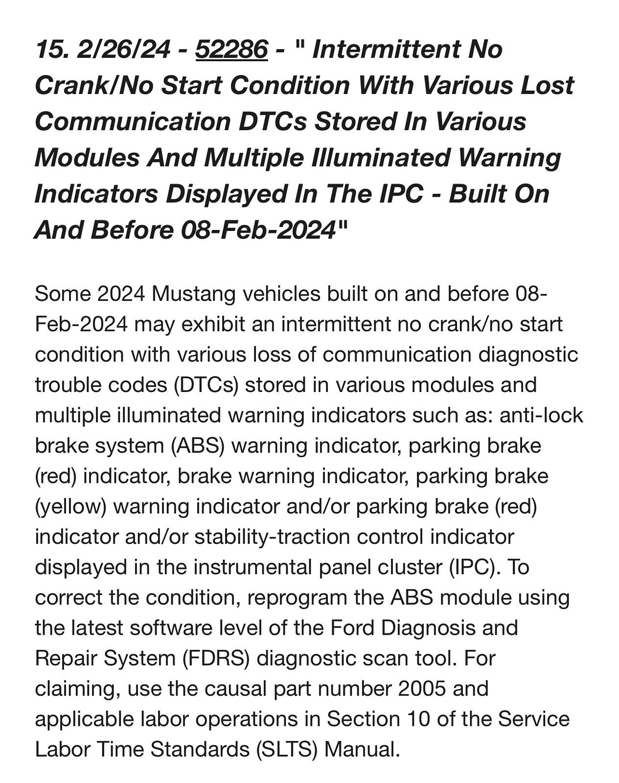

Maybe reprogramming ABS module will help
S650 Mustang 24 Mustang wouldn’t start.  Loads of error messages IMG_4211

Dealer reprogrammed ABS module and car started without issue and powertrain malfunction error message is now gone on Ford Pass
