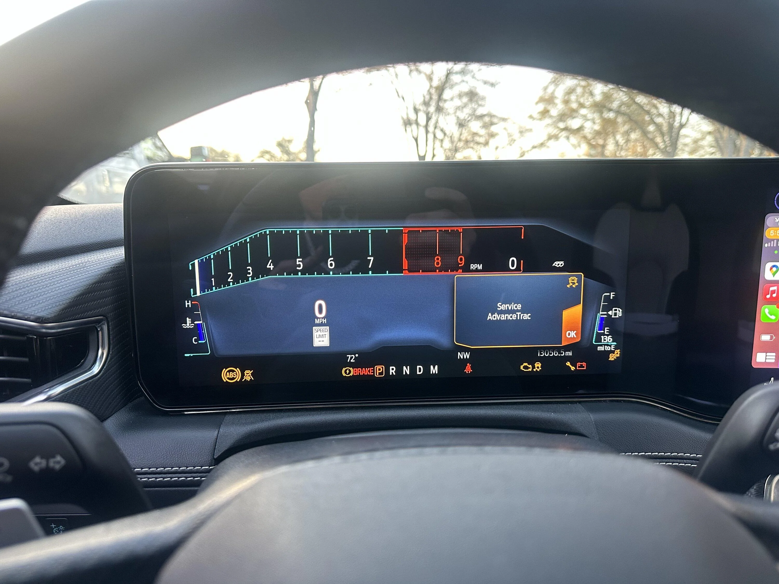

Just got back from hour drive, went to remote start and car wouldn’t start, got in car and every light is on dash ? Anyone else seen anything like this ? And won’t start,

I didn’t see anything besides dead battery’s on form, this was after a long drive. But put code scanner on and it said no codes, so unhooked the battery and hooked it back up and started right up. Just seeing if anyone else had this issue?
It probably was a failed update. It had not happened to me on my mustang yet. But my camry had this happen twice and I had to take it to let the dealership update it.

No just negative then let it sit for 5 minutes and everything if fine, but until I did that car was not drivable.
Forced reboot - not a fan. Hopefully a one off and not a recurring issue. Although on the brighter side the more recurrent the ‘easier’ the find. random ground is the name of the most elusive of gremlins.
