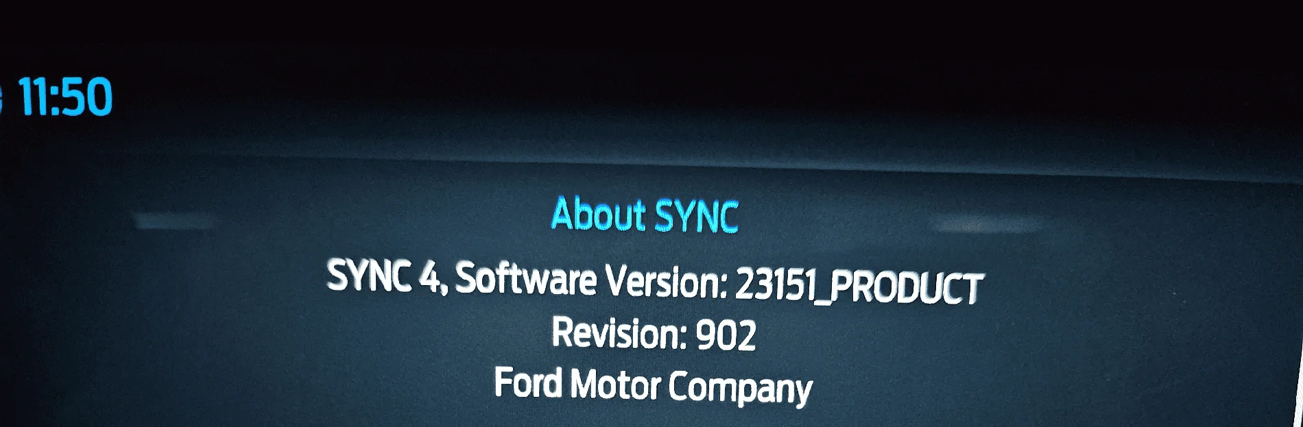

I understand how a bad update can cause problems...but i have not had any update since i bought my car in November!
I read that Ford was preparing an update for Q1 2024, to fix all kind of issues, but have not heard anything about it yet.
Have you guys received updates on your 2024 Mustang?

This is my software version
S650 Mustang 2024 dead ? 1000025823
