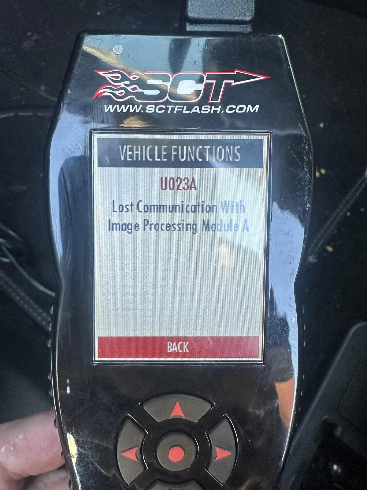

Just got back from hour drive, went to remote start and car wouldn’t start, got in car and every light is on dash ? Anyone else seen anything like this ? And won’t start,

After unhooking battery and putting back never did it again I did pull a code though,
Yeah, I had the same thing happen just once. Didn’t present any codes though. I let it sit for a couple of hours and it crunk right up. So it seems with this particular fault, either letting it sit for a little bit or disconnecting/ reconnecting the battery does the trick. I never took mine in for it as it only happened once to this date.

The check engine light wasn’t after resetting it. but it was in the system, dealer wouldn’t look at so I just scanned it, but it has been fine

No idea this isn’t a full scan tool when I clicked scan codes that was was in there,

Who (as in what system) is image processing module a?
It's part of the Adaptive Cruise Control system.
The ACC system functions much like a standard cruise control system. The ACC system automatically adjusts the vehicles speed to maintain a set distance gap from the front of the vehicle and the vehicle in the same path of travel. The ACC functionality uses a combination of radar data (CCM) and camera sensors data (IPMA) to verify system is working as intended. The required CCM (cruise control module) houses a radar system that sends information via a dedicated CAN network to the IPMA. The IPMA processes data from the CCM and serves as a gateway module for the CCM. The IPMA outputs this data via the HS2-CAN network to various modules on the vehicle.

My cruise control does randomly say cancelled, while using and some times lane keep won’t turn on the highway,

It it the camera or a sensor that is malfunctioning? Or a (good luck in finding) random short?
It does that when it can't see the markings on the roadway.
Can't diagnose root cause based solely on a DTC.
