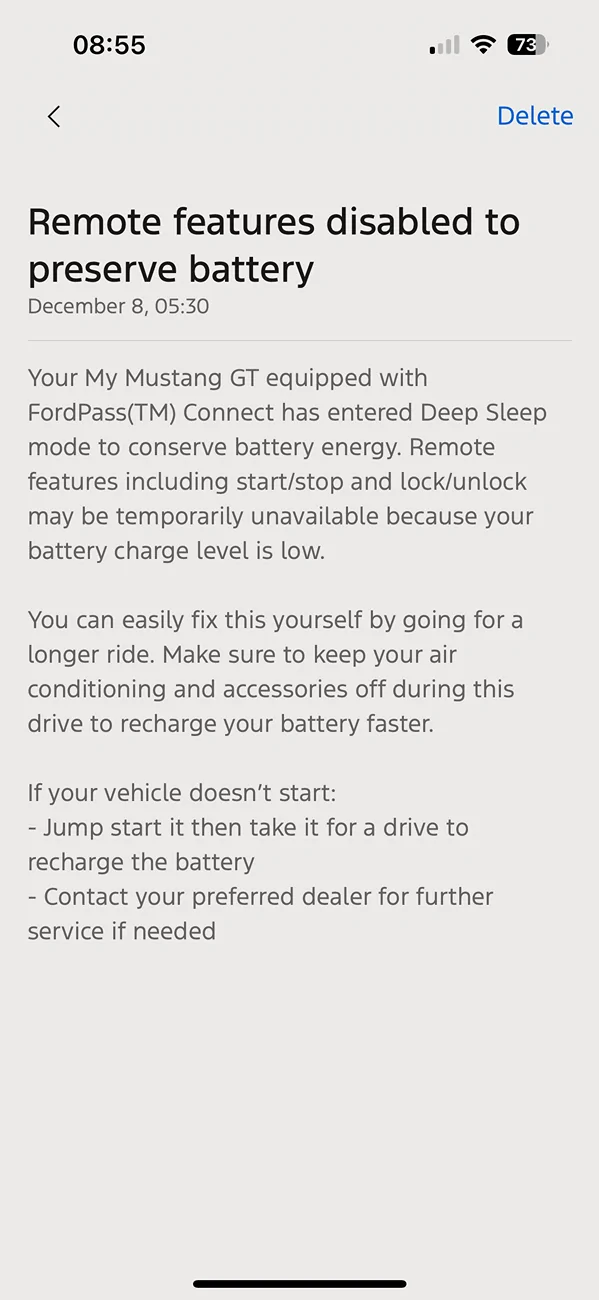

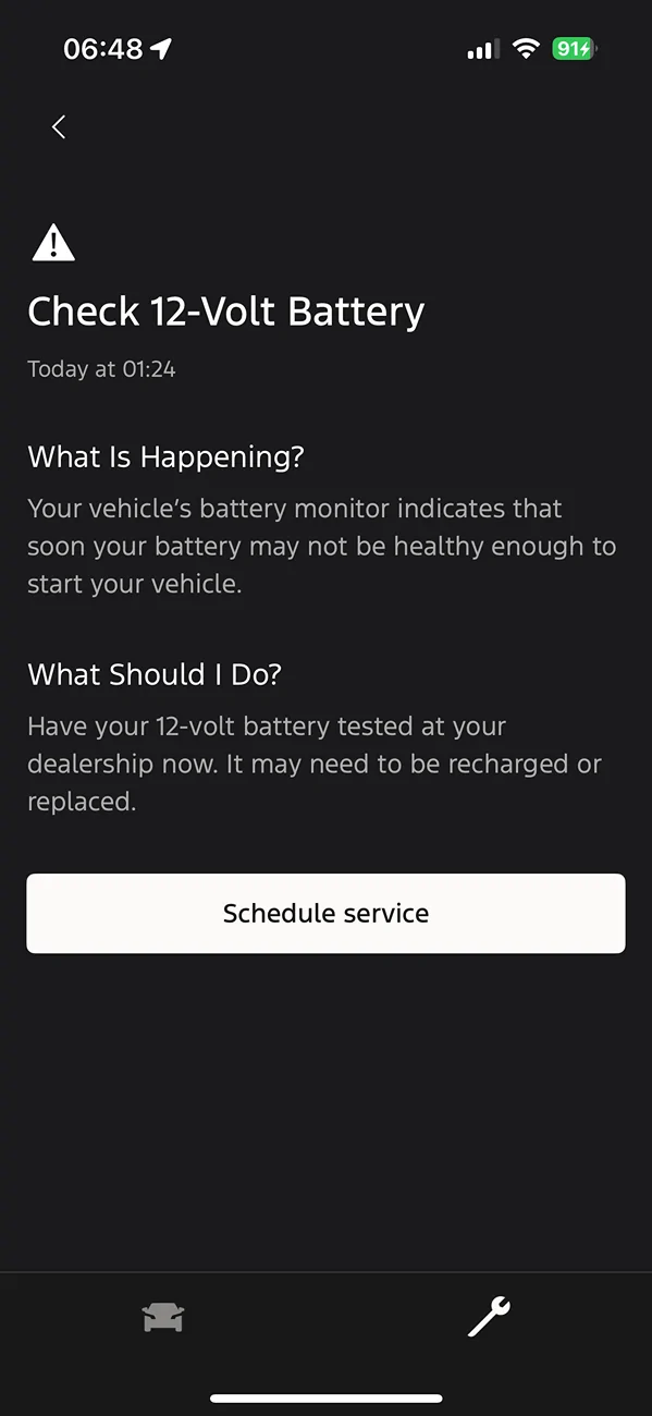

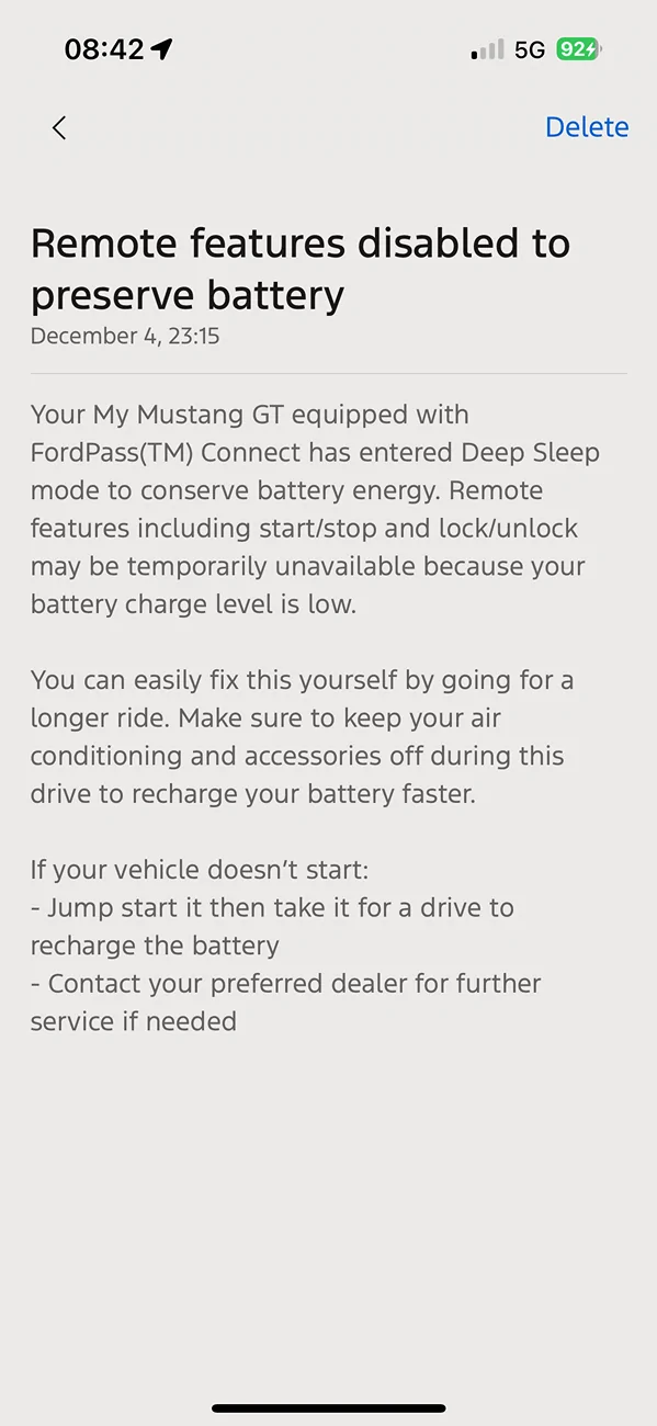

Ours is not a dark horse but an early ‘24
By chance did you get this alert in fordpass?
S650 Mustang Problems with Dark Horse going Dead IMG_6031
S650 Mustang Problems with Dark Horse going Dead IMG_6017
S650 Mustang Problems with Dark Horse going Dead IMG_5996
S650 Mustang Problems with Dark Horse going Dead IMG_5987
