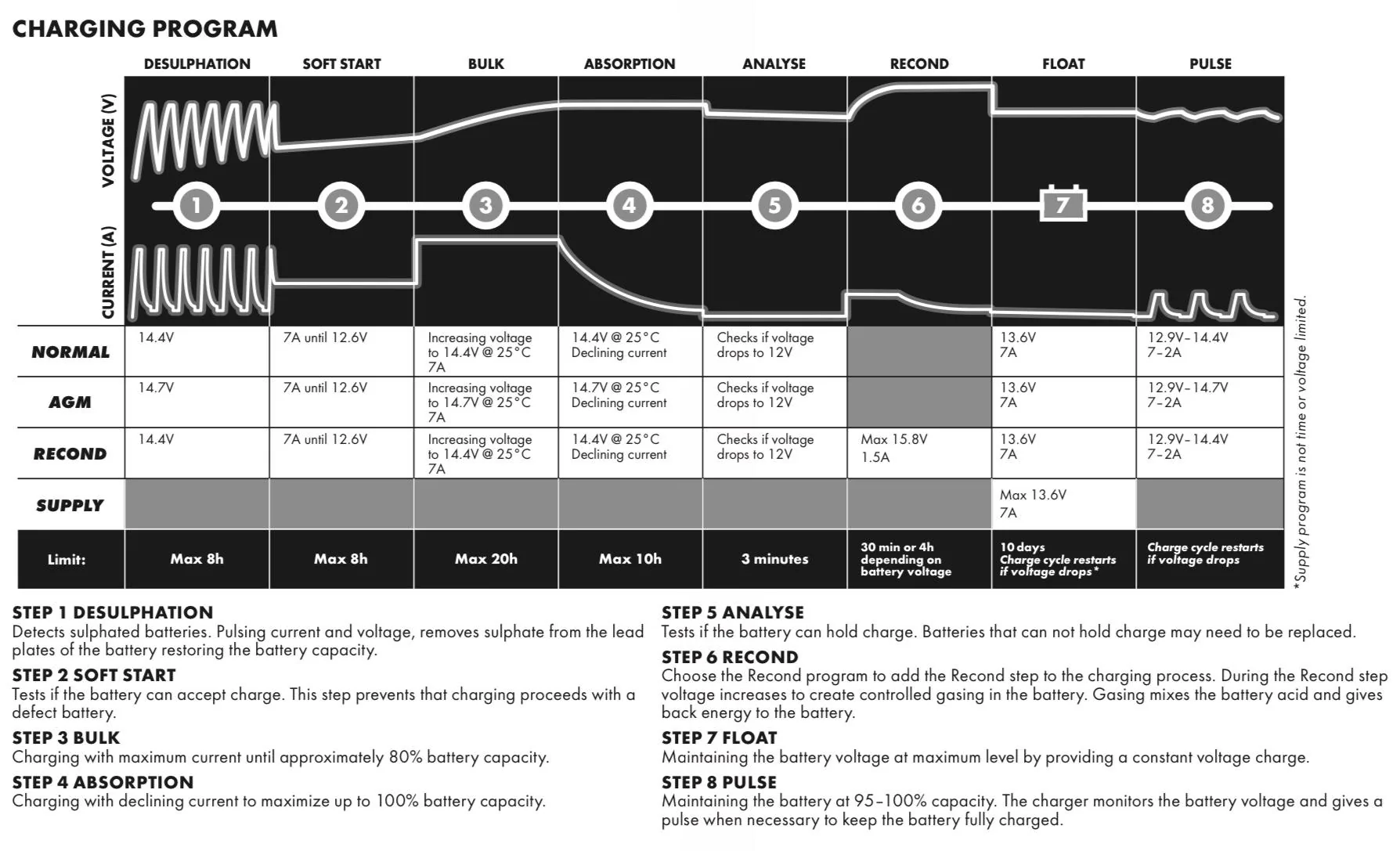

Had this happen on a different vehicle, I don't drive much, with a new battery. It was dead, jumped it, drove to charge it up, tested next day with MM, it had the cranking amps, though it was not holding a charge, sulfated.
Put it on a 5A trickle charger, ran it through a couple pulse cycles to desulfate, and a couple slow overnight charges. Battery is good as new now. If it's not going to be a daily driver or sit for winter a maintainer is a must for these newer cars. IMHO
1,769
2,780
≈39N
For those cars which are not a DD, wiring in a tender is a great and welcome first mod.
S650 Mustang Problems Already battery tender stages
