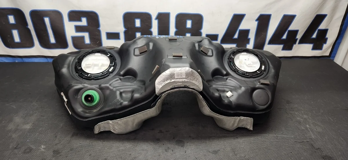

It is all one tank, but there is a big hump in the middle for the driveshaft.
The fuel pump has a small line that goes over to the other side and sucks fuel over the hump and onto the side with the fuel pump. Ford's OEM pump is not strong enough to suck fuel against centrifugal force when negotiating a long turn on track with sticky tires in the wrong direction. KPM's fuel pump cures this problem.
This is the S650 gas tank.
