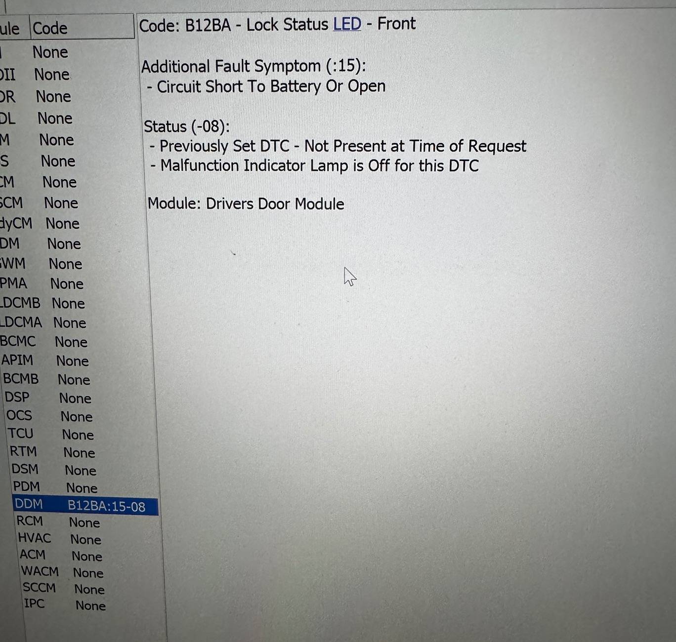

so I found this error when I was changing something in forscan I tried to reset the error then went to a drive and checked again and it was there anyone have a clue what is it ?

What I read is that the system found an error in the past but corrected itself.
Have you tried to clear the DTC and does it come back?
Yea I cleared it went for a ride and then i found it again

Anything not working?
- BLIS
- Turn signals in side mirrors
- Power mirrors in side mirrors
- Opening the windows with keyfob
- Puddle Lights
- Automatic folding side mirror function
These are the functions that your DDM controls.
Also very important, what is your battery voltage when car is off?
Check also your battery connection. It could be a loose connection.

Start with the battery.

Is your door open when running test? I had an similar code present itself when testing with the driver door opened. Just a thought

Yea it is open because its too hot in here 😄
I will test this tomorrow will clear the code and retest after driving for a while again then connect while the door is closed

I didn't even drive it, I shut the door, cleared it, disconnect/reconnect FORScan, gone! Hope it works for ya

I will try it before driving clear it reconnect while the door open
Then again while closed i hope that is the issue
