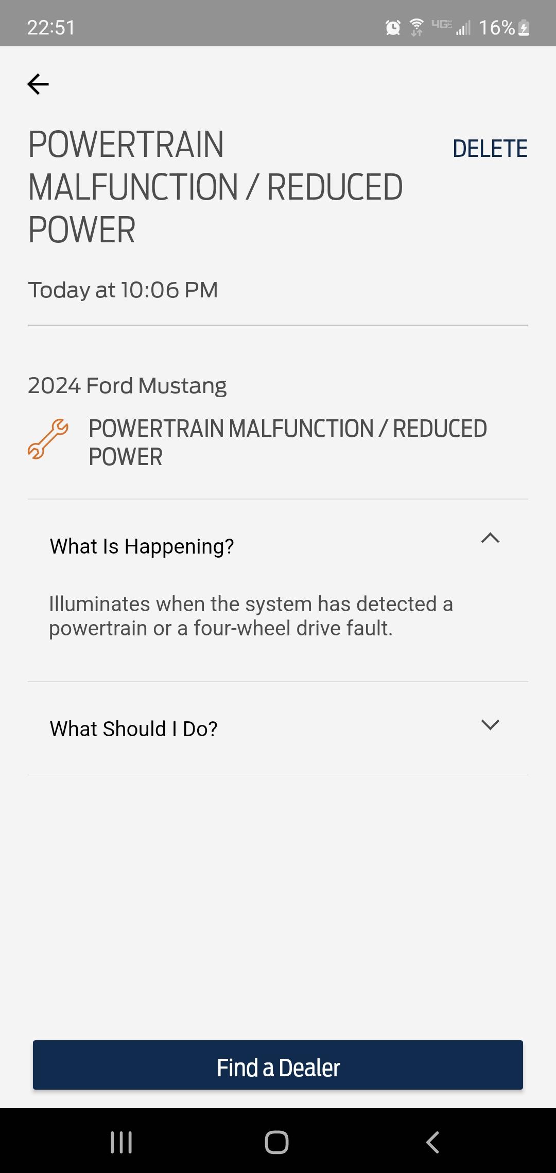

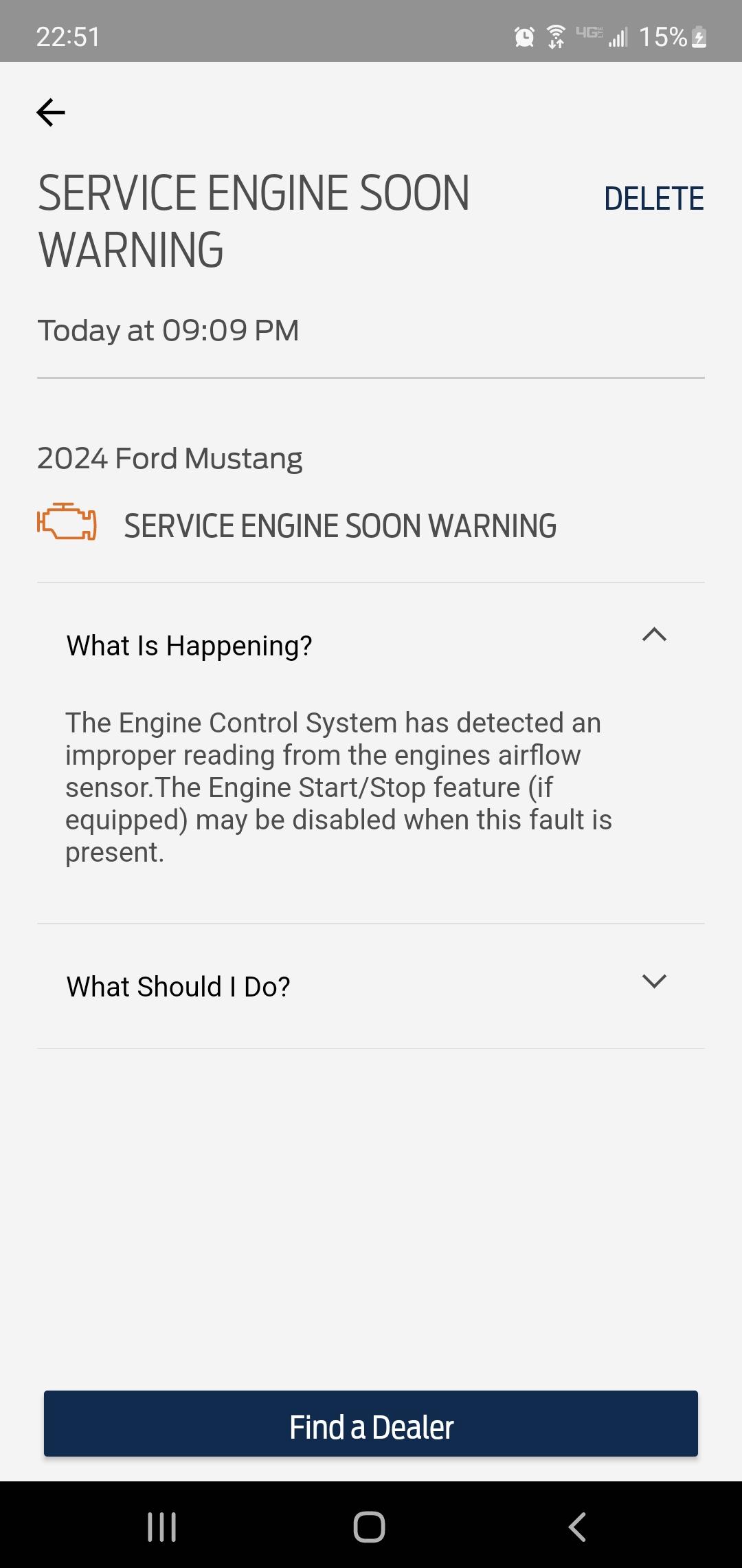

Ford app sent this
S650 Mustang general error 21000 Screenshot_20231004-225117_FordPass
S650 Mustang general error 21000 Screenshot_20231004-225156_FordPass

Dead give away then. Put the OEM filters back on, as the universal filters you have likely aren't sealing. . The noise makes me think this even more. You have both MAFs plugged in?

Lethal: the sit tightly around the seal and the metal clamp I have tight too, both sensors plugged in, unplugged inspected and back in
Zig: correct the boxes have a slight bend on the fenders side. No, the lids were not on, didn't think it was important if they were but maybe that's wrong?
Anger: correct
As of now the service wrench went away and I cleared the general code. Drove it on side streets for 20 min from 10 to 60 mph little hard pulling nothing crazy and no pop up signals yet. I'll double check seal and keep it how it is see if it happens again.

You went from breathing through a corrugated straw to a wide open pipe. It’s gonna freak until she gets (if she can with the stock tune) used to it.
usually she will either throw a code right away or by 50-100 miles. Different sequence of tests are completed at different mileage (engine hours) or cycles. Basically if you get past 100 miles no light chances are the mod is fine. Fine being relative.
