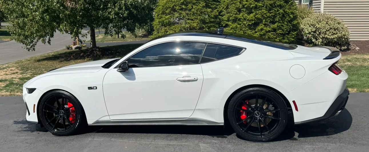

Velgen VF5 with Nitto NT555 tires: 275/35/20 front (20x10), 305/30/20 rear (20x11).
The rear tires stick out ever so slightly. Does it get stuff on the rear panel? Sure does. Do I regret doing this? Not for a second.
The 305/30/20 are essentially identical to the stock tire size, so speedometer isn't an issue at all. If you go with 35's you will be off a 3-4 MPH at 65 MPH (and off more at higher speeds) unless you get the computer updated.
