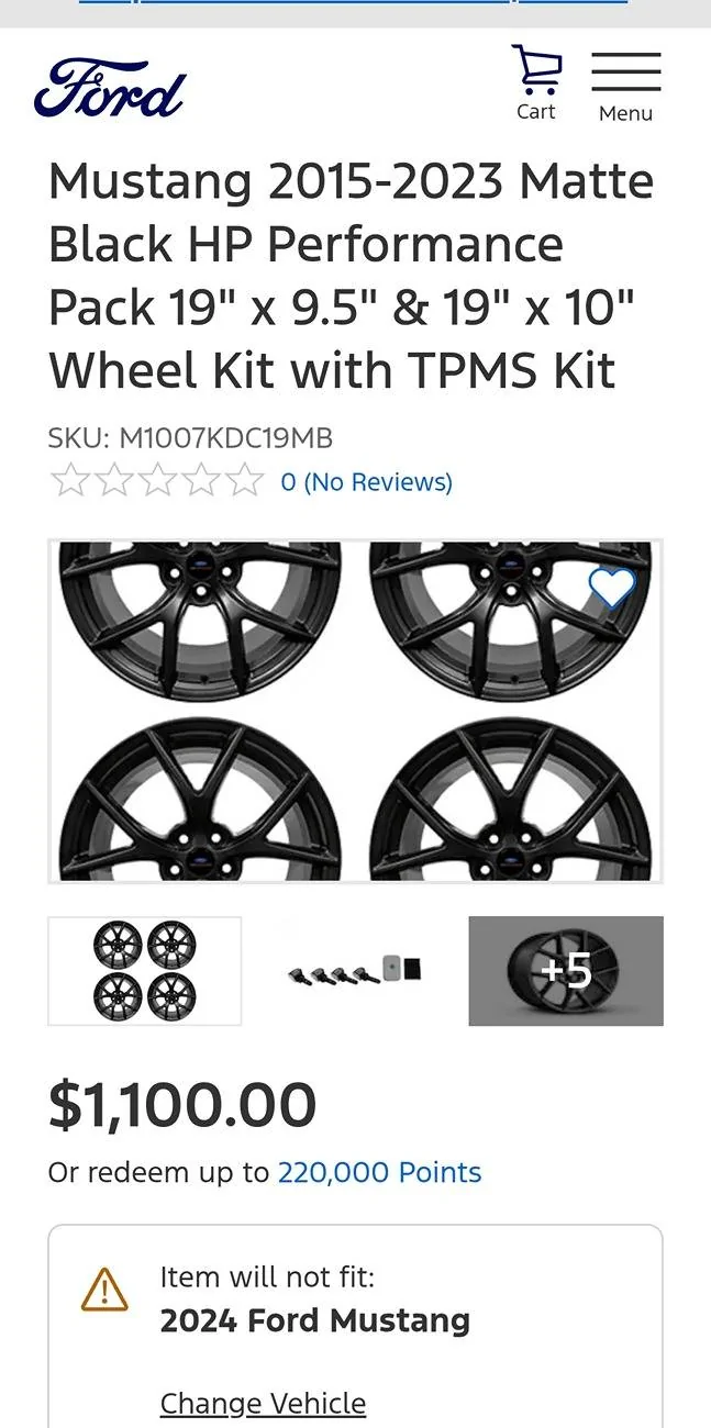

Not sure which wheels you are looking for, but I would just compare it with the OEM specs to make sure you don't end up having inner clearance issues.
These are what I'm considering. Says they will not fit but everything I've been told is that's because the TPMS is different which I'm going to replace anyway. Offset is exactly the same as the OEM performance pack wheels but each wheel is 1/2" wider on the ones here.
