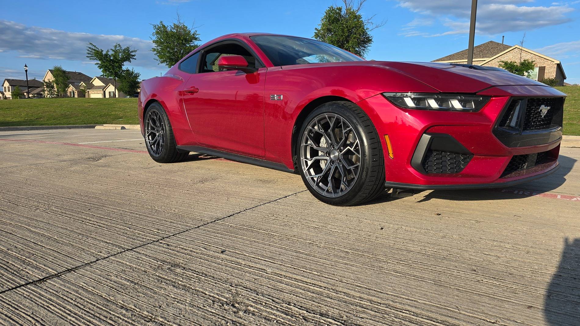

I'm running Conti ExtremeContact Sport02
275/35R20 on 20X10
305/35R20 on 20x11
The rears are taller than my stock 255/40R19s, but I love the look and the ride perfect.
kinelisch
Jun 20, 2024
509
469
275/35R20 on 20X10
305/35R20 on 20x11
Got more pictures of your tires and Mustang?

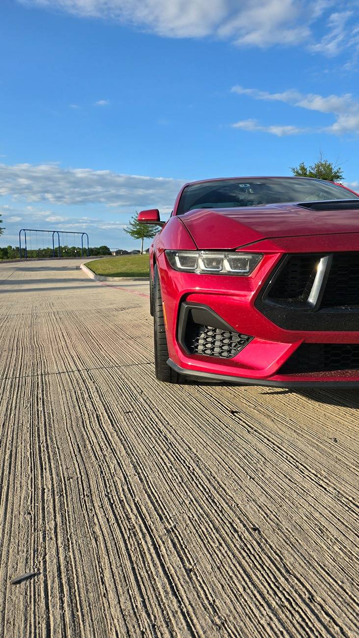

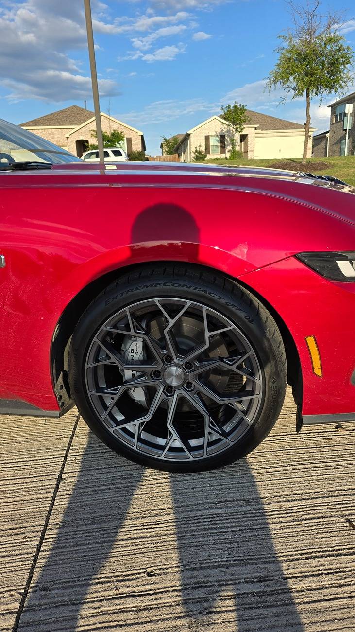

I did 285/35r20 extreme contact sport 02s on 20x10s all the way around. Fits great
S650 Mustang Tire size "help" 1000007555
I would love to have done staggered but couldn't justify the cost.

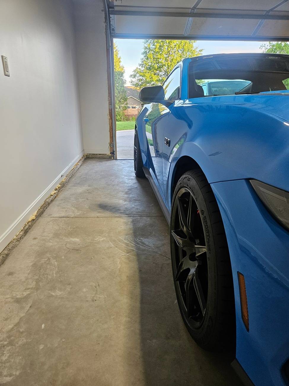

Ken H.
Feb 15, 2025
272
311
Wyoming, DE
2024 Dark Horse Grabber Blue, 2025 Z06 Rapid Blue, 1963.5 Ford Galaxie 500 XL
285/35/20 20x10
305/35/30 20x11
No rub
