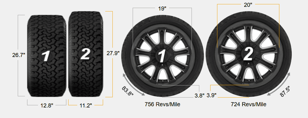

i run 325/30R19 front and only rub a small outer edge bit of my tire on the front of the fender liner when at steering lock. you might be alright? but i cant say for sure
S650 Mustang 20x10 Tire Size Help 1706190929875

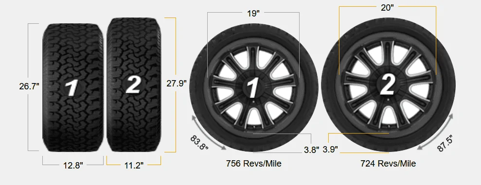

Check the diameter... I think the 285/35 will be a bit taller than the rear 305/30... I think I would go 285/30... should be less clearance issues with lowered car.

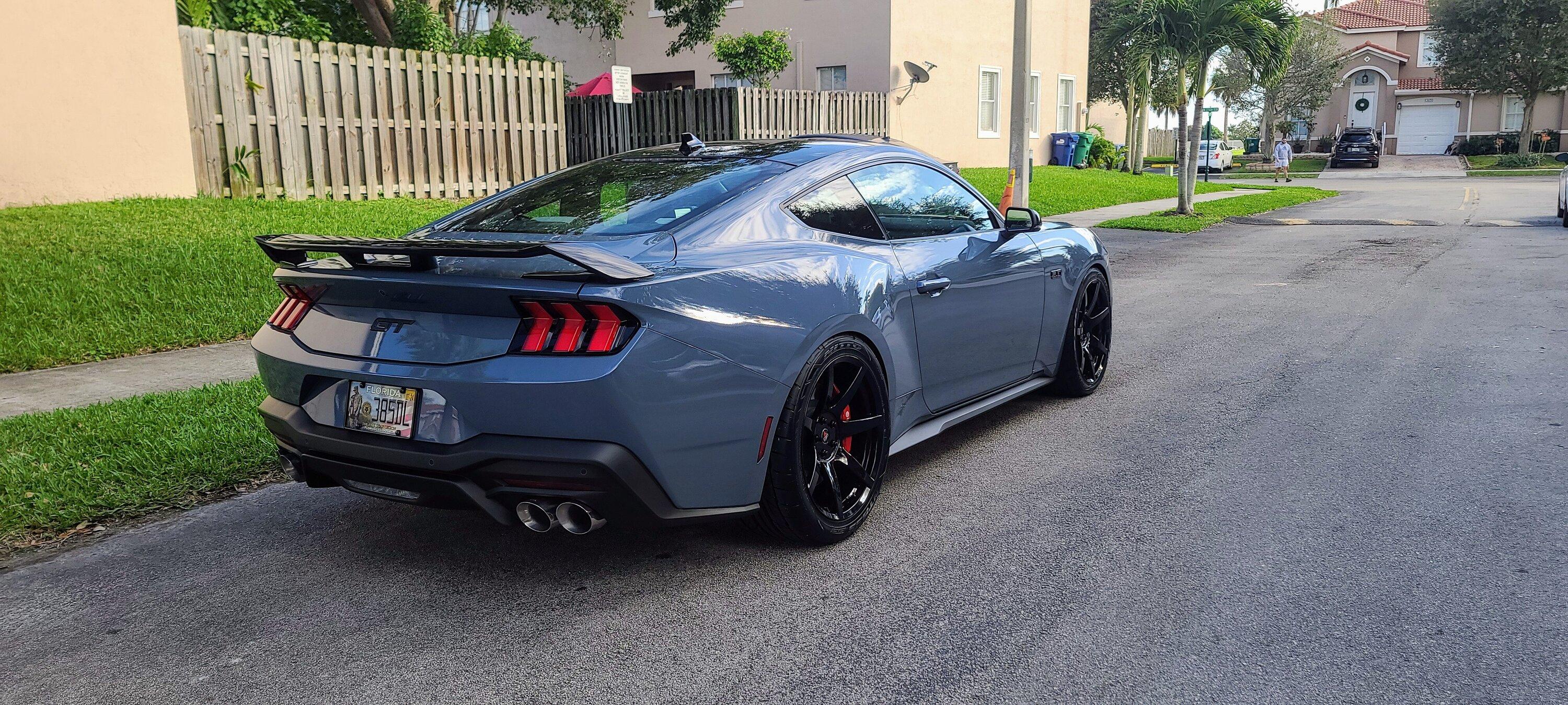

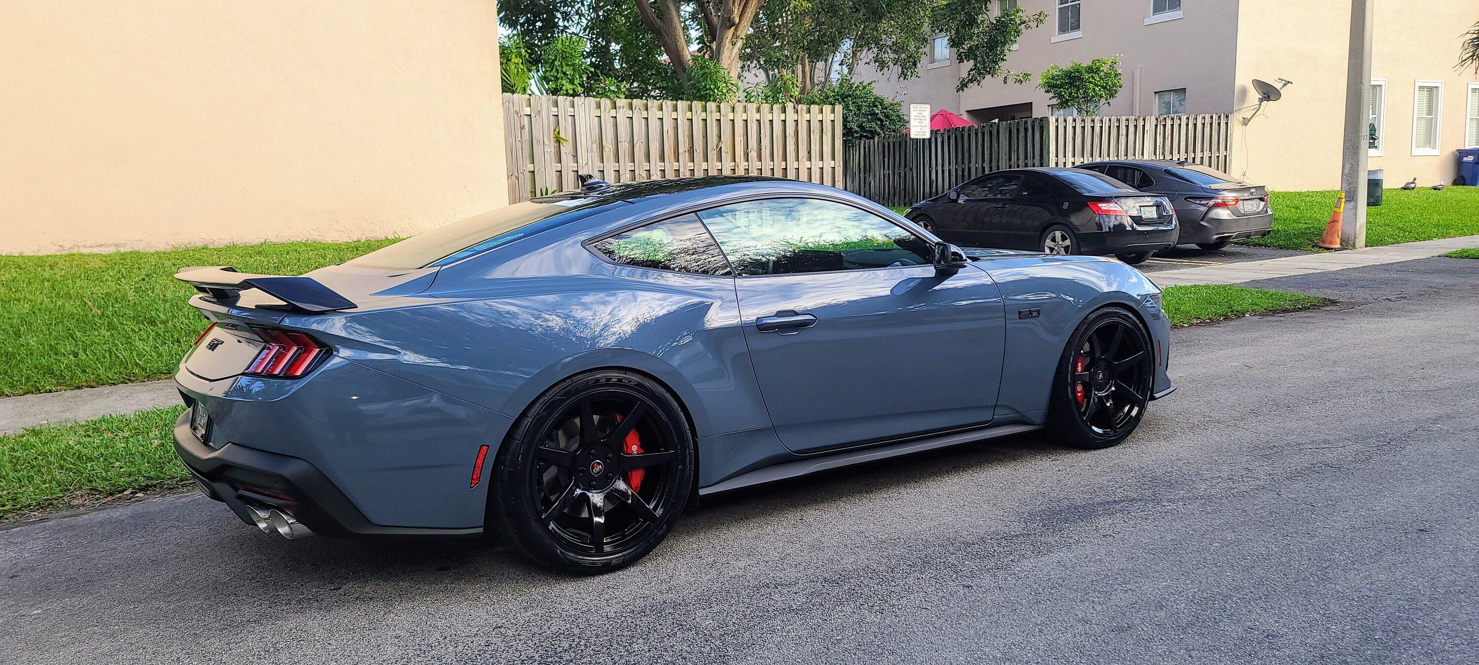

Hey Carter, here is a example of one of our clients that has the same steeda springs. We did the same 20x10 20x11 wheel setup. For tires they are 285/35/20, 305/35/20. We like doing the 35 side wall all around so the car is level. Customer states no rubbing. It is a common setup we do all the time, you shouldn't have any issues. Getting a alignment after the wheels are installed is a good idea.
S650 Mustang 20x10 Tire Size Help 20240120_160012
S650 Mustang 20x10 Tire Size Help 20240120_160020
