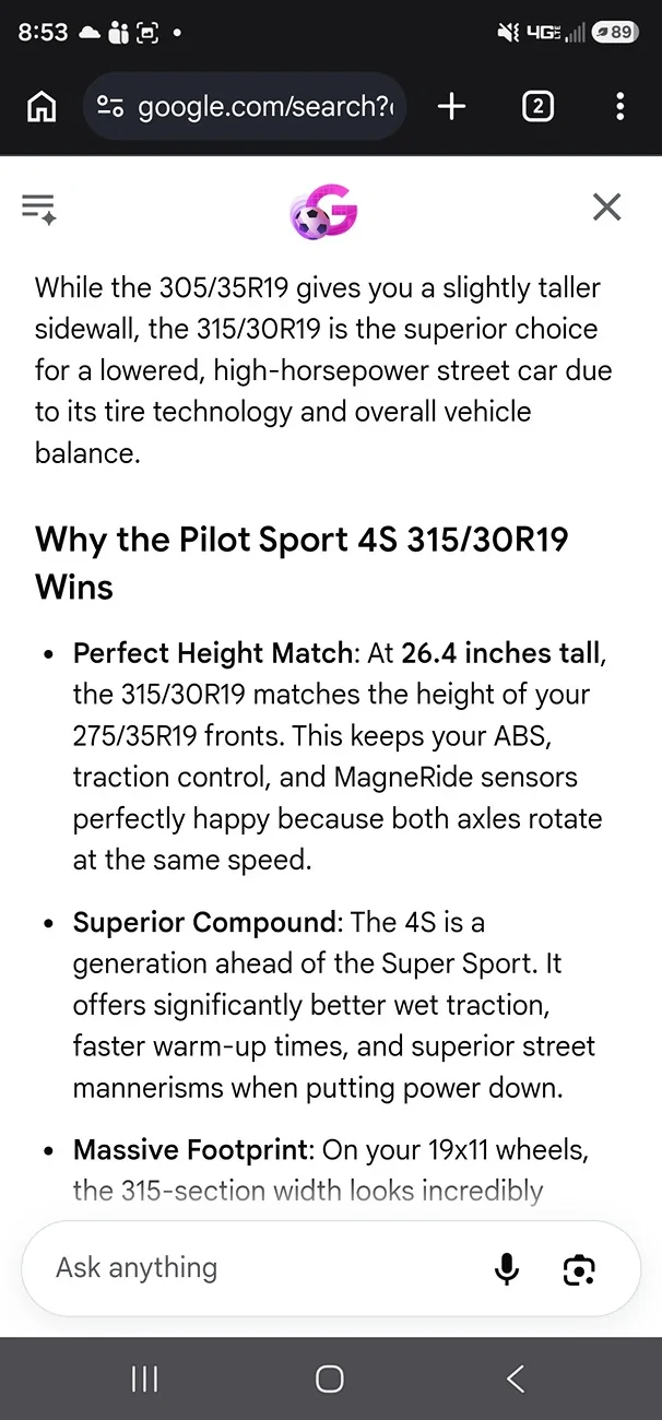

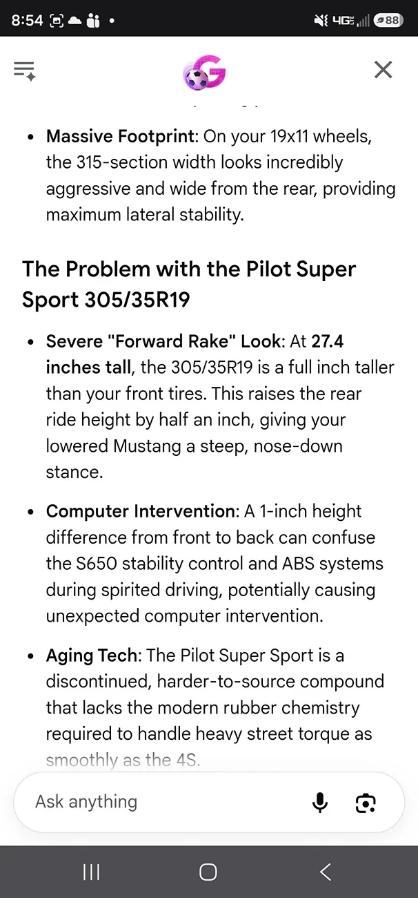

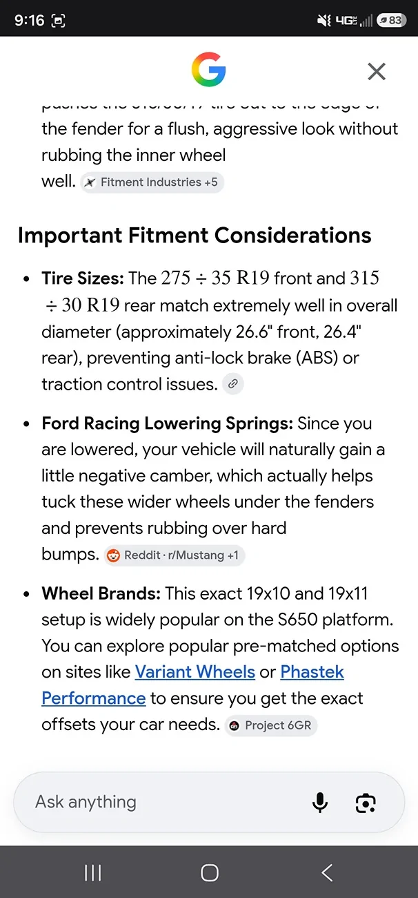

So they dont make the 4s in a 305/35R19. Discount instead ordered that size in the Super Sport instead. My 275/35R19 on the front are brand new. So it looks like 315/30R19 in the 4s is the better choice considering the 4s is the superior tire from everything ive read. They are ordering them for me and keeping the Super sport on hand in case they dont look right or rub. Here is what I get from AI. But I will also say answers vary each time lol.
