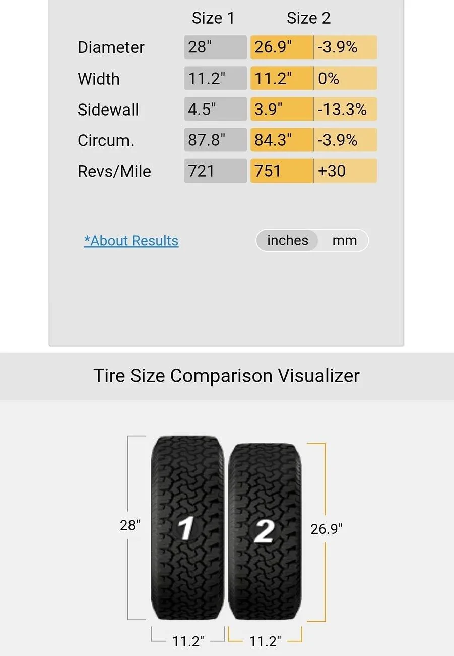

So, I'm finally getting around to upgrading my OEM wheels. I've decided to get gloss silver Velgen VF5 for my vapor blue Mustang GT. I'm undecided as to what tire size I should go with. I'm getting 19x10 square setup. The car isn't lowered and I have no plans to lower it. I was thinking about getting 275/40/19's but now I'm wondering if I should go with 285/40/19's. I don't want to go with 35 ratio because I'll be concerned out the gap between the top of the tire and fender and I don't want to go with 20" wheels as I don't want to have to recalibrate the speedometer and plus the ride is better on 19's. So, do any of you guys have a similar setup (19x10 w/ 285/40/19)? If I decide to go with 285's should I be worried about any fitment issues like rubbing? Help me decide... Thanks in advance for your input!

285/40-19 is a bit tall for the front at 28"

There are many variables to tire fitment. I was just giving you info on Ford factory sizing. You can check the diameter of you current tires to the new ones to see what wheel well gap you will have. Wheel offset also influence the overall look, ie how far the tire sits out. As far as speedo is concerned, it's a function of overall diameter. You need to compare your current diameter and compare to new size. If different it will change speedo, but maybe not by much. Ex 255x40-19 to 285x40-19 is almost an 1 in taller. Maybe 2-3 mph off. Not sure what your current tire size is.

Not if you go with 35 ratio. Diameter close to stock rear tires on DH. 305/35-19 27.40in, 275/40-19 27.66 in (stock rear DH non HP).

Wheel size has nothing to do with needing to recalibrate a speedo. Overall tire diameter is the key here.
You can make any combo of tire and wheel you want as long as the overall tire diameter is the same(or close) to stock. Don’t want the gap but want some meat on the road; go 20”.
I lnow car has more features then i have used, but where can speedo be calibrated thru dash ???
That .3 inches. every inch counts

0.26 in and currently within 1 mph, not going to try FORSCAN to fix. But then i'm not sure how accurate it was to start with. Just happy to find 305s that fit my 10in rims and simliar diameter.
