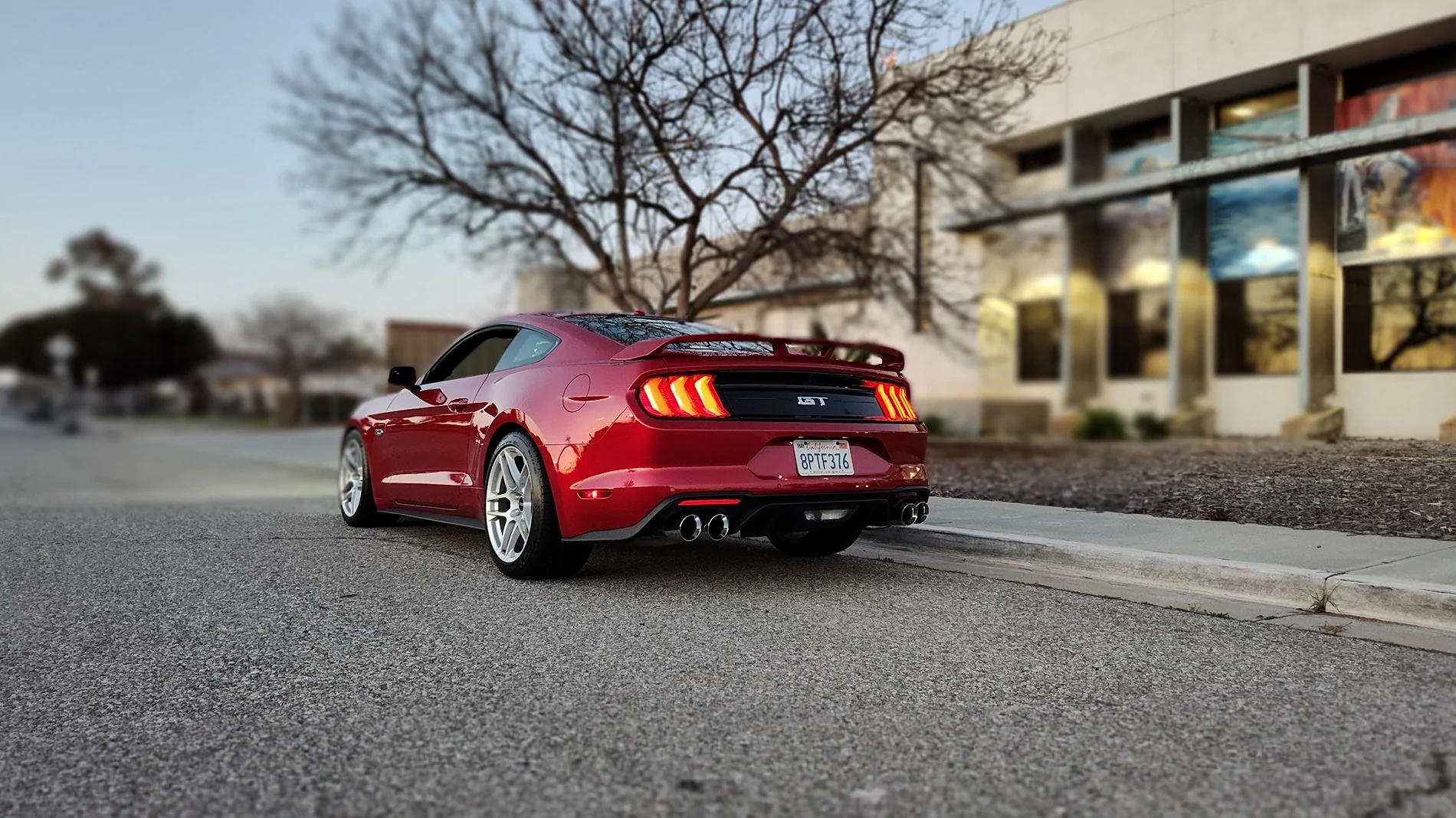

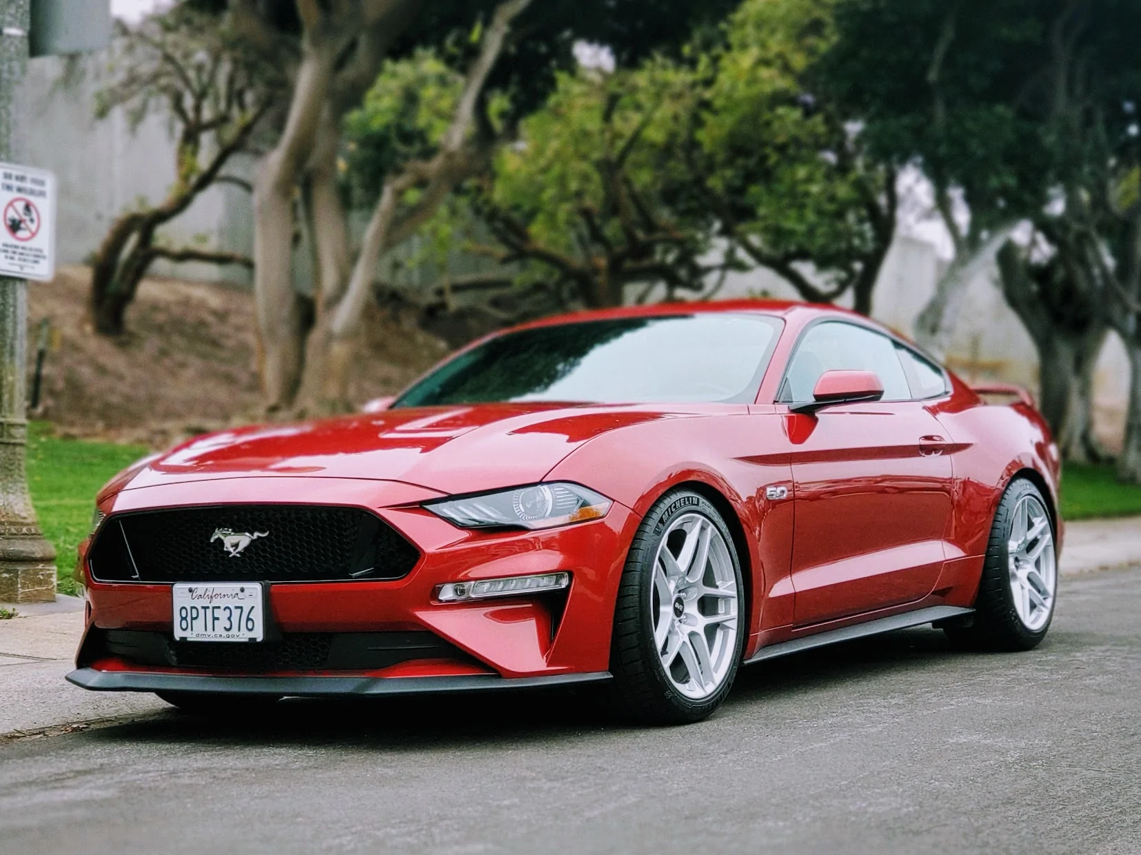

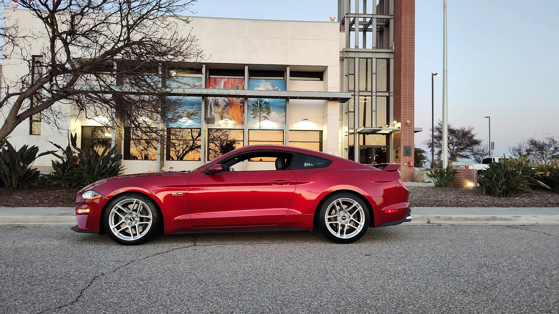

If you are running 19" wheels I like the 35 series tire best. I ran a 305/35/19 on SVE X500 wheels 19X10 front and 19X11 rear. On the front I ran a 285/35/19...here is a couple of pics. I don't have this car anymore...moved on to a G87 M2.

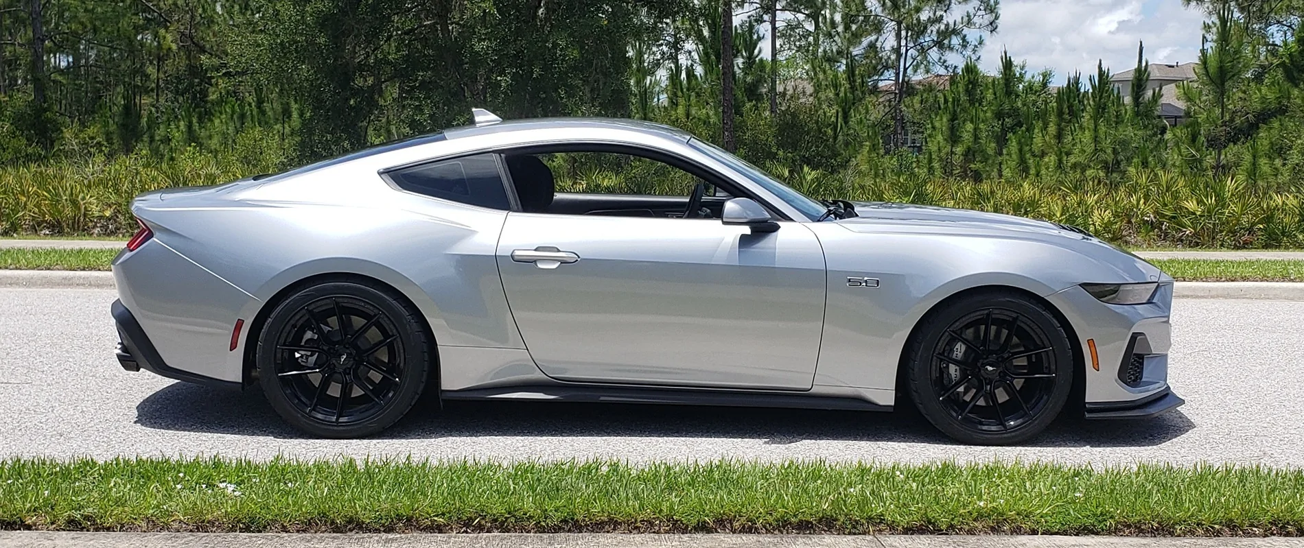

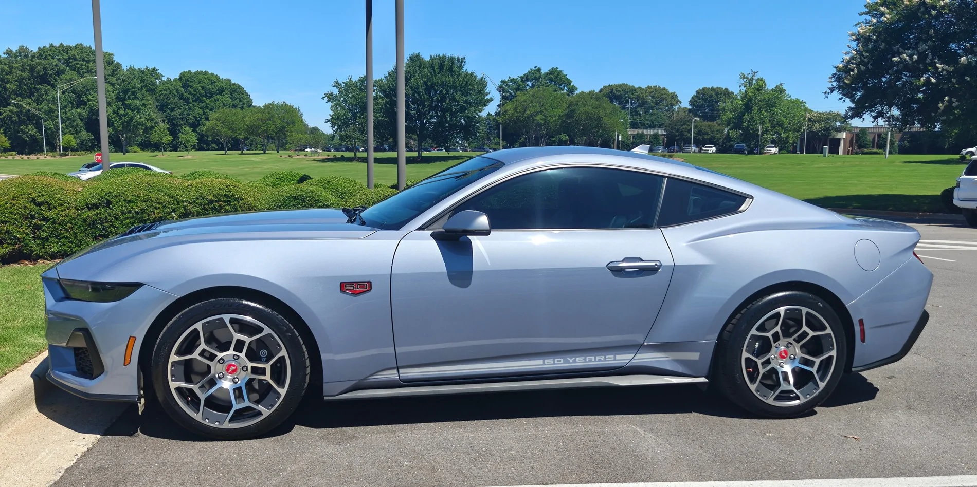

I'm running the same size wheels and tires, Continental ECS2.
