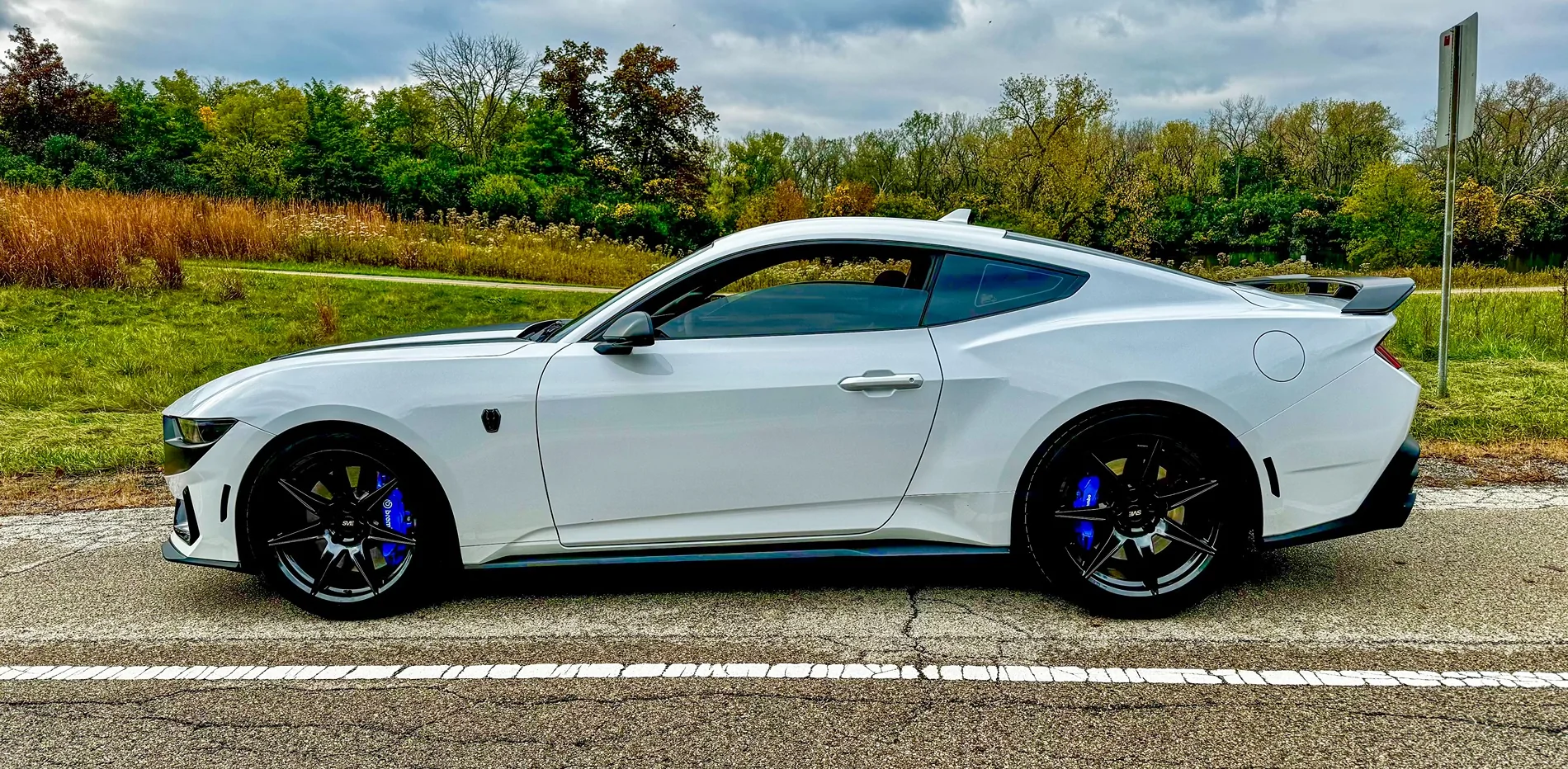

You can fit larger wheels and tires more comfortably in the rear than the front.
My Dark Horse handling package came staggered, 10.5/11 and 305/315. I think the standard Dark Horse and the GT Performance Package are staggered, as well.
I will probably remain staggered for my street tires, but go square for track (HPDE days only) - 11" all around with the same size tire, mainly in the hope of getting a little more tire life by rotating tires. Thankfully I have a lot of other track Mustangs to compare wheel, tire, offset, and camber, to learn from others on what works and what does not.
