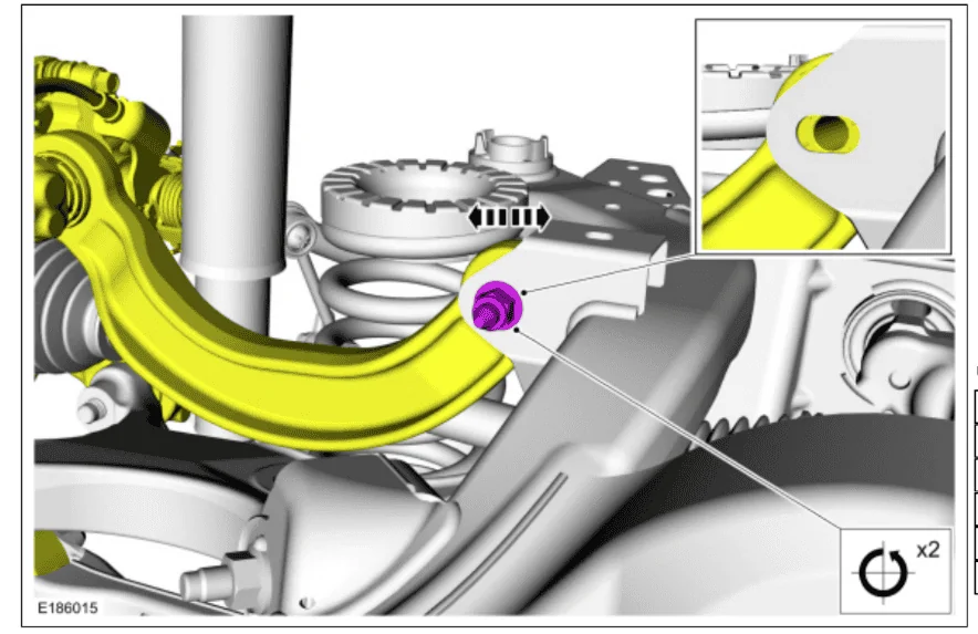

Out of curiosity, where did you get that image? Is it some sort of shop manual? It makes adjusting the rear camber look absurdly easy.

The image is from a Ford Shop Manual I found online. It's what I used to adjust my car.
It looks easy but it's time consuming. It might take some effort to move the suspension out after the nut is loose, once it is, the suspension moves freely.
After each adjustment you have to reinstall the tire, lower the car, drive it around the corner and back then repeat until you get the negative camber you're looking for.
There is a lot of adjusting and this can take a few times to get it right.
You may be able to adjust with the tire on but it you don't have as much room to work with especially on the driver side.
Use a floor jack under the rotor to help adjust in small increments
The driver's side is the tough one to get access to the nut and bolt but if have a little patient it's not too bad.
Check the toe after you make the adjustments. Mine wasn't affected much.
