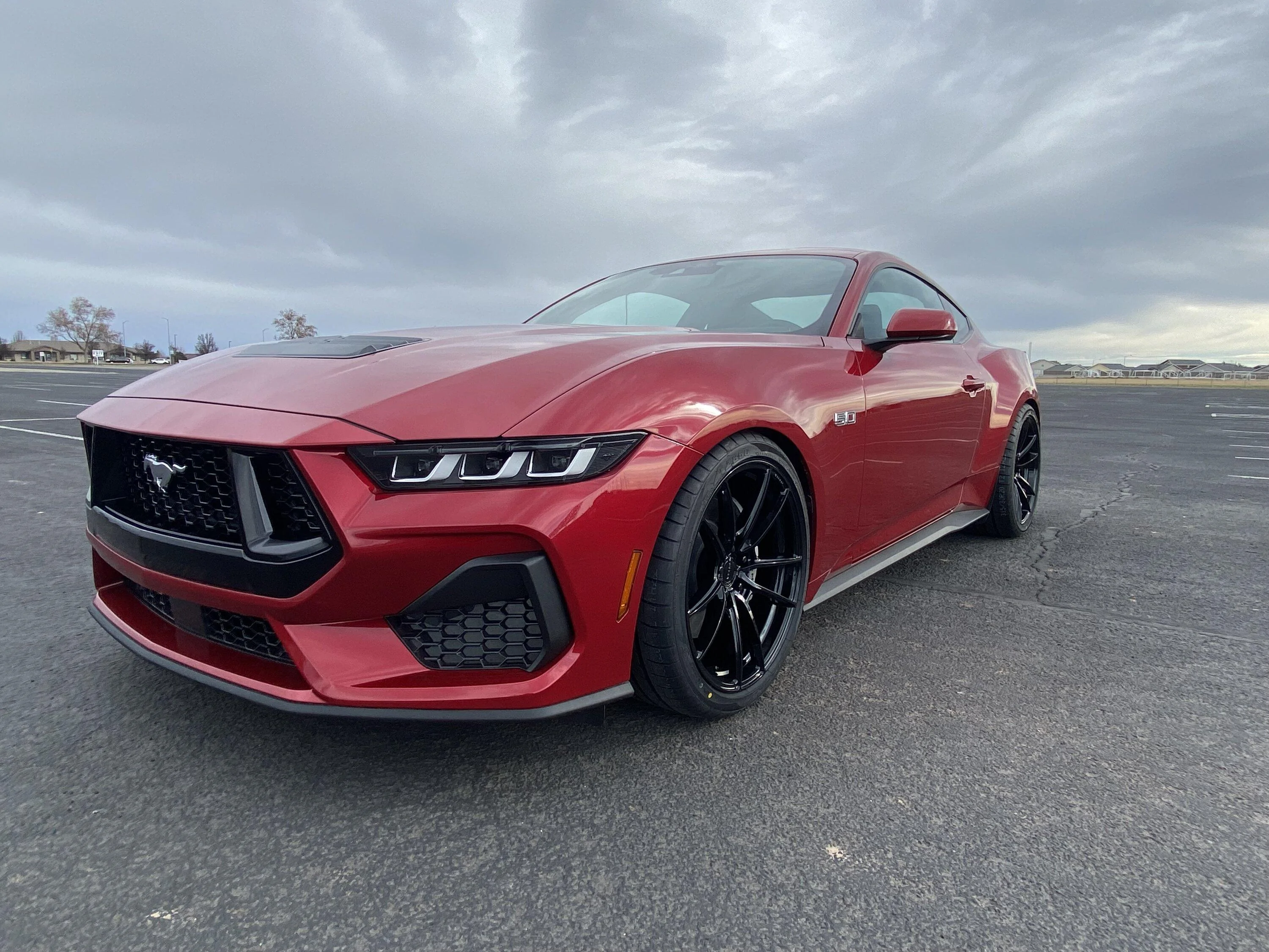

Hi guys, I installed a 20 inch rim on my car My spec is 20 x 11 315/30/20 back tires and I noticed that I’m little bit aggressive on a negative side and when I did an alignment I am 2° negative, I know I’m within the spec since I lowered the car should I run at least 1° or .05 any suggestion I’m not taking this car for a track day.. only cruising and dinner date and some long scenic Drive or should I go all the way to 0° rear camber

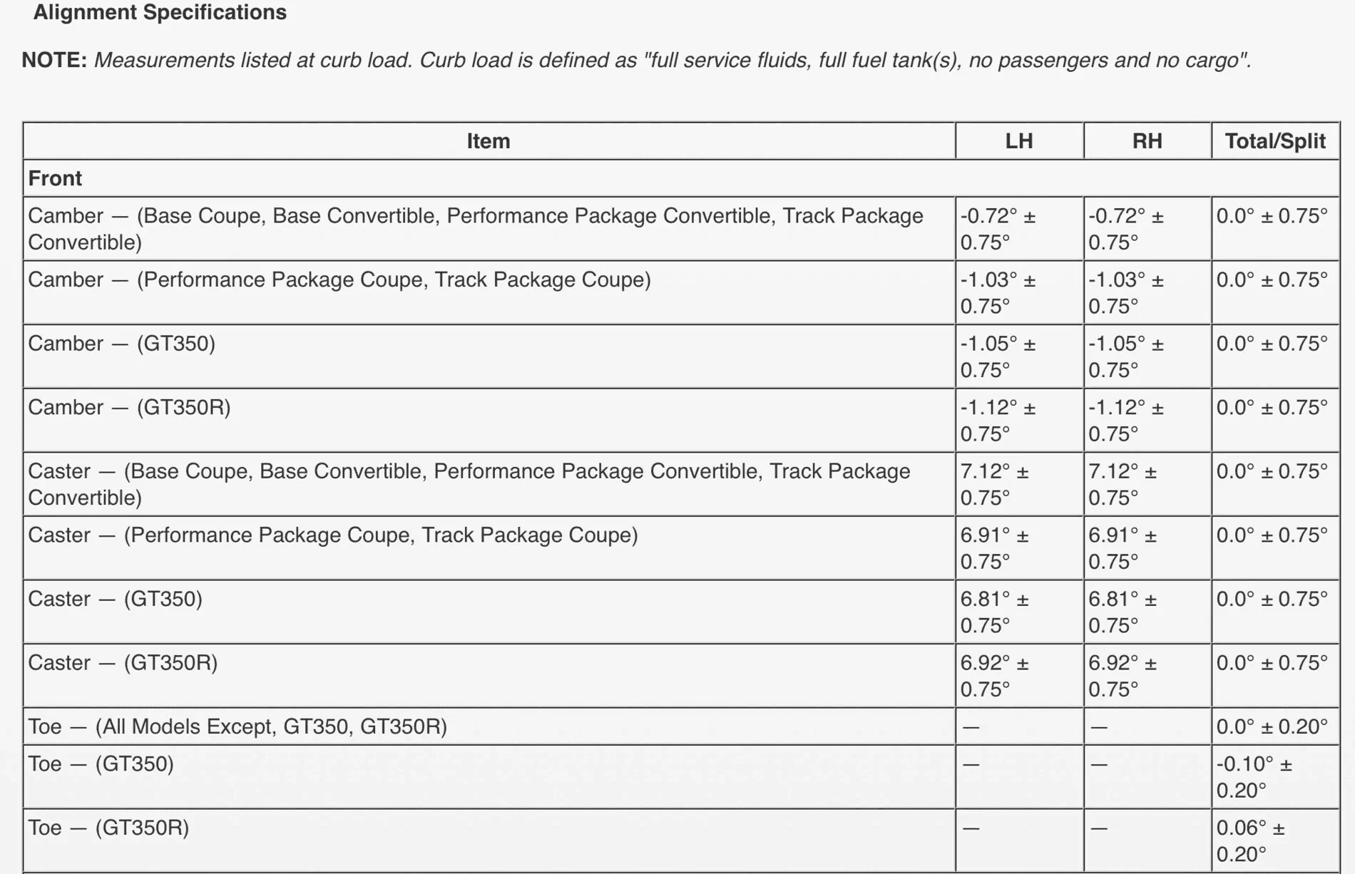

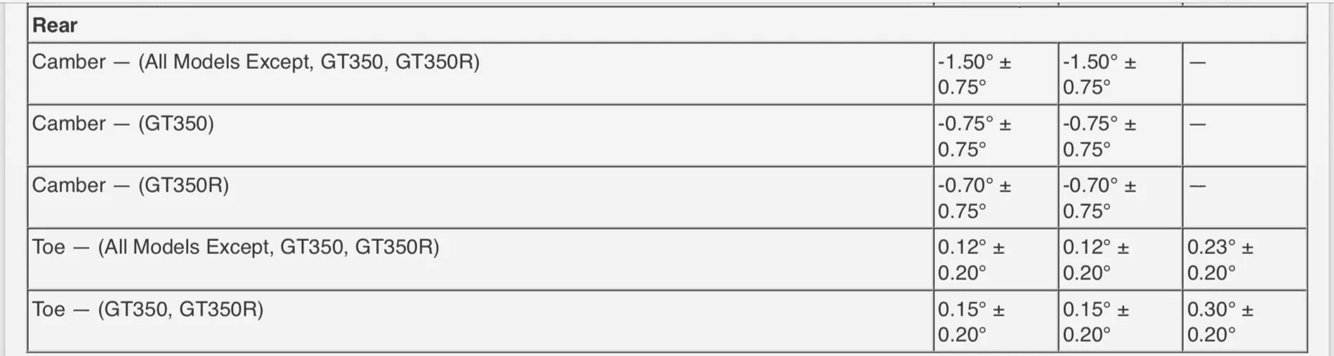

-2 degrees is fine. Maybe a little aggressive but if you're lowered on stock suspension w/o camber plates, there's not much you're gonna be able to adjust.
You're still well within factory spec which is -1.5 +/- 0.75. So -2.25 would be the max
Whatever you decide though, don't go with 0 degrees, that's dumb. you need some negative angle

I run -2 and it's fine for both daily and track duty.

Agree -2 will be fine. I ran -3 in my former track car and had a lot of aggressive components...:sunglasses:
