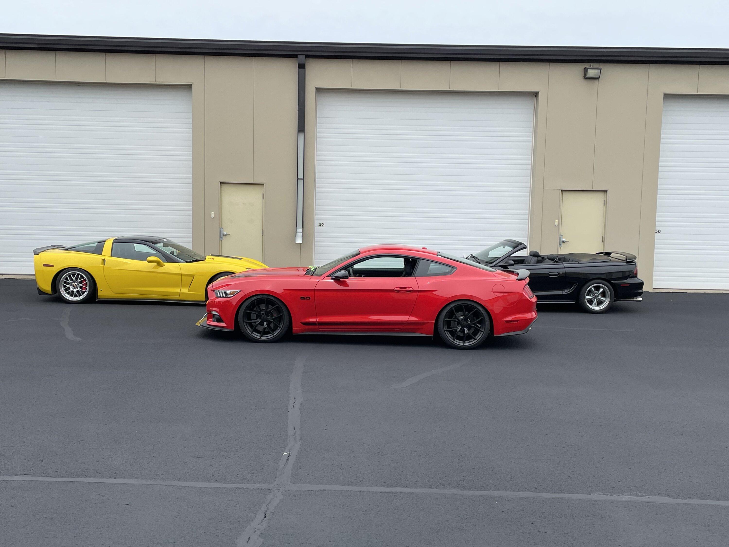

I think I can deal with that lol, 20k miles for a few hundred dollar repair, not bad. Do you have a picture of your s550? Did you do spacers? What size wheels?
No spacers. I don’t like spacers, I prefer wheels that have correct offset.
S650 Mustang Camber Plates/Camber Bolts IMG_4702
timd38
Dec 25, 2015
990
379
Hudson WI
Are those 20" Wheels, what brand?
Yes, Bought them LMR in 2016 when I bought the car. Don't recall the brand. I had the springs and tires/wheels before the car was delivered to the dealership, so the stock ones only have 9 miles on them!

It looks really good, I'm not sure if I'm going to go with another set of 19s or a set of 20s in the spring, I'm gonna lower the car of the PP 19s and see how I like them and then decide from there.

I went square so I could rotate the tires. Saves you money long term. I have a DH on order and they are staggered, so I will live with it.
