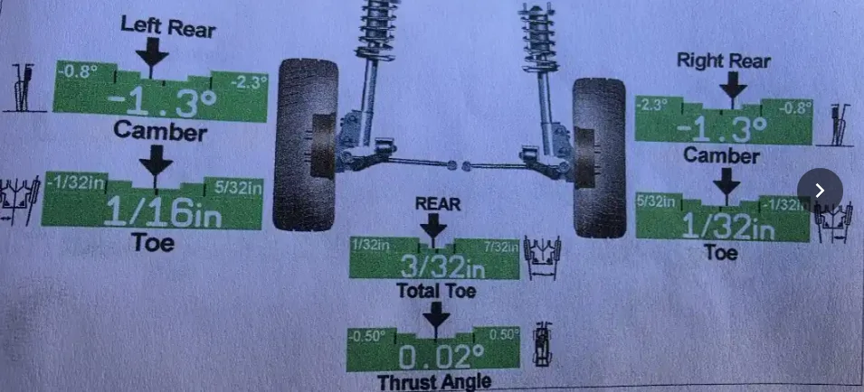

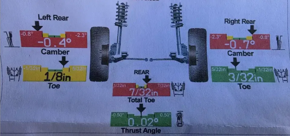

Possibly. I know I installed them correctly at first, but I've had a hell of a time getting someone local to align my car properly. I had Ford align it initially after being turned down by a handful of places and they would not give me my requested spec. It took them 3 attempts and I'm pretty sure they didn't touch my aftermarket parts for the adjustments. I ended up with basically no camber:
S650 Mustang Rear Camber Screenshot 2026-05-29 075316
Now this last weekend, the shop I was working with said that -1.3 was the best they could get. That was by maxing out both Steeda arms and then backing off on the side that exceeded. When they told me about it, I explained that the Ford tech likely screwed up my install and used the Ford procedure moving the arm mounting point outboard, and if they loosened them up and moved them inboard they'd get closer to what I asked. So that's what they did to get to -2 but it's still a ways off from the advertised range and your experience. idk, I'll have to get under the car eventually and look over their work but for now I'm mostly satisfied and excited to drive it the way it is setup.
