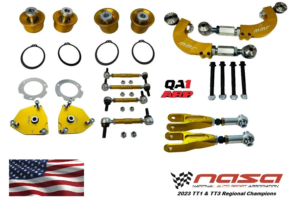

do you have to do alignment every time you change the camber?
Yes, because unfortunately with Fords design, camber changes Toe on both front and rear.
For those looking we offer great ways to adjust camber up front and camber and toe in the rear, let us know if we can help!
S650 Mustang Front Camber Adjustable Camber Plate 1777575628410-cu
