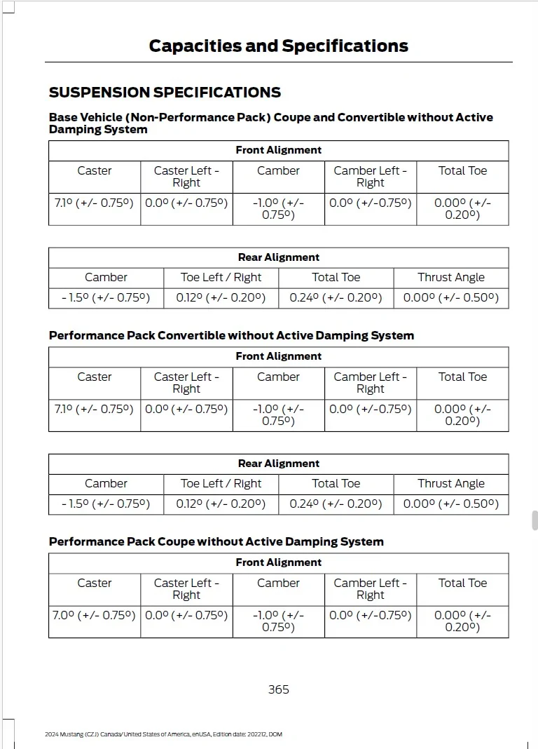

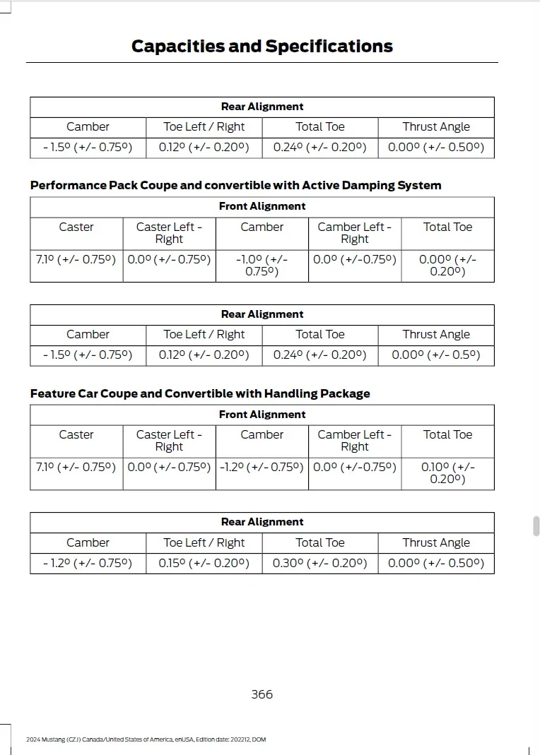

My 2024 manual shows -1.0 for both base and performance pack.
S650 Mustang Factory spec on front camber after Steeda camber plate install on MY26 Mustang GT Screenshot 2026-08-10 093608
S650 Mustang Factory spec on front camber after Steeda camber plate install on MY26 Mustang GT Screenshot 2026-08-10 093748
Thanks - that helps. Now I just need to fiqure out why the LH and RH strut rod positions are so far off of each other. I assume there is enough 'slop' in the strut bolts to explain the difference. Just didn't expect that much with splined strut bolts.
