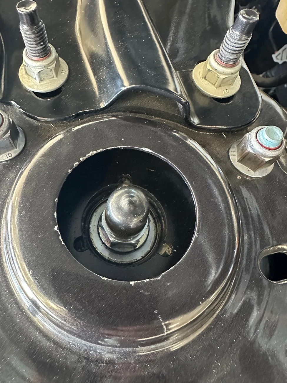

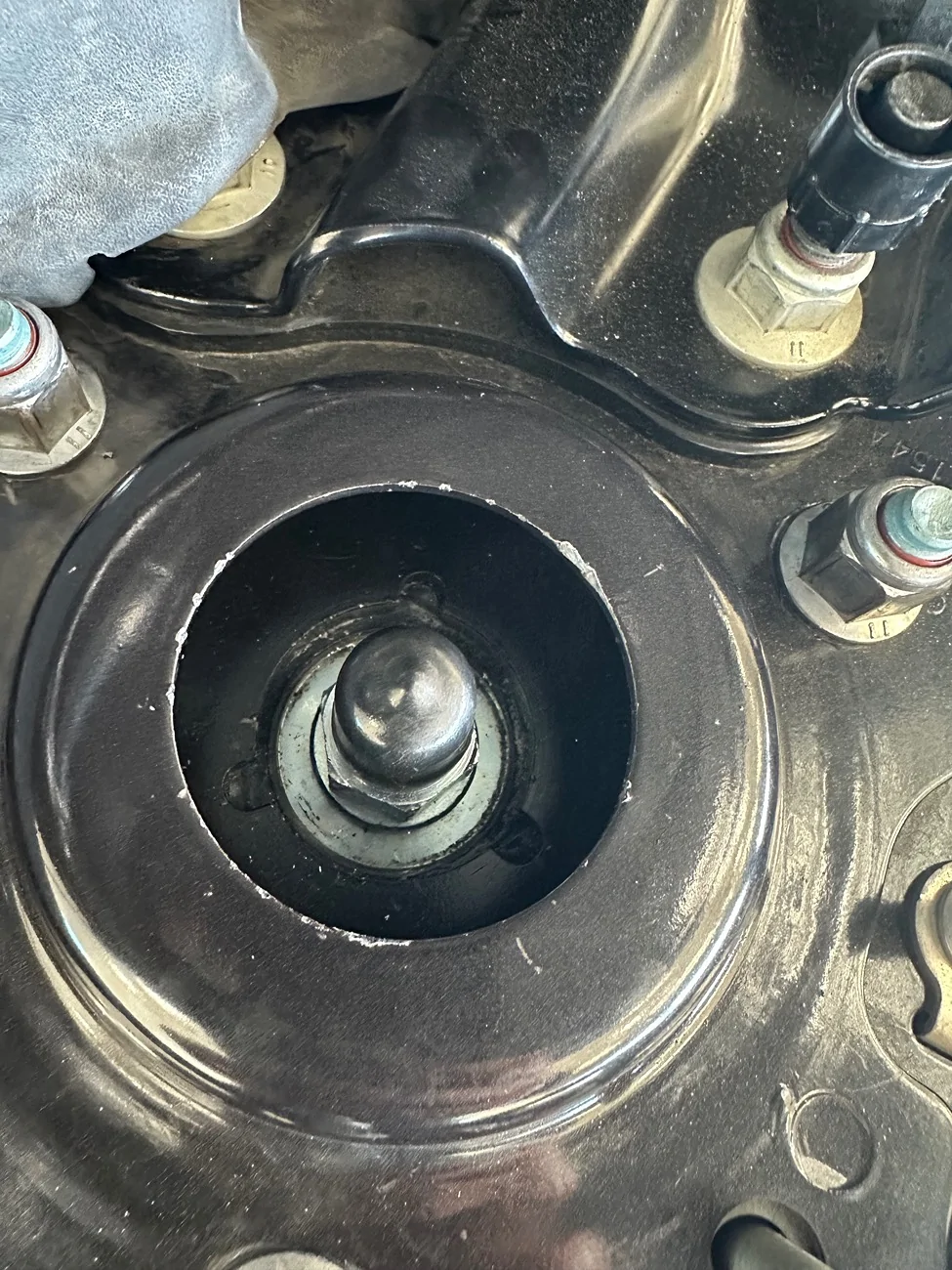

Thanks everyone! I know they didn’t touch camber especially since they couldn’t give me an answer as to how they tried to adjust it. They “tried” but all they did was bang it up trying to pry it or something. I knew they didn’t even loosen the bolts. Luckily there’s two shops that could get me squared away. Thought I’d give the dealer a chance but that was my mistake.
Shouldn't those be slammed all the way over to the edge of that large, uncut hole?
Junkyard Dog
Jun 3, 2025
2,971
2,471
Starting at about 40 seconds, Vorshlag shows us some tricks for camber, but they do not reveal how they got their knob under the top of the strut tower sheet metal so that they could add more negative camber without cutting the strut tower hole . . .
