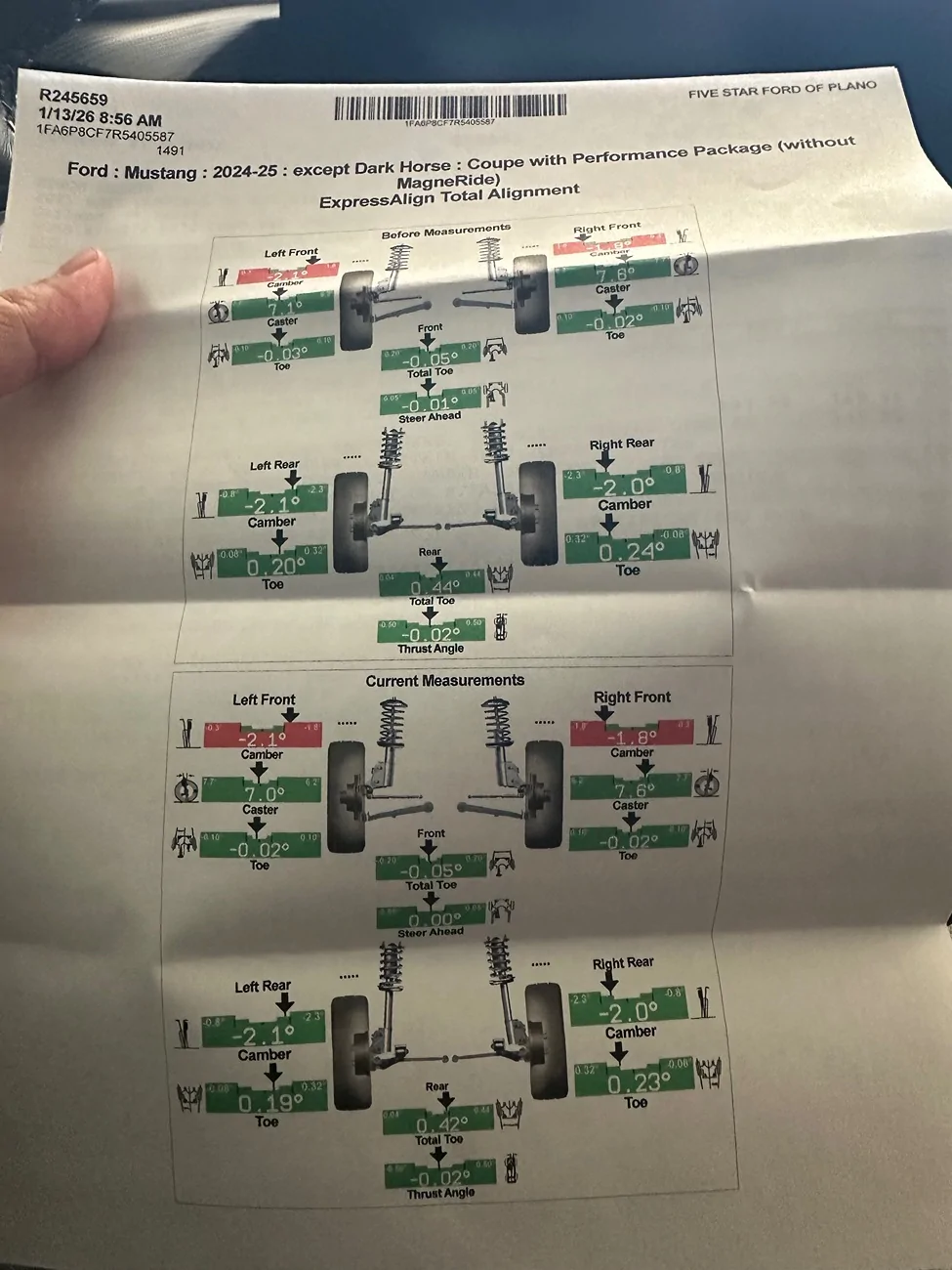

Also this is my alignment sheet. What specs should I be aiming for a street car that will be driven spiritedly and could see a track or two every once in a while for fun, but most likely street with some back roads? Also something that won’t eat my tires either if that’s possible to achieve or not.

I could get that in spec by loosening up the strut/knuckle bolts and shoving the parts to the limit of the clearance in the holes.
You need to find a 75 year old guy who still aligns cars the old fashioned way.
These effn kids know how to "set the toe and let it go", anything else might as well be written in Martian
75% of our alignment business is either straightening out other shops eff ups, or doing real all wheel alignments that other shops refuse to do because that $89.95 alignment or "free" alignment when you buy tires does not allow for the time to do it right.
A sheet like that would NEVER leave our shop so long as the suspension was in good shape and the frame was not damaged

I doubt they touched your camber. Ford's camber plate range is out to -2.3*. The Ford service manual procedure calls for notching the top strut to spindle bolt hole which they'd look at and go "no thanks". Yes, weight needs to be off the wheels to adjust camber. After loosening the top 3 strut nuts, slide the strut inward for more negative camber and pull it outward for less. Negative camber is fine for street tire life. Bad toe and thrust angles are what really wear them out.

Doesn't look like they touched it... maybe bounced it up and down a couple times.
In the manual too... at least factory specs. If going for occasional track use -2 all around is good, but less toe in the rear... about .24 total.

Thanks everyone! I know they didn’t touch camber especially since they couldn’t give me an answer as to how they tried to adjust it. They “tried” but all they did was bang it up trying to pry it or something. I knew they didn’t even loosen the bolts. Luckily there’s two shops that could get me squared away. Thought I’d give the dealer a chance but that was my mistake.
