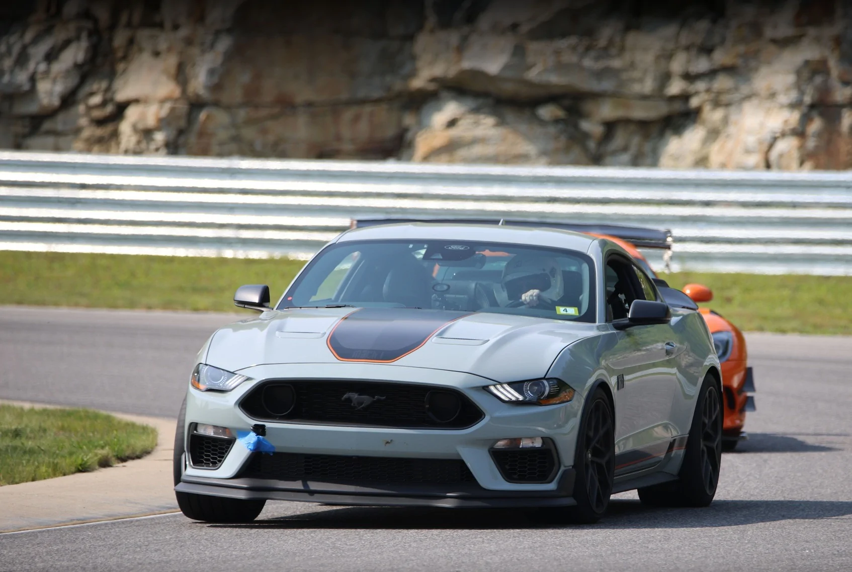

This is with only -2.4 degrees camber at speed around the almost 180 deg turn 10 - 11 at Club Motorsports. No abnormal tire wear at all. And yes, once we reached the main straight, the Dodge Viper with all that aero behind me passed me like I was standing still. 😂🤣😂
S650 Mustang Ford Performance Camber Plates & Alignment Mach 1 20230616 CMS 013
