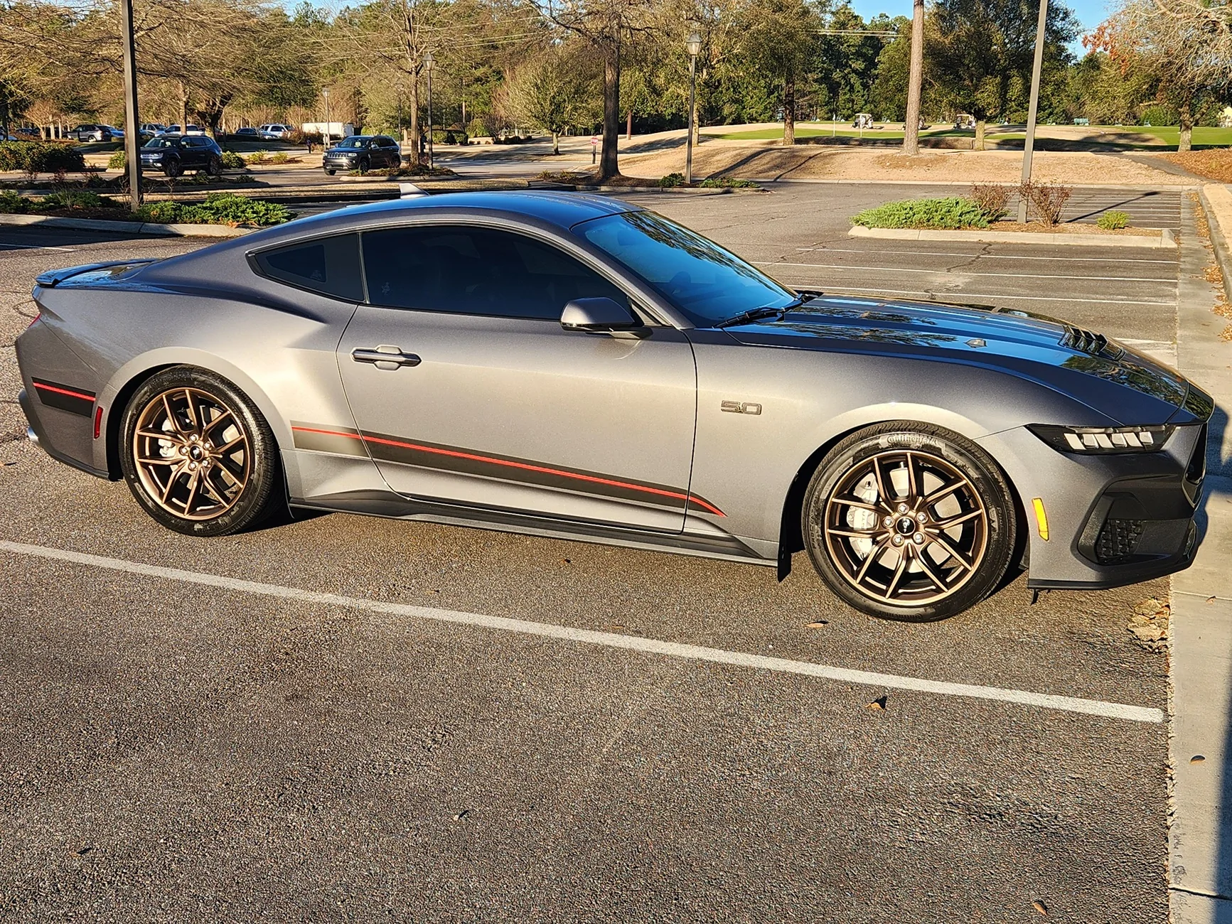

I ordered 2024 GT Premium 401A with nothing more (like Brembo, mag-ride, active exhaust, etc) and have been completely happy with it. I just did Eibach lowering springs (totally great mod) plus X-pipe resonator delete (also great option) and have I believe an optimum nice daily driver. I have ordered cars in the past with the performance upgrades (like Vette Z51 mag-ride) and finally realized the extra costs weren't really worth it for normal driving. As others sagely observed, the best advice is to realize your own driving environment and buy what you like that fits that best. I have enjoyed adding personal touches, like new wheels, stripes, etc to personalize your ride at nominal cost. Just do what you like and don't over-think it! Can't go wrong with an S650 IMHO!

Mine is same exterior color, but I added the black/red stripes and bronze appearance. Then, found some pretty cool side stripes with a little gap in the middle just right to add additional red stripes to match the top stripes! This shot shows that look, plus give a good idea how the lowering springs really helped the stance! I like the bronze wheels and little additions. Think the side stripes help break up the sort of slab side looks. But each to his own and that's one of the beauties of the Mustang!
