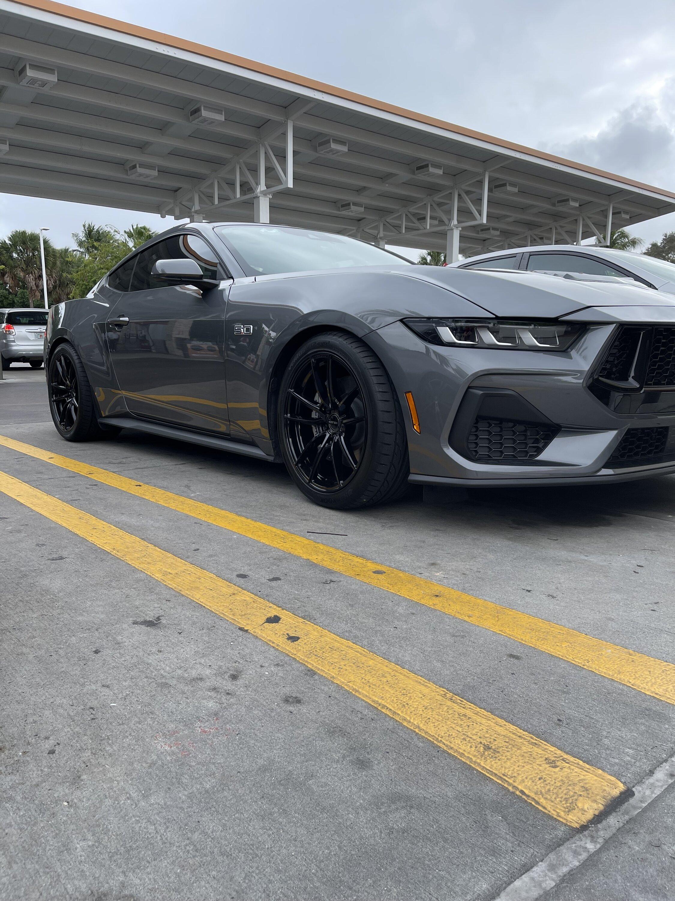

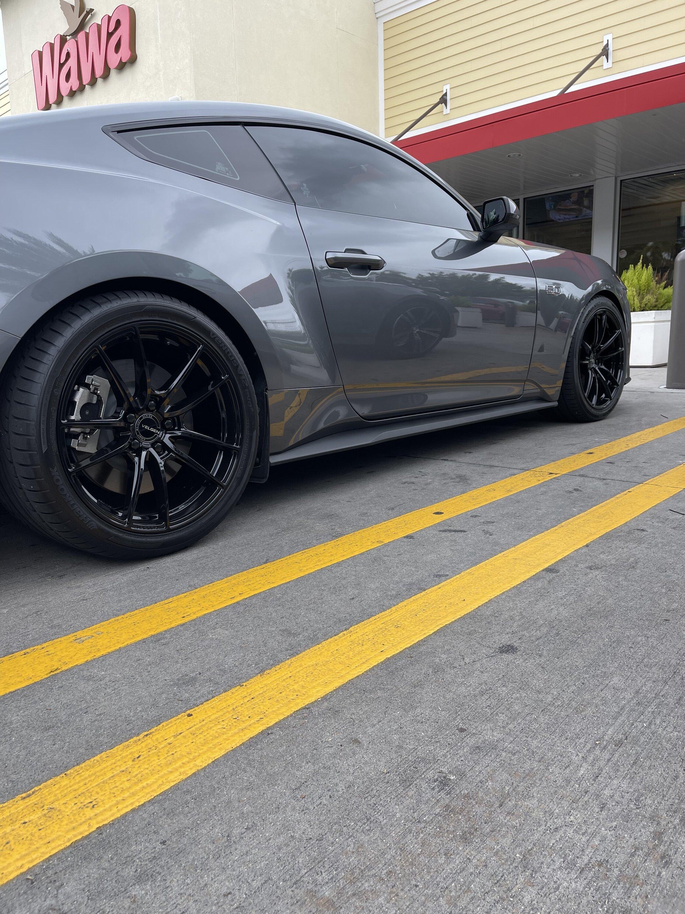

Hey man I am currently running 325/30/19 in the rear and lowered the car on steeda progressive springs which drops the rear and front about an inch. The wheels i have are +53 offset in the rear if i’m not mistaken. No rubbing issues at all. honestly i could probably upside to a 35 sidewall once i go through these tires. plenty of space for me. front tires are 285/35/19 no issues either
Is that a VF five or a VF
Man that looks so fire really nice set up and stand !!
If you’re asking about the wheels they are the Velgen VF5. 19x10j front and 19x11j rear
