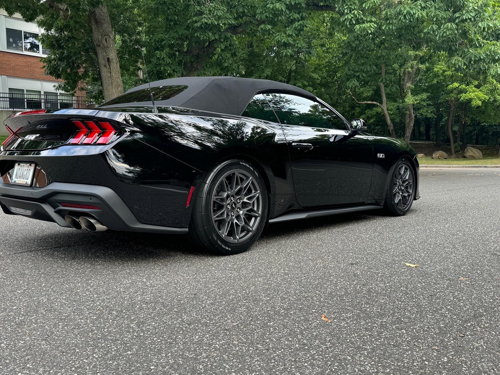

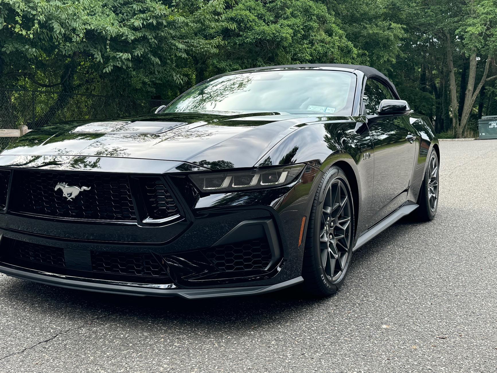

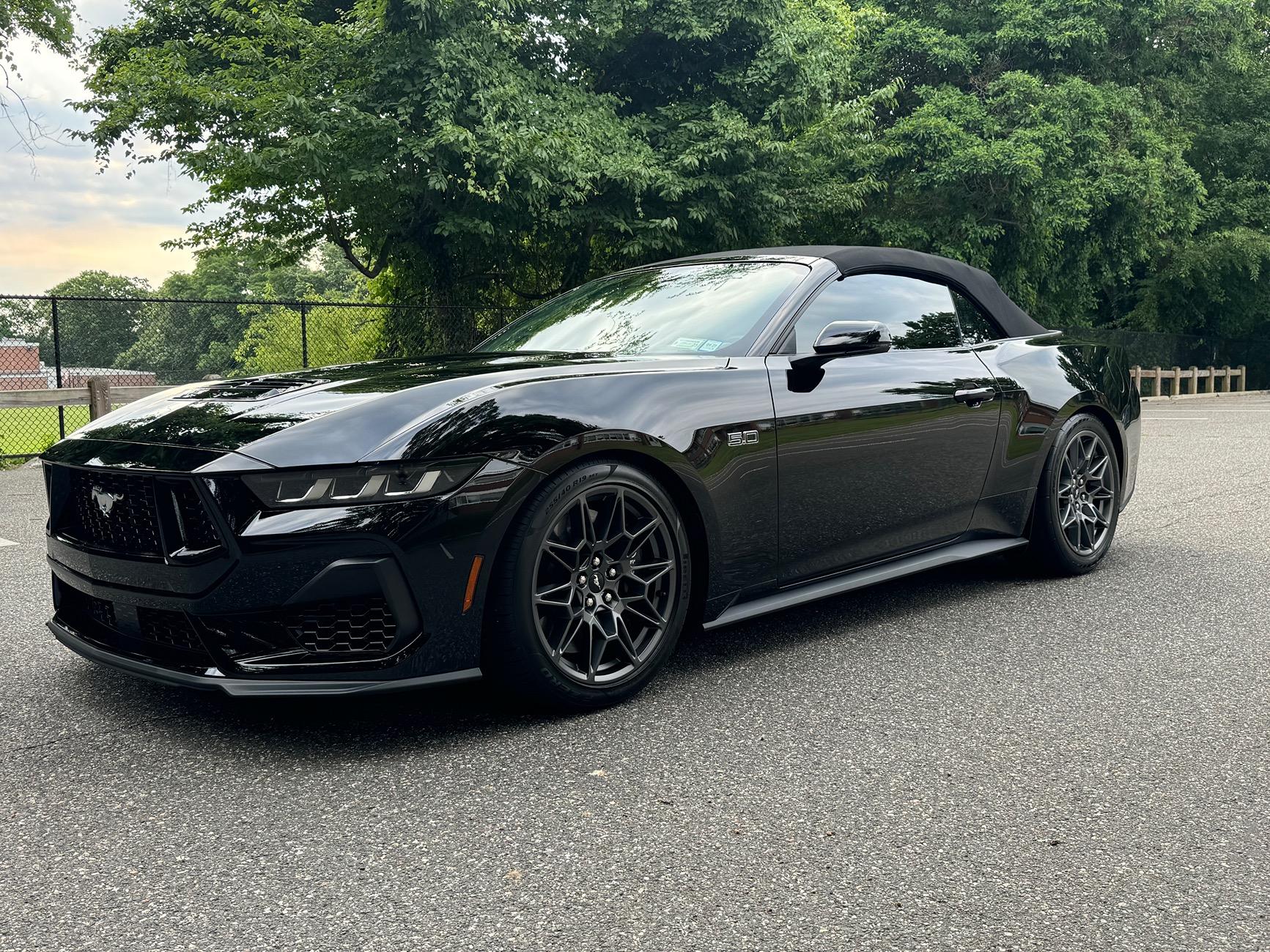

Ndangrd5.0
May 1, 2024
Oyster Bay NY
24' GT conv
hi I just installed the camber plates with a 1/8 ” spacer up front and it look 100x better. unfortunately I did this 3 times to figure it out. I first lowered car with no plates or spacers. It bugged me really bad after looking at cars with correct equipment.i.e Shelby Mach one’s. So I re did it and it’s perfect
