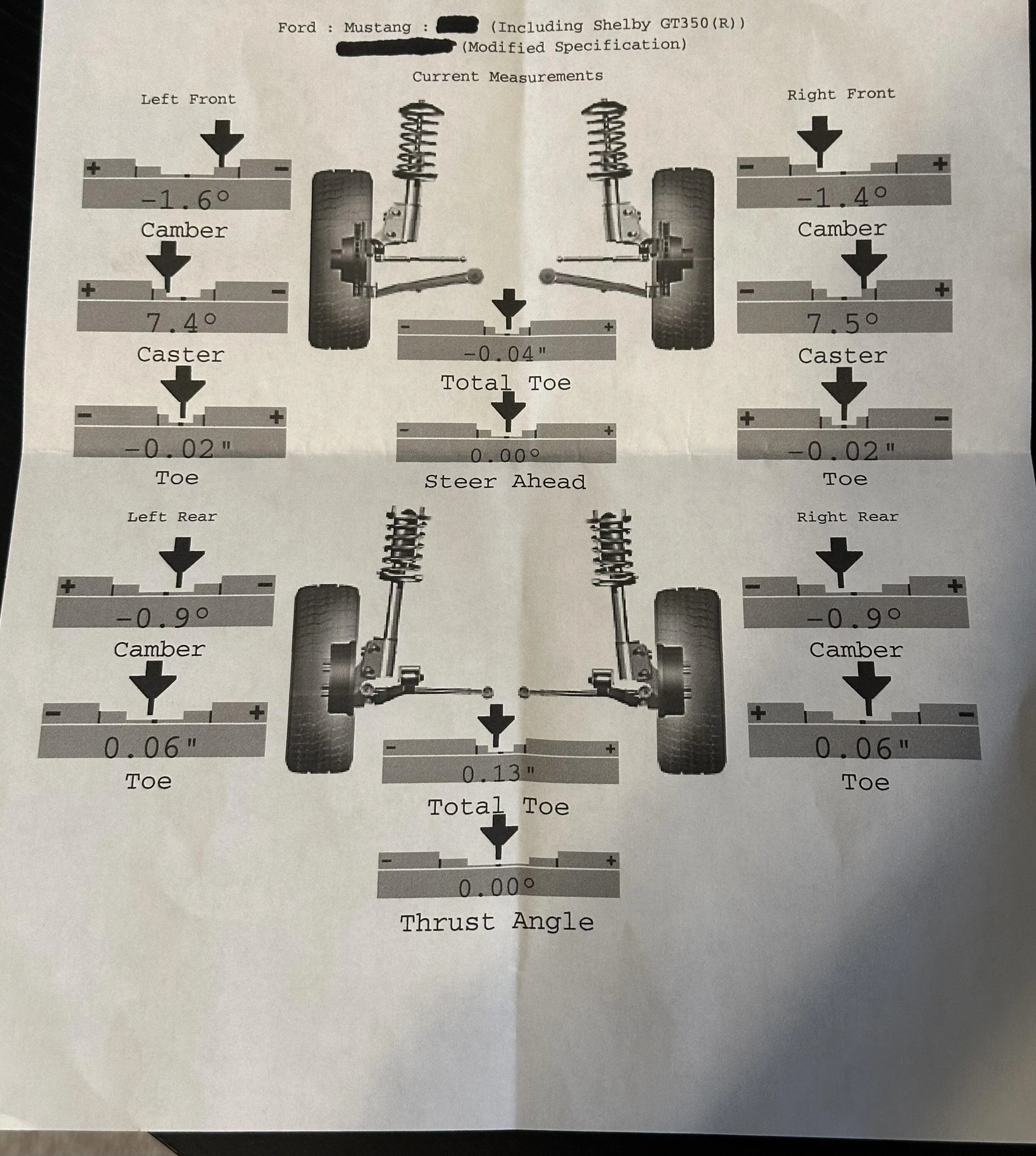

Recently I got my steeda progressive sport lowering springs for my 2024 Mustang GT. As soon as I got them installed I’ve been having an issue I’m trying to chase. When I apply the brakes at 60-65mph I get a vibration/pulsation in the steering wheel. Only at those speeds. Even if I apply the brakes at 75 mph and I’m on the brakes till about 50mph the steering wheel won’t start to vibrate until 60-65mph and then go away at 50 which is odd to me. When i got my alignment after the springs were installed my passenger side caster was 8.0° and my driver side was 7.1° people told me to correct that and that could be the issue well I bought caster camber plates and corrected that now my caster is at 7.5° passenger side and 7.4° driver side and the issue still persists. My wheels are balanced I don’t think it would be my wheels. What could it be? Rotors?? If my rotors were warped wouldn’t it vibrate the steering wheel at any speeds and not only 60-65mph that’s what’s throwing me off. Other than that car drives straight as an arrow and doesn’t drift off and feels great. Any help is appreciated thanks
I also plan on tracking the car a few times this summer and this issue would be super irritating when cornering and braking

sounds like a brake pulsation. Nothing in those numbers would cause a vibration. Higher caster could cause a shake but not under braking.

What else was done at the same time as the springs (ie new wheels/tires)?

Nothing else was done at the time of springs. A few weeks later I got caster camber plates installed.
Gothca, and did the vibration occur before the CC plates were installed?

Strange... Have you checked all of the strut hardware to confirm everything is tight?

Very strange, next best course of action would be have wheel/tires checked (which you already suggested)
