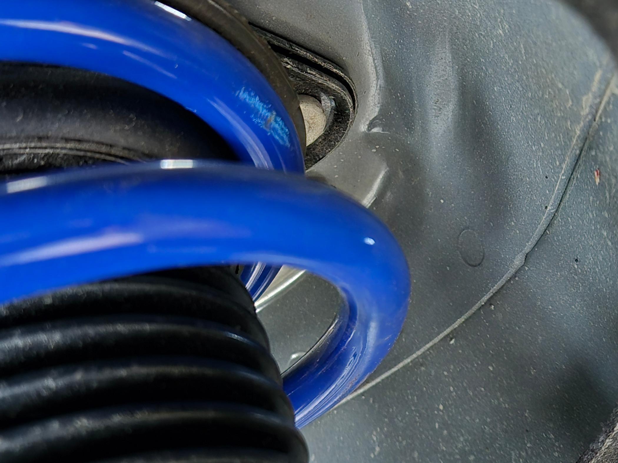

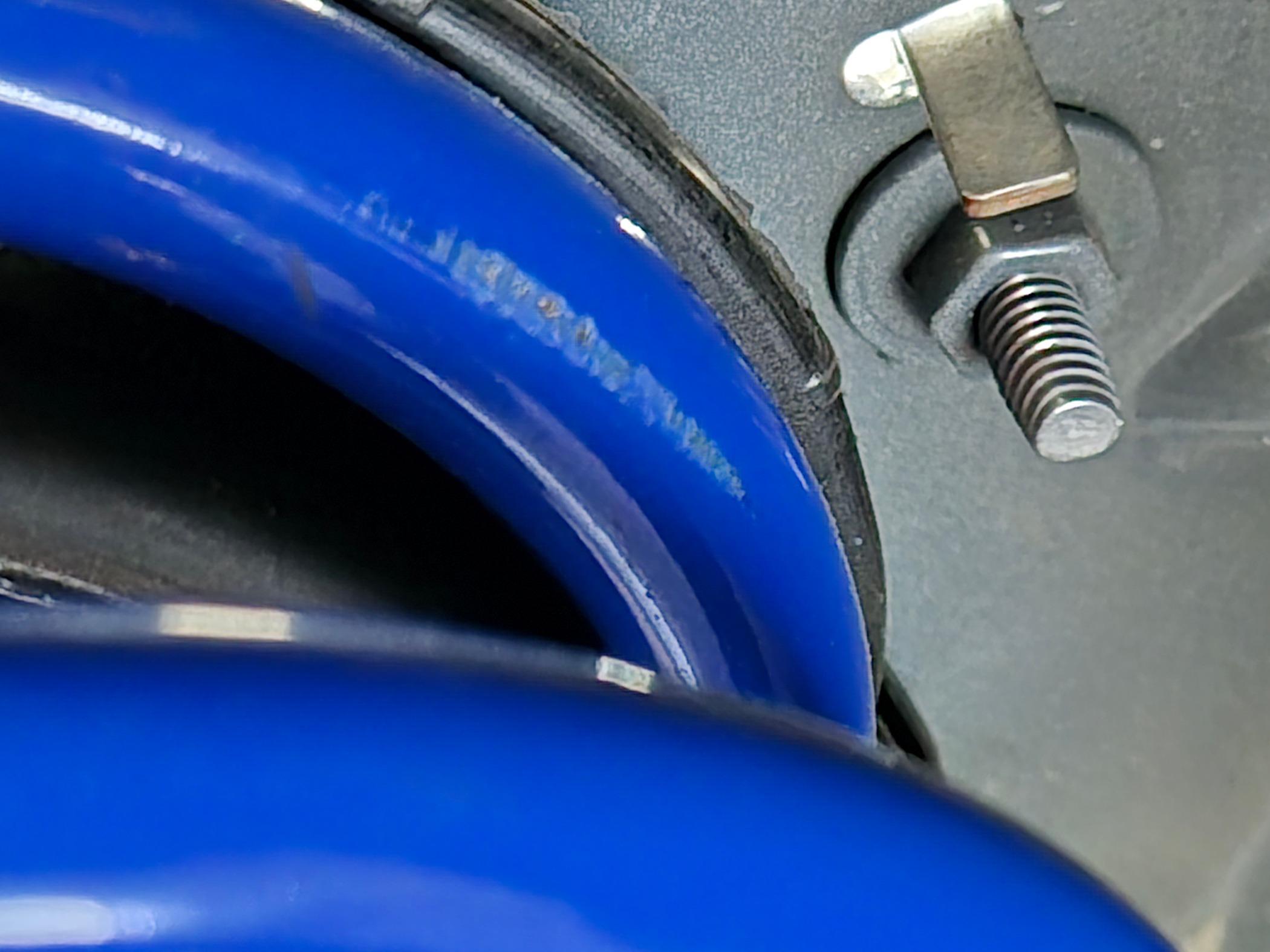

hey, just a FYI did you check your springs for any signs of contact (scuffs/scratches/paint removal). I sent these pics to Steeda support and they think this may be the issue. They're currently checking with the engineers and they'll get back to me.

I do have some slight spots like that on them. I did email them about the sleeve isolators but the initial response insisted on the sway bar end links. I haven't responded more on that yet as I am upgrading the sway bars anyway so I will respond then if the clunk doesn't disappeared after the sway bar swap. Keep this updated on what your find out. Thanks.
