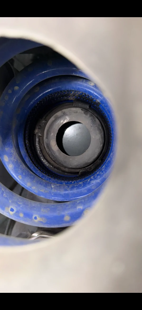

Thanks for the suggestions. I haven’t had the opportunity yet to try to replace the bump stops or have it re-checked by a different shop. I am installing jacking rails this weekend, so may knock out both at the same time. It is definitely a metallic rattle, so idk if the bump stops will resolve the problem.
I will probably order the rubber coil isolators before having someone check it again. I did look under the car a few days ago, and took some pictures of the spring assembly. This one picture seems off to me. Not sure if it is the angle causing a distortion, but this looks crooked to me. Wondering if it is the spring is not seated properly but I am not familiar enough with how it is supposed to look. This is the side making the most noise.
