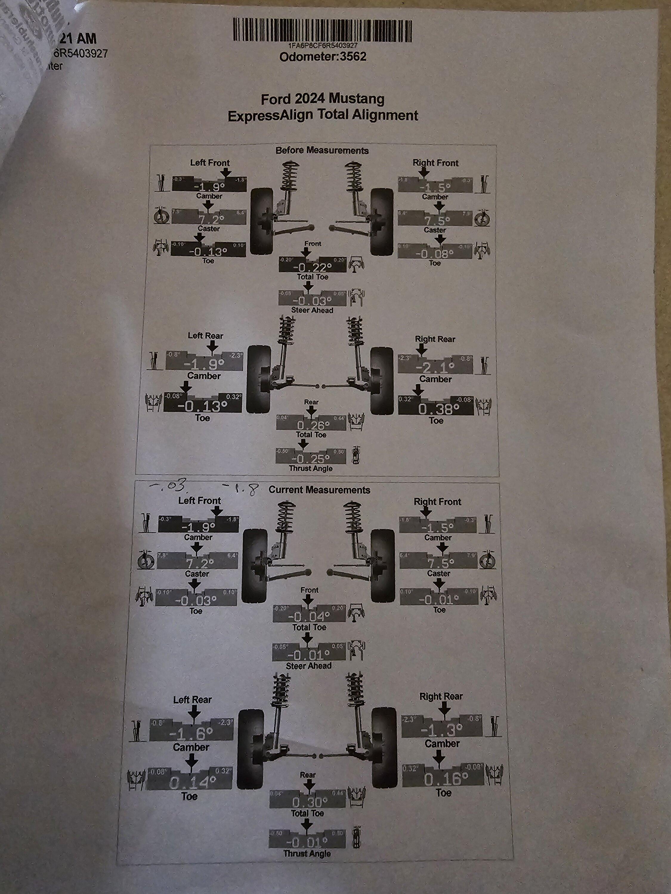

So I posted a few days ago that I got my Steeda Lowering Springs installed paired with my Velgen VF10s, 20x10 285/35R20 F and 20x11 305/30R20 R. I had zero rub from lockout to lockout on the fronts, but was getting a nasty rub on the driver's side front on any cornering and slight bumps. I just got back from the ford dealership after my alignenment, and the rub is better, but not gone fully. So now I'm looking for opinions on what to do, do I leave it be as it looks like the rub is from the wheel well liner on the top edge of the sidewall, do I buy 275's (not sure how much more clearance that'd give) or do I put the stock Springs back on (I don't want to do the most). I've seen plenty of people running this setup as well as Cleared with Velgen and Steeda that this fitment wouldn't cause issues so it's frustrating that I'm having issues.
It really could be me being too critical because like duh hard cornering and bumps are going to rub on a lowered car, but no one ever says that so it's making me think it's a problem.
Posted is the before and after of my alignment, only thing that was way whacky was the driver's side front toe, which I do think had something to do with it being so bad before the alignment, but I'm not fully sure what all I'm looking at. The passenger side front has only rubbed 2 times and it was a big bump and a really hard cornering, not sure what the difference is seeing as how my drivers side camber is more negative so the problem area is theoretically further from where I'm rubbing on the driver's side then the passenger side.

I ended up ordering a set of 275/35R20s just now, hoping the 8mm height difference and 10mm width difference will make it clear.

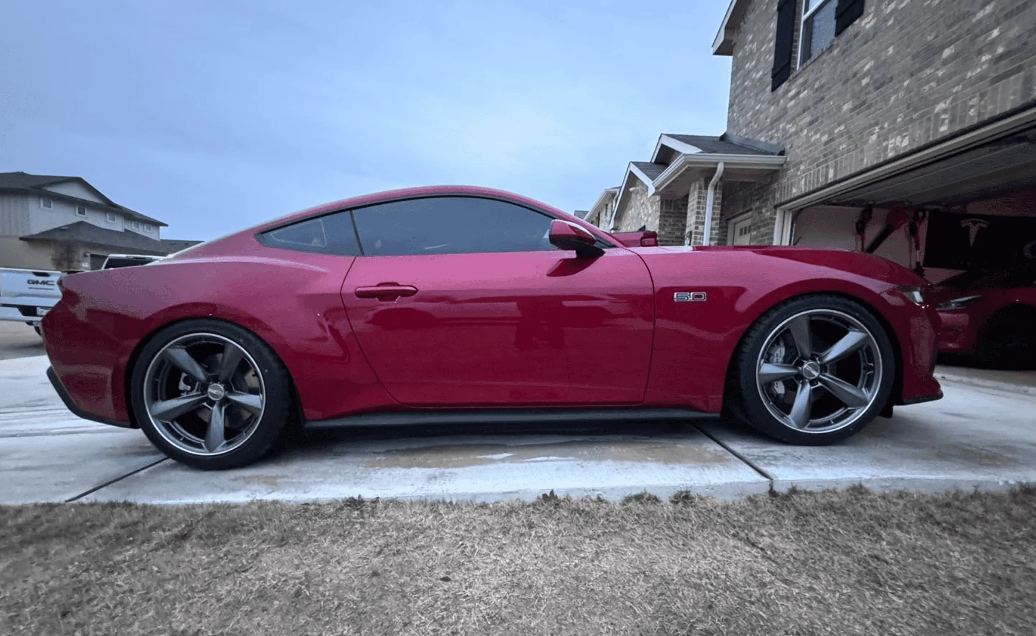

Not with normal driving, but speeds bumps you just need to slow down. Driveways, etc. You will be fine if you go any lower in tire size for sure. But I like the 305 on the rear, some are doing 295 on the rear though. But going anything higher than 275 on the front, is not a good look. If will rub. I've seen 315 on the rear, and no rub...but it depends on your wheel and offset. I have AR946 Wheels, 20x9.5 front (offset 32mm) and 20x11 rear (offset 50mm). I'll post pics when I get a chance with a side view before and after lowering it.

Here ya go, I took a pic a few moments ago, it's very nice. Better than factory, and no rub or scrub. My driveway is DEEP too when you pull in, no issues at all.

Looks good!

I'm not worried about where the camber is off at, as it's in the range I'd be accepting. I just think the 285s are the issue. The rub is on the outside of the tire so any more positive on the camber will make it worse. But I fully believe the toe being off on the FL had a big role in the issue, as it is not near as bad now as it was before the alignment. I still have 275s on the way and they are already scheduled to be put on Wednesday next week.
