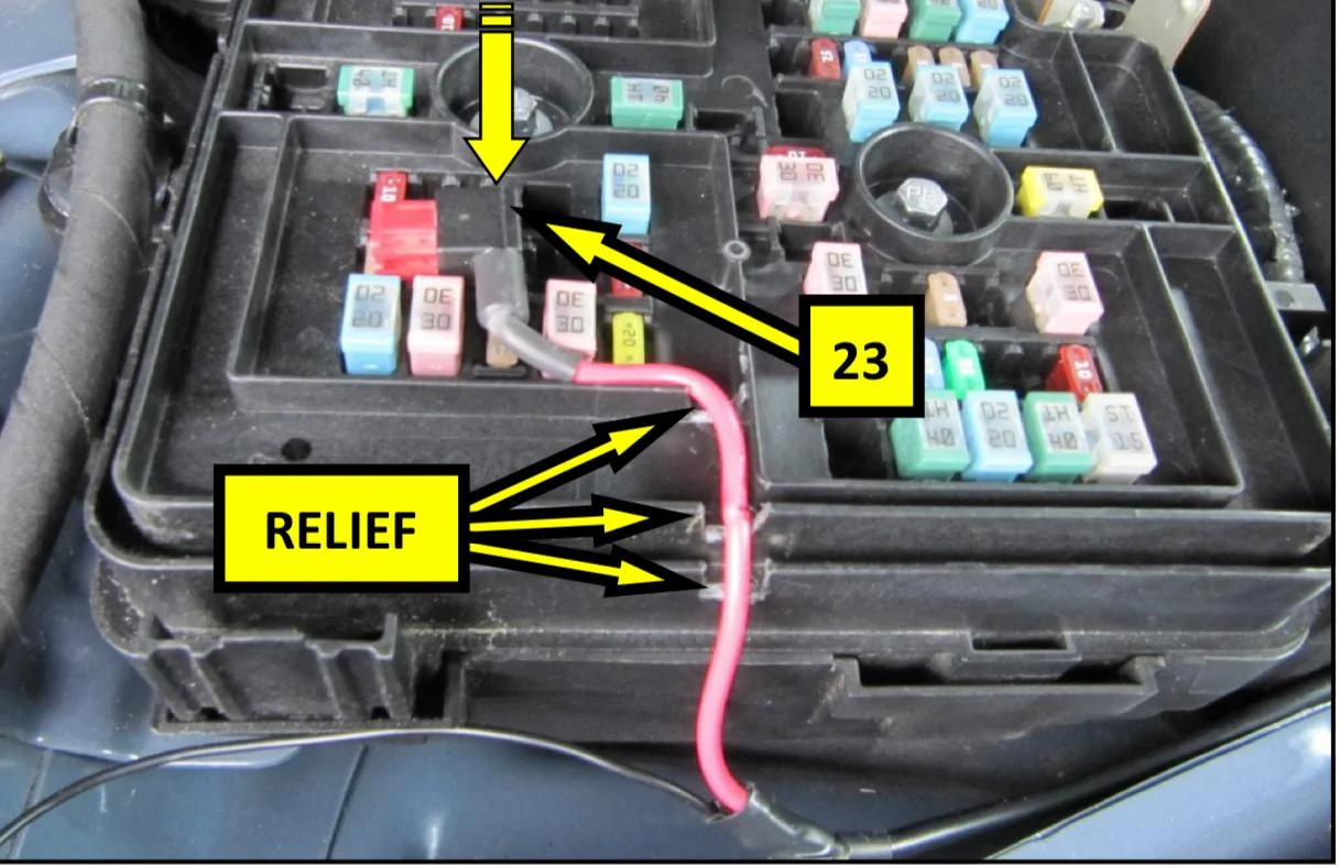

probably worth having a shop do it, mainly because of the springs for the struts. a good shop will have a tool to compress the spring and techs that know how to deal with it so they don't get hurt. you warranty will be fine unless something happens as a direct result of the modifications. if, for example, your starter fuse keeps blowing, that fuse tap for the grill lights has no affect on that fuse, so it would be warranty

The grille lights have to be tapped into the fuse box ..so I would assume if you have any electrical issues in the future related to that fuse box ..Ford can blame the grill lights and deny any warranty claim
This scares me, and not really a fan of modifying the electric components.
Is there a viable alternative that doesn't tap into the fuse box?

Just replacing a fuse this actually isn’t too crazy. Way better than others seen across the market for a lot of cars.

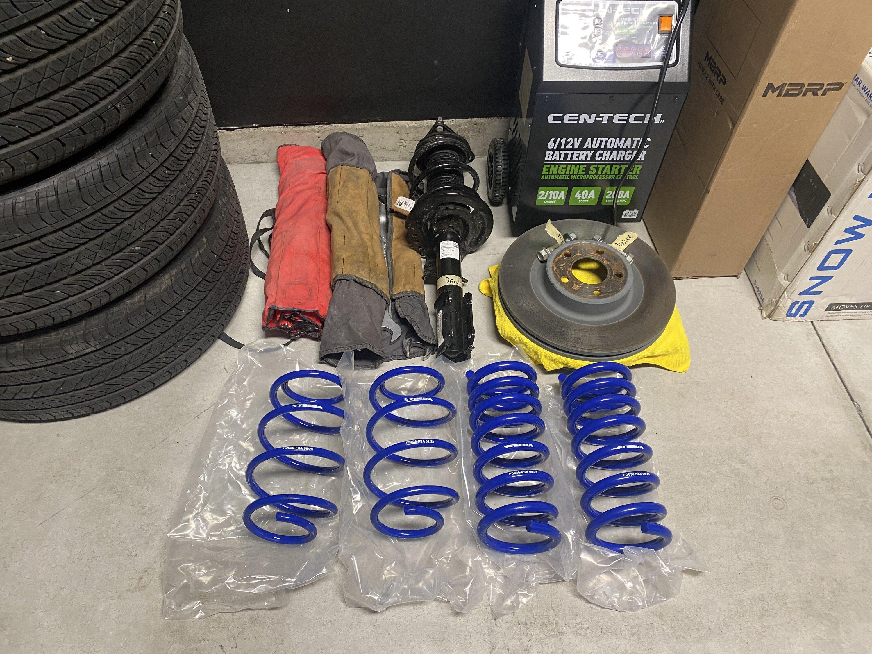

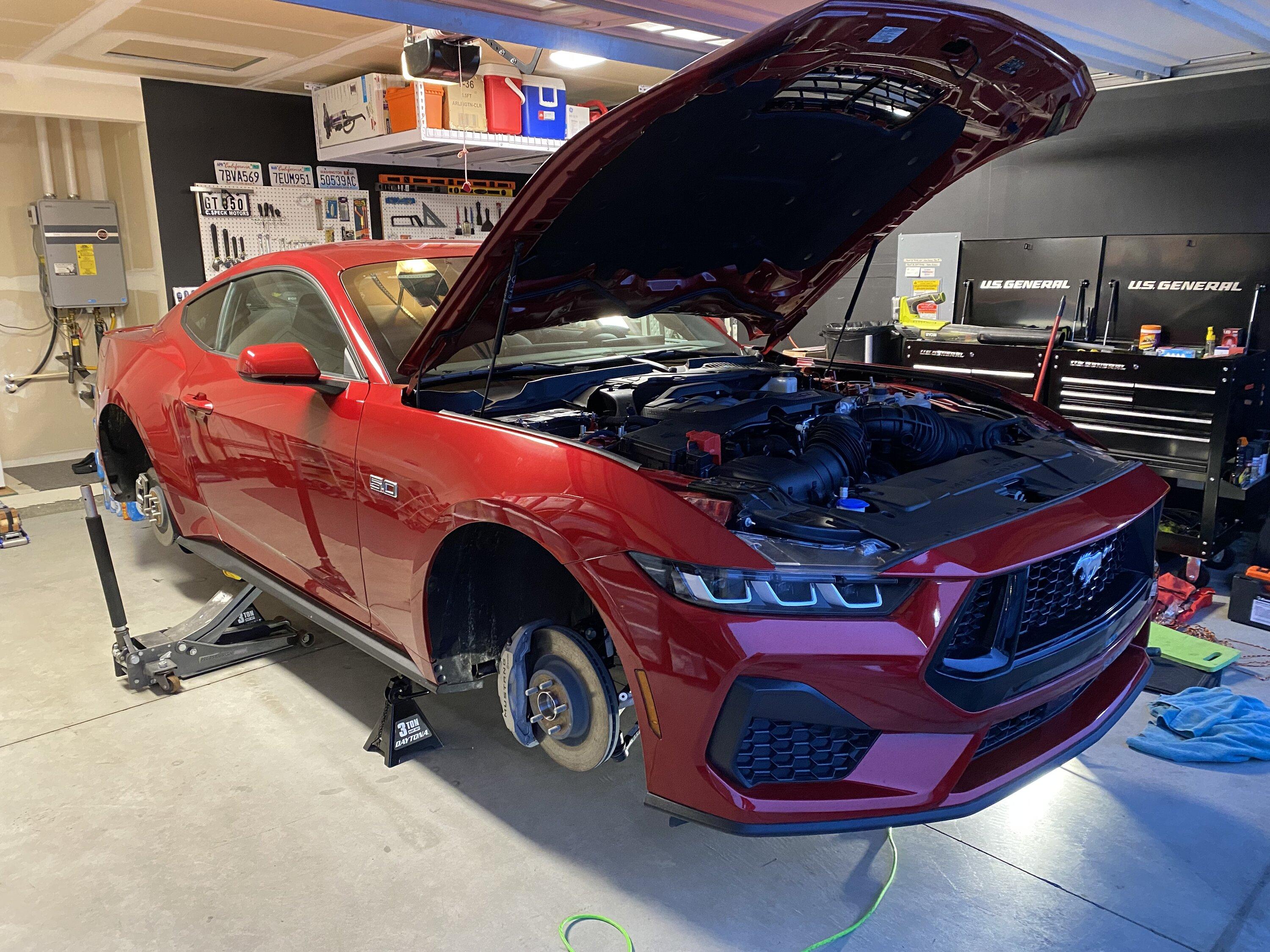

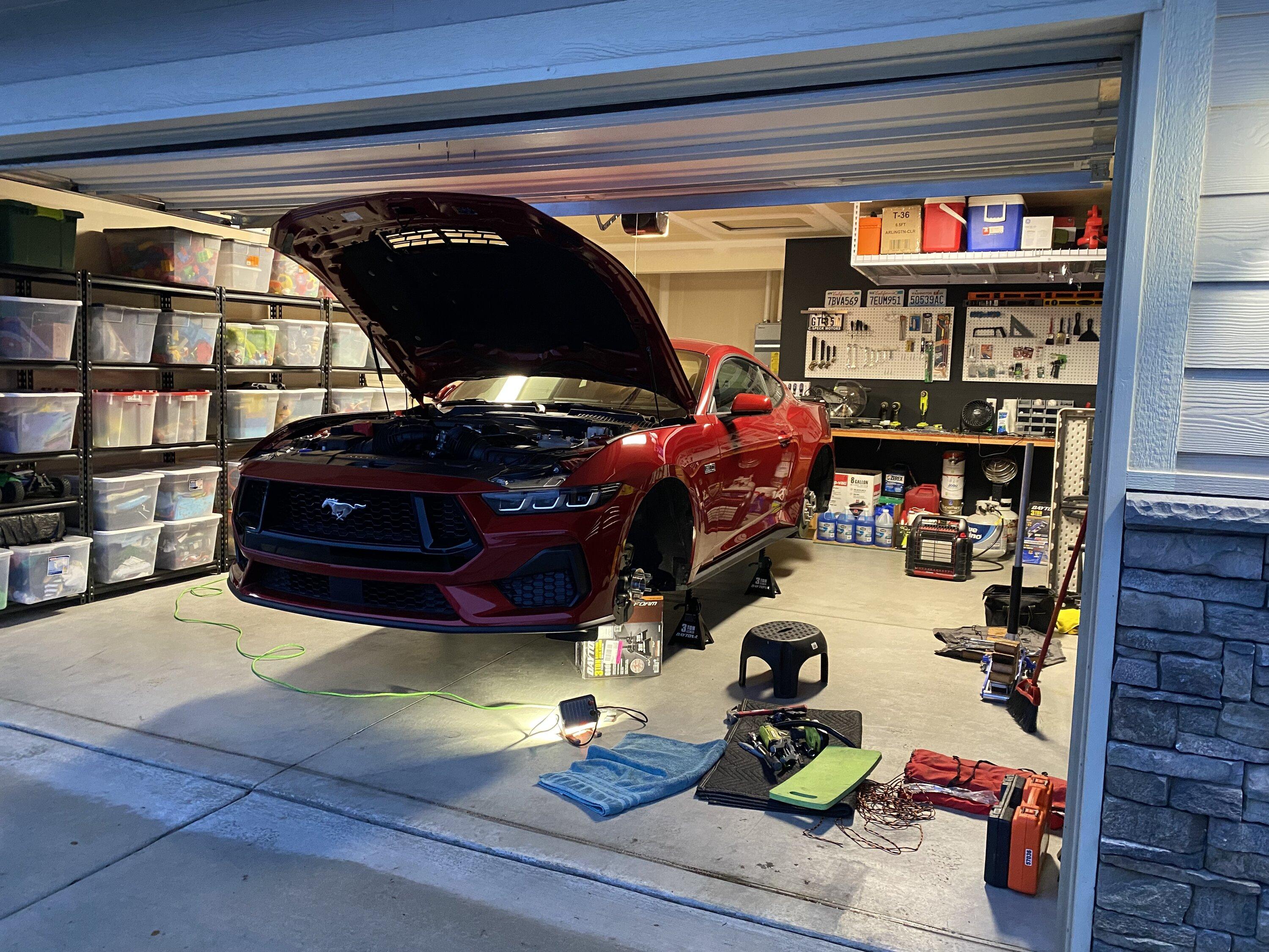

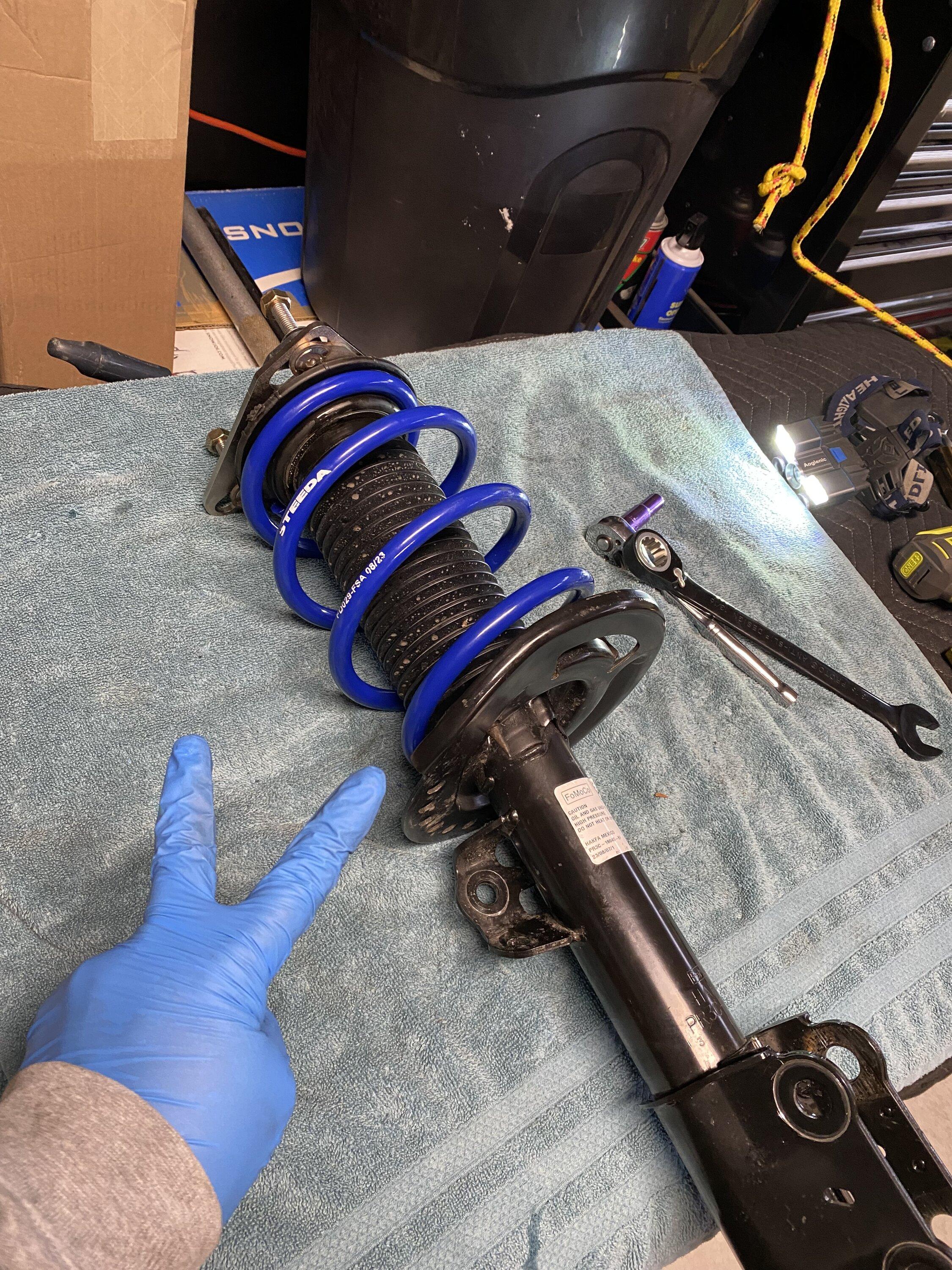

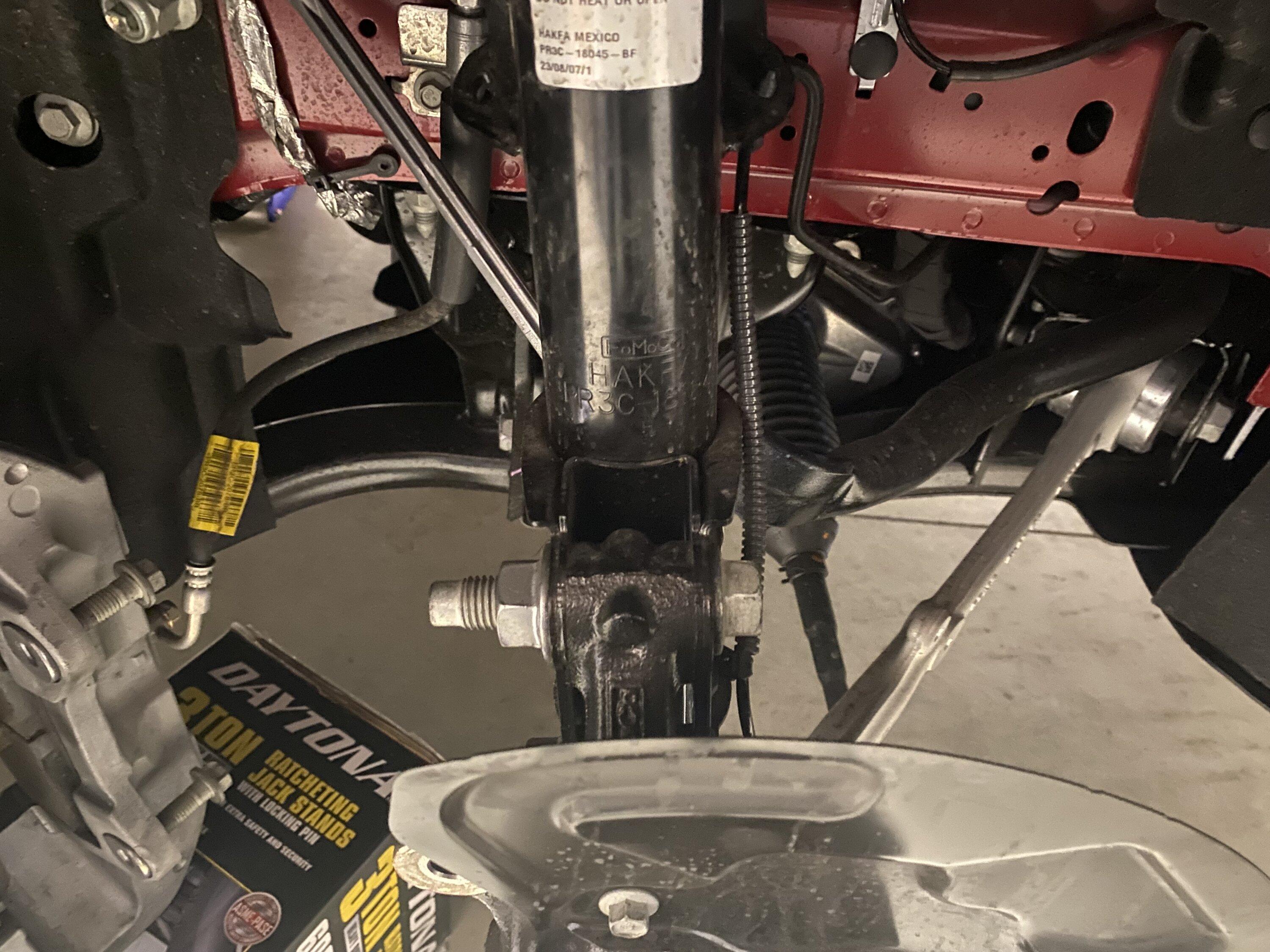

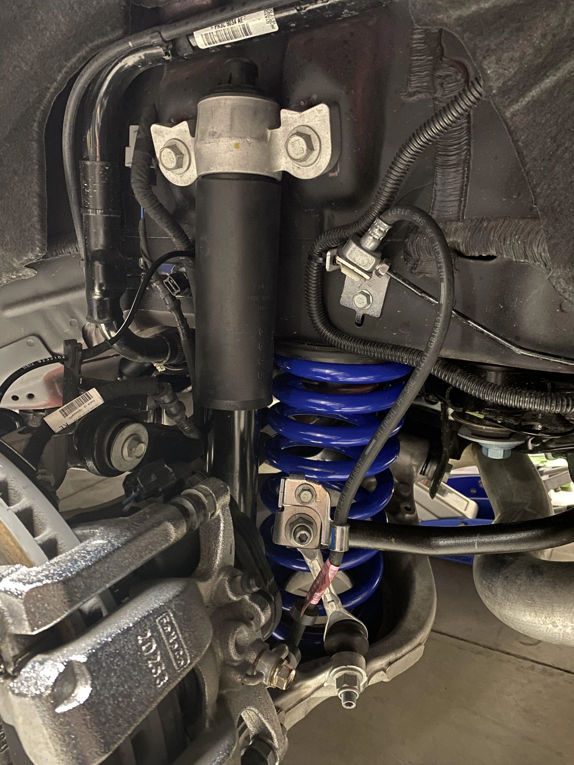

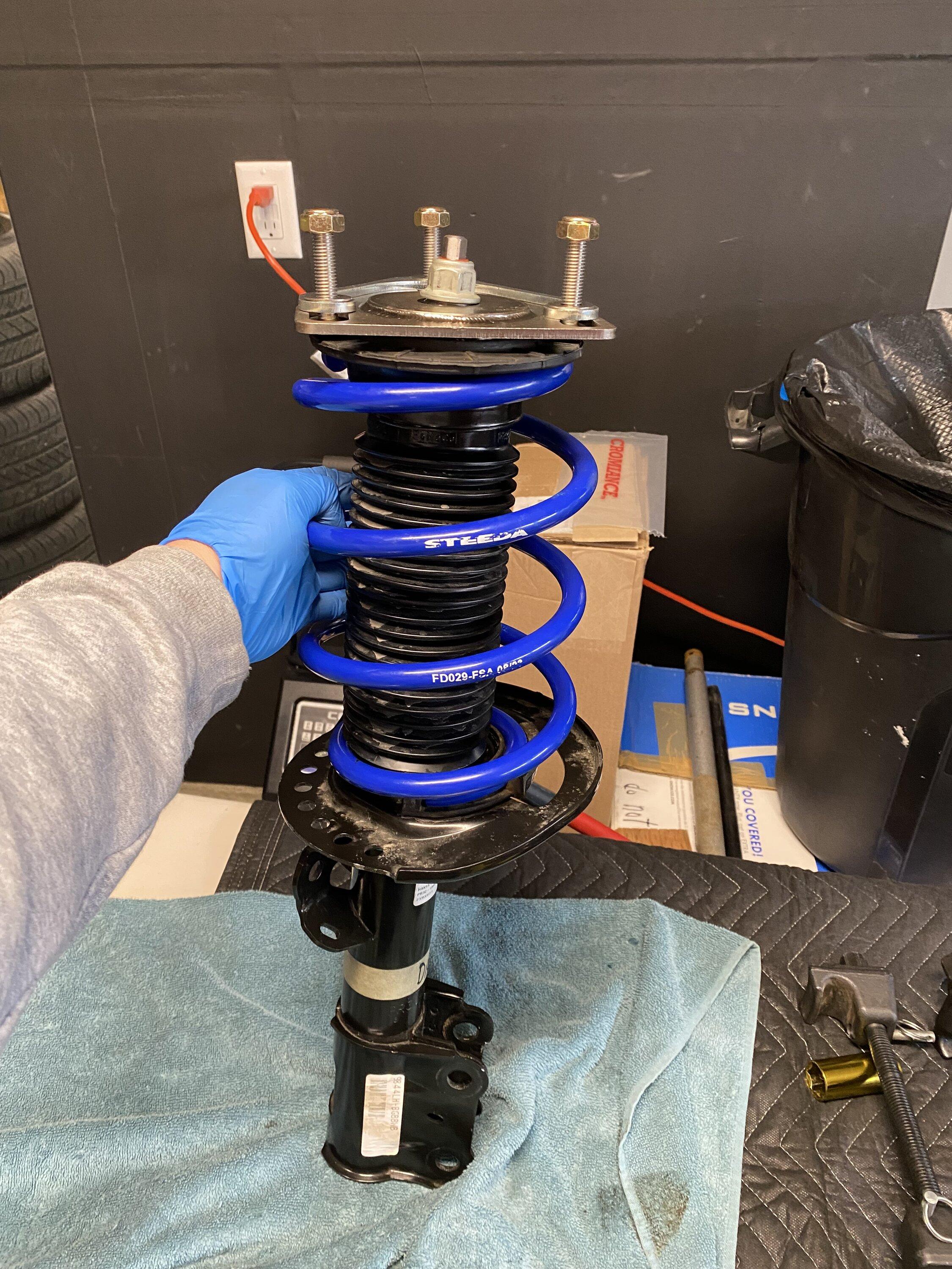

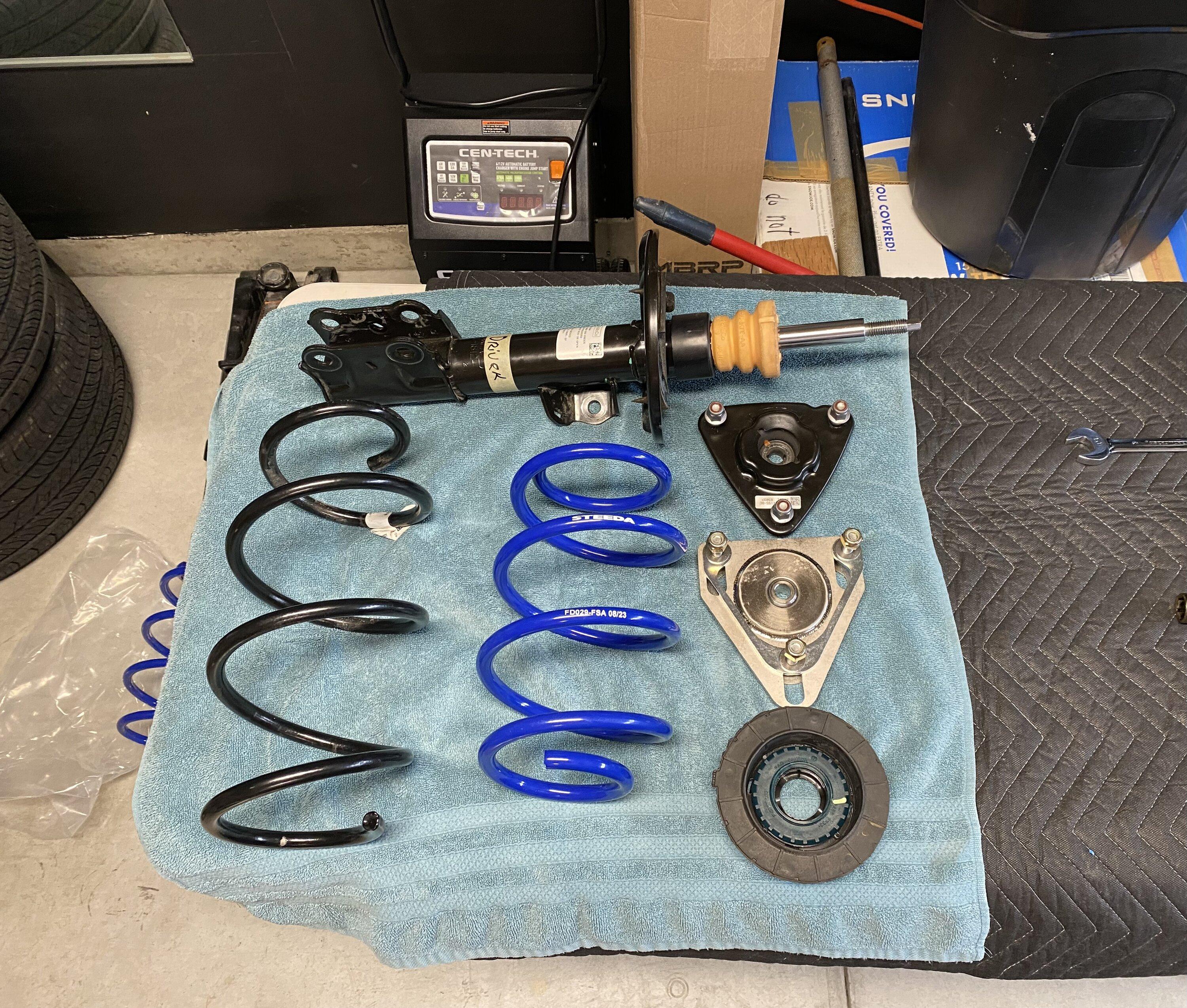

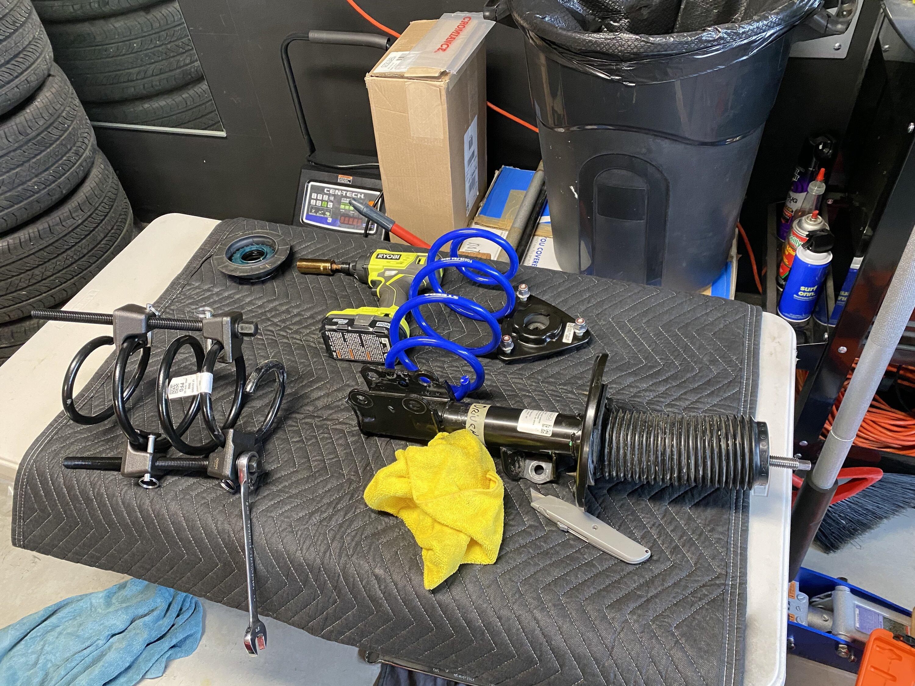

You can do it yourself I’m not mechanically good at stuff but I did it myself I took my time I finished the front the first weekend and I finished the back the second weekend I don’t have all the tools but you can always rent one at your local auto parts stores I actually use two sets of spring compressor one from O’Reilly and one from AutoZone I have two 2 ton floor, jack barrow for my neighbor I have impact wrench, borrow from the other Neighbor. I have 4 floor jack stand borrowed from my brother-in-law, I find it rewarding doing it myself.. there’s tons of YouTube videos out there and of course a forum like this you can always ask and we’re here to help

Nice job. Super good choice on the Steeda springs. I did all that on my 2011 with Bilsteins and other suspension Steeda parts. So far my MY24 will be stock with the PP. I couldn't part with the 2011 as it is much too good of a car with all the work that went into it. Handles like it was on rails.
