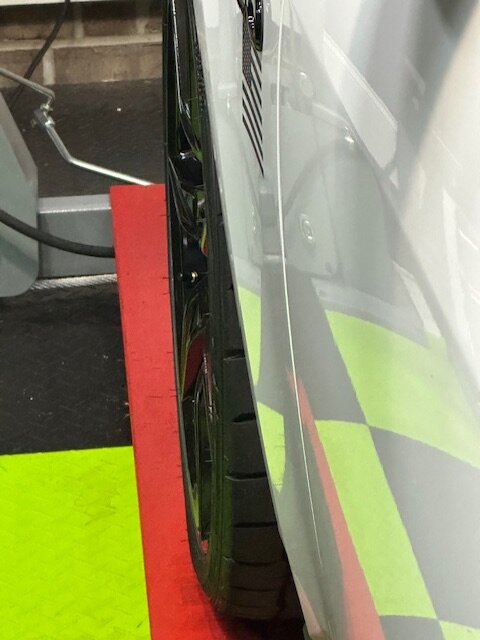

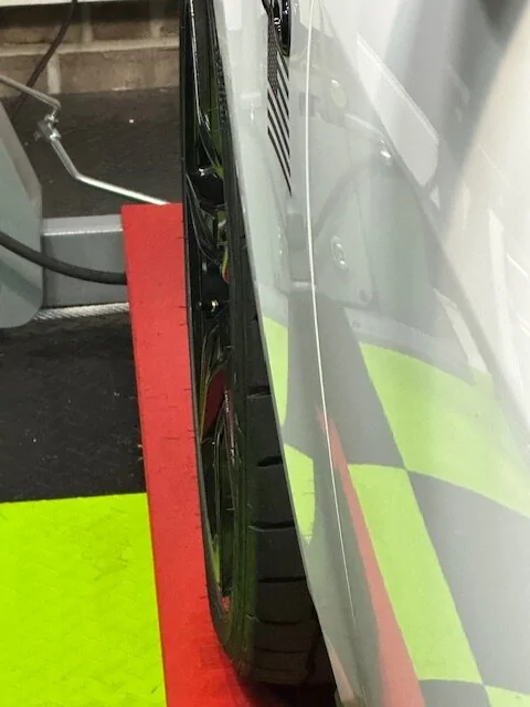

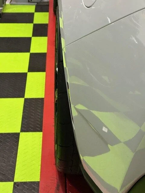

I bought some LMR SVE CFX wheels size 20x10 +35 - and 20x11 +50 wheels are really nice - with a combination of Nitto 555 G2 285/35/20 and R2 305/35/20 ....
Why I'm posting is because this combination fits however, if you go bigger I'm pretty sure you would have isses unless you employ wheel spacers. Also, there is no poke in the rear BUT it's very close so close if you go 315 in will poke a tad not much, but a poke is a poke ...🤣
S650 Mustang Aftermarket Tires and Wheels IMG_8623[3]
FRONT
S650 Mustang Aftermarket Tires and Wheels IMG_8621[1]
REAR
