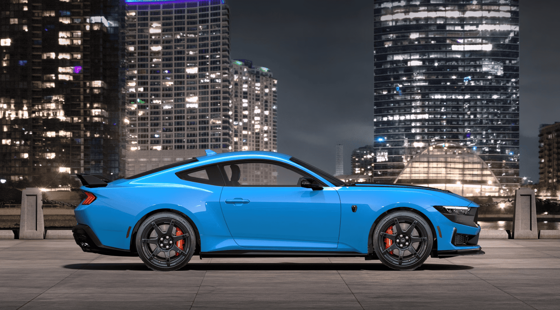

i have wheels on order but dont have my DH yet (it's not even built yet), here's what it will look like
(yes i know the brakes are all wrong, i'm on my laptop and dont care that much for proof of concept)
S650 Mustang Post Pix of your S650 7G with aftermarket wheels and tires 1689171643052
specs:
Front: 19X11", +24mm offset, 325/30R19 tires
Rear: 19X12", +46mm offset, 355/30R19 tires
wheels are Project6GR Seven in gloss black

Are you planning to track the car? Seems like this would be a detrimental amount of tire for the street

not sure yet, but hey, bigger is always better (until it's unusable)

325's in the frontšŸ˜Æ. I plan on putting 315/30R19 in the front but I'm not even sure if those will fit properly. I'm curious but do you have an idea on what the clearance will be for your setup?

i can basically promise you that your 315's will work without issue, i had that on my M1 with 325 rears. as for clearance, i know this is really bad practice but i'm kinda winging it but also kinda not. i am 99% sure things will work out fine, as the front wheels are the same as a GT350R in terms of width and offset, and i figure there's no way so much suspension geometry has changed to cause issues. as for the rears, that's more tricky as idk if anyone has really ever put 19X12" on a Mustang, but basing it off a GT350R again, a stock 350R rear wheel has 8.45" backspacing, where my new wheels will have an 8.31" backspacing. i dont care about poke at all, as i love how it looks. i know i'm making a lot of assumptions, but i am pretty certain that they are safe assumptions to make.

I had ToyoTires 295/30/19 F, 325/30/19 R on my 2017 blew out my fender attachment point like a lot of s550ā€™s 325 your gonna be in trouble also had tramling whatever itā€™s called the car would drift itā€™s due to too large tire in the front I ended up going down to 275 and was a world of difference just my experience with the wide is better theory
