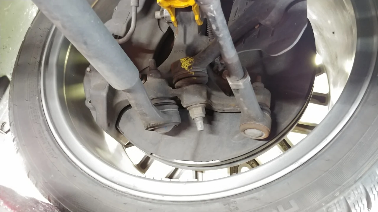

Sounds like the upper control arm.
Had similar symptoms on my S550, there was minimal, very hard to find play in the ball joint.
Marked with yellow chalk:
S650 Mustang 2024 S650 Mustang EcoBoost front suspension clunk/thump over bumps — need help diagnosing IMG_20180208_184824
Replacement is relatively cheap.
Had to replace them twice within 80,000 miles, but always depends on the road conditions.
