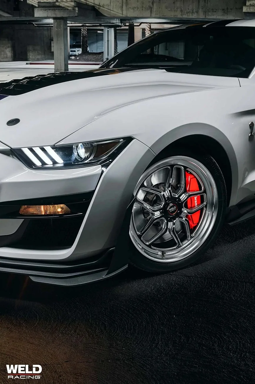

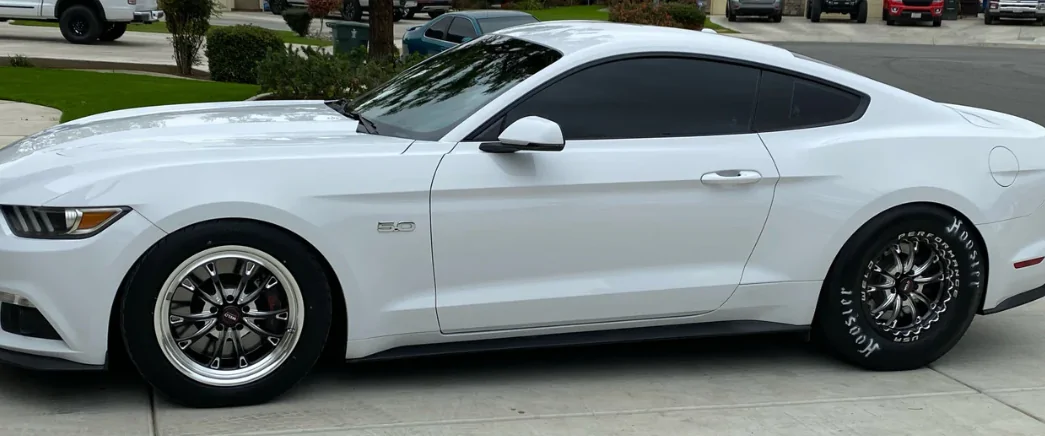

I will also be running staggered front and back tires. Researching combos since I prefer more of an old school drag look.
This is moving towards my style:

Beefy old school drag with front runners is my cup of tea. LOVE IT!

The more I think about it, the more I want to stick with my old-school attitude. Instead of big wheels wrapped in thin rubber, I keep gravitating toward what I grew up with — smaller rims and more sidewall. I’ve always liked the staggered “big and little” look, with pizza cutters up front, even if it’s not the most ideal setup. I’ve lived with that style on rough roads before, so I know what to expect.
The challenge is that keeping the wheels smaller in diameter might not play well with Brembo brakes. Right now I’m considering 17x10 rears and 18x5 fronts, specifically the Weld Laguna wheels. I believe the fronts would clear the Brembos, but the rears may force me to step up to 18s. I’m trying to track down pictures of the 18x10s paired with Brembos to see how they fit.
Whatever wheel and tire combo I choose, I need to be sure it allows me to lower the car without street-driving complications. On the street, I’d likely run Mickey Thompson Sportsman SR tires, just like I did on my ’56 Chevy. For the track, I’d swap them out for Mickey Thompson ETs. Still weighing all of this before I walk into a dealership to hunt for deals.
