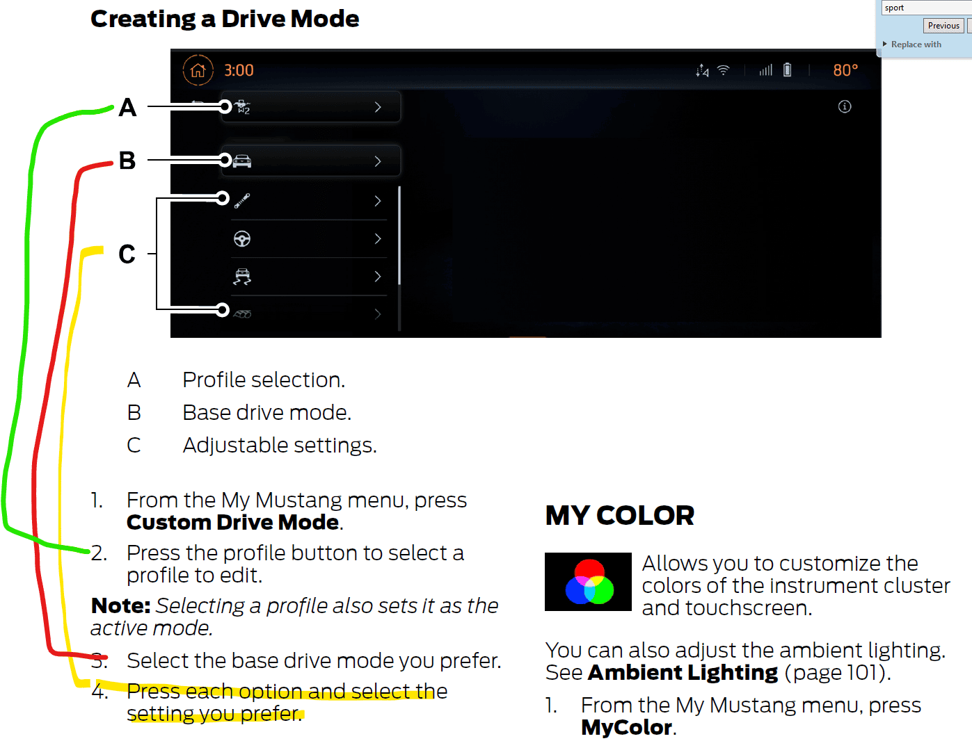

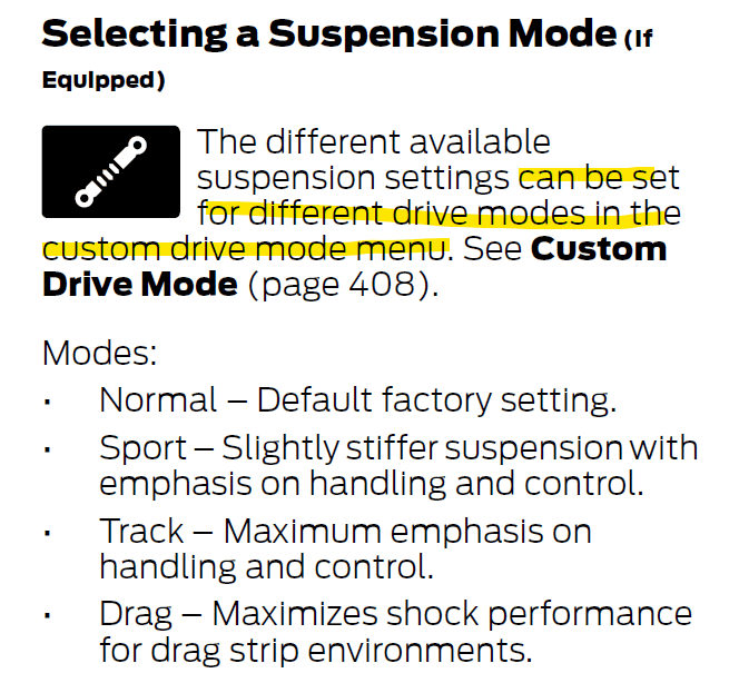

That's not what the owner's manual would appear to indicate:
S650 Mustang Magnaride Question 1710856796397-bx
S650 Mustang Magnaride Question 1710857084968-9u

Looks like they forgot to document that in the owner's manual.
