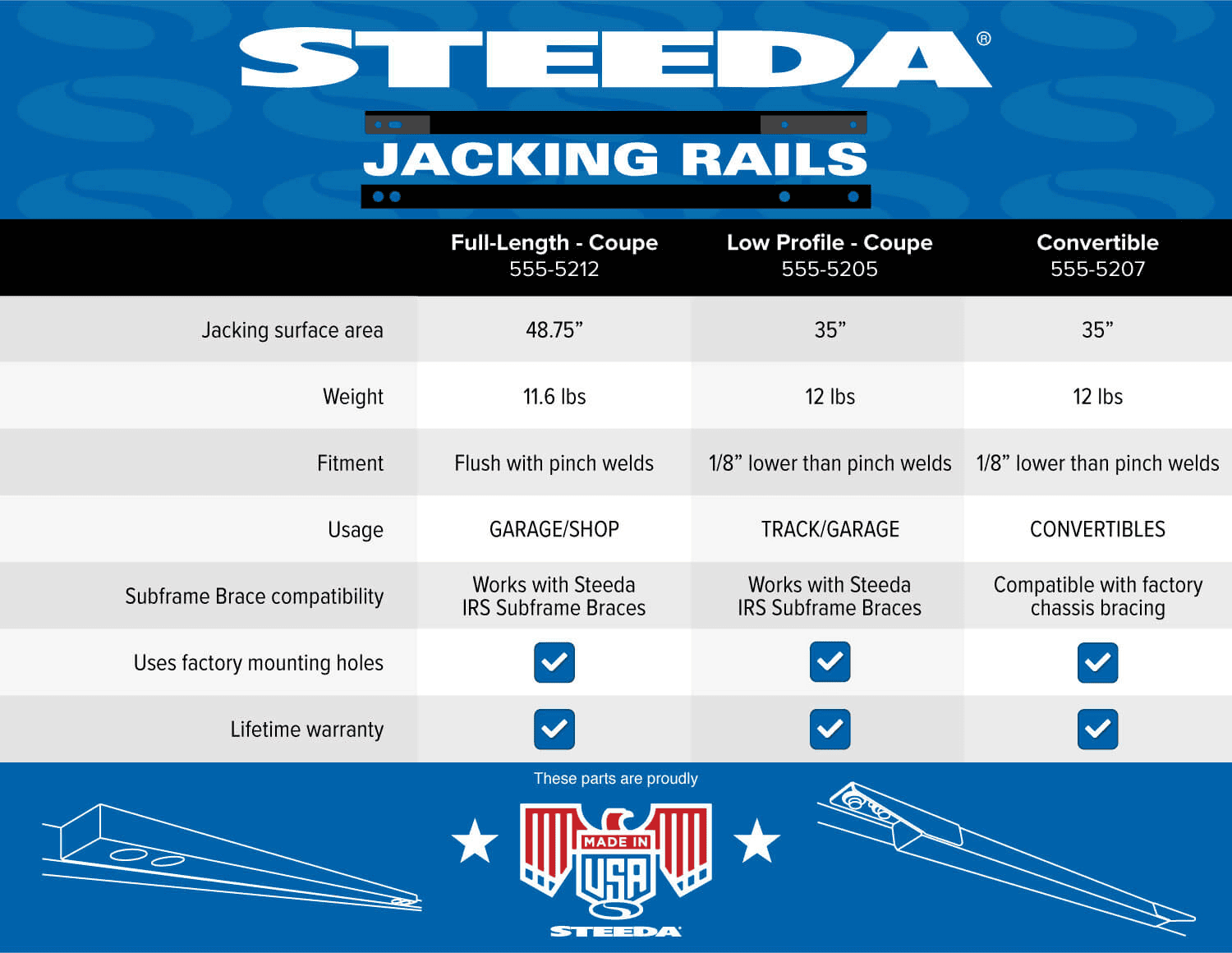

Does anyone know the Steeda Part for the jacking rails that will fit a 24 DH Premium?
I installed the full-length rails: P/N 555 5212
They also offer a low-profile (shorter) rail: P/N 555 5205
Those are for the coupe. The convertible is P/N 555 5207
tj@steeda

Here is an infographic we did explaining the differences:
S650 Mustang Jacking Rail Question 1725411632811-n6
Thanks! I'm actually going to talk to the guys at Steeda.ca tomorrow to add this to my order as it's something I want so I can swap my Velgens and my stock HP Rims for HPDE days.
