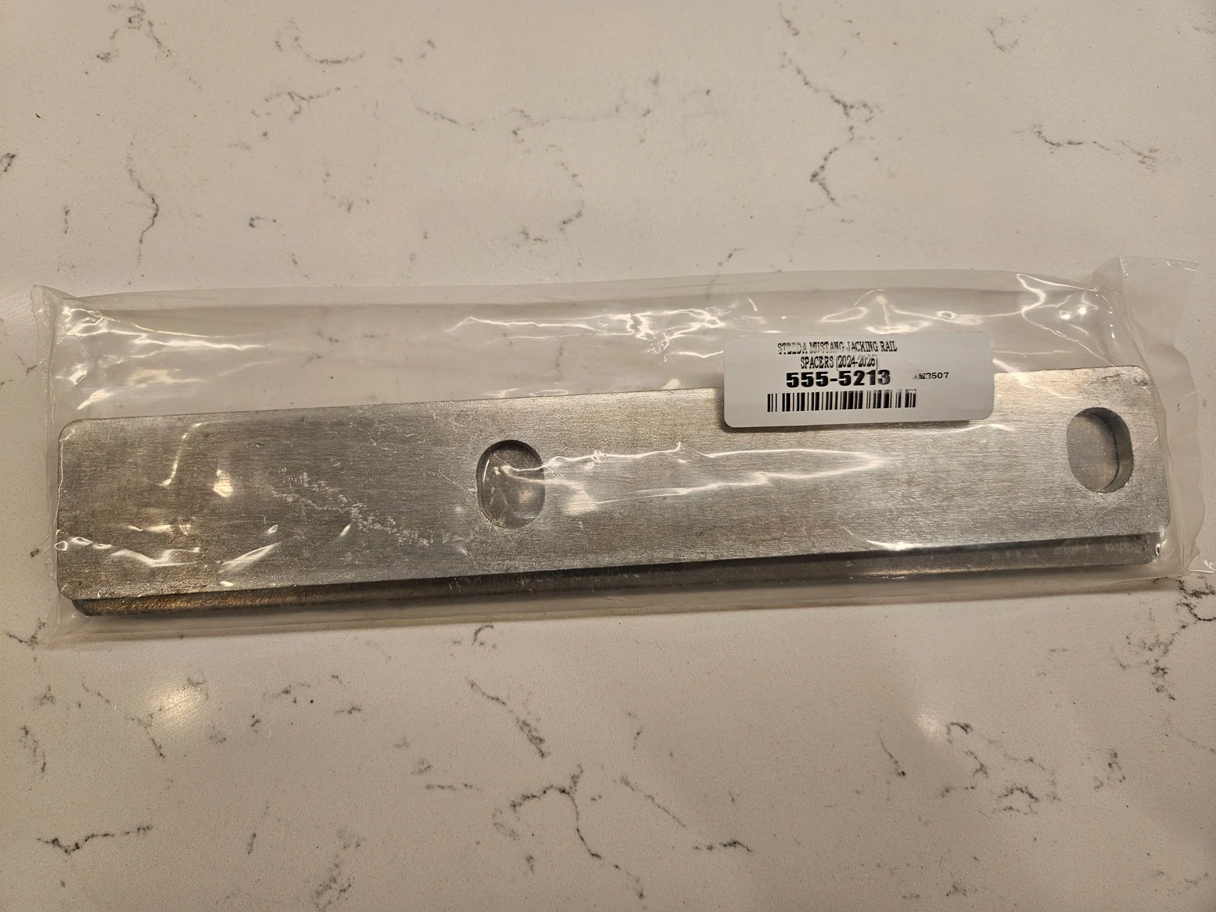

I'll post a pic when spacers come in. I'm not expecting much. Surprised you dislike the rails so much. Most people seem to love them

S650 Mustang Steeda Jacking Rail Spacer Kit 1000008033
1/4" thick, 2" wide, 12-3/8" long aluminum. Slots are 3/4" by 1" and they are 4-7/8" and 11-5/8" on center from the end. Easy to make if you don't want to spend $30.
