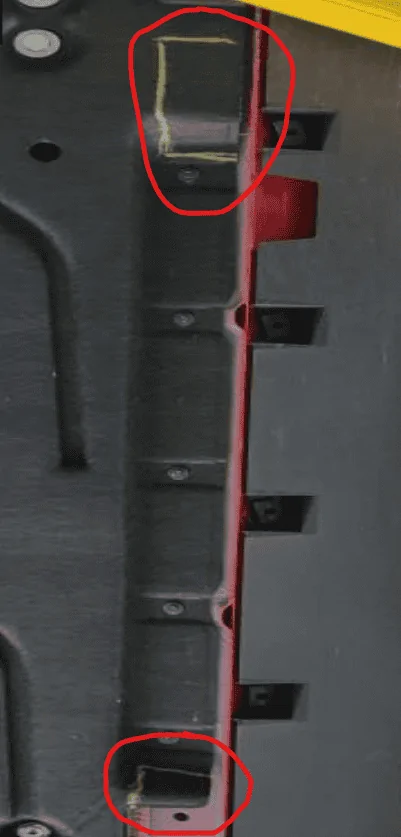

Was it just that small end section of the felt panel that needed trimmed or was it trimmed the full length?
I did not install them myself, but I believe it is just that end portion that has to be trimmed.

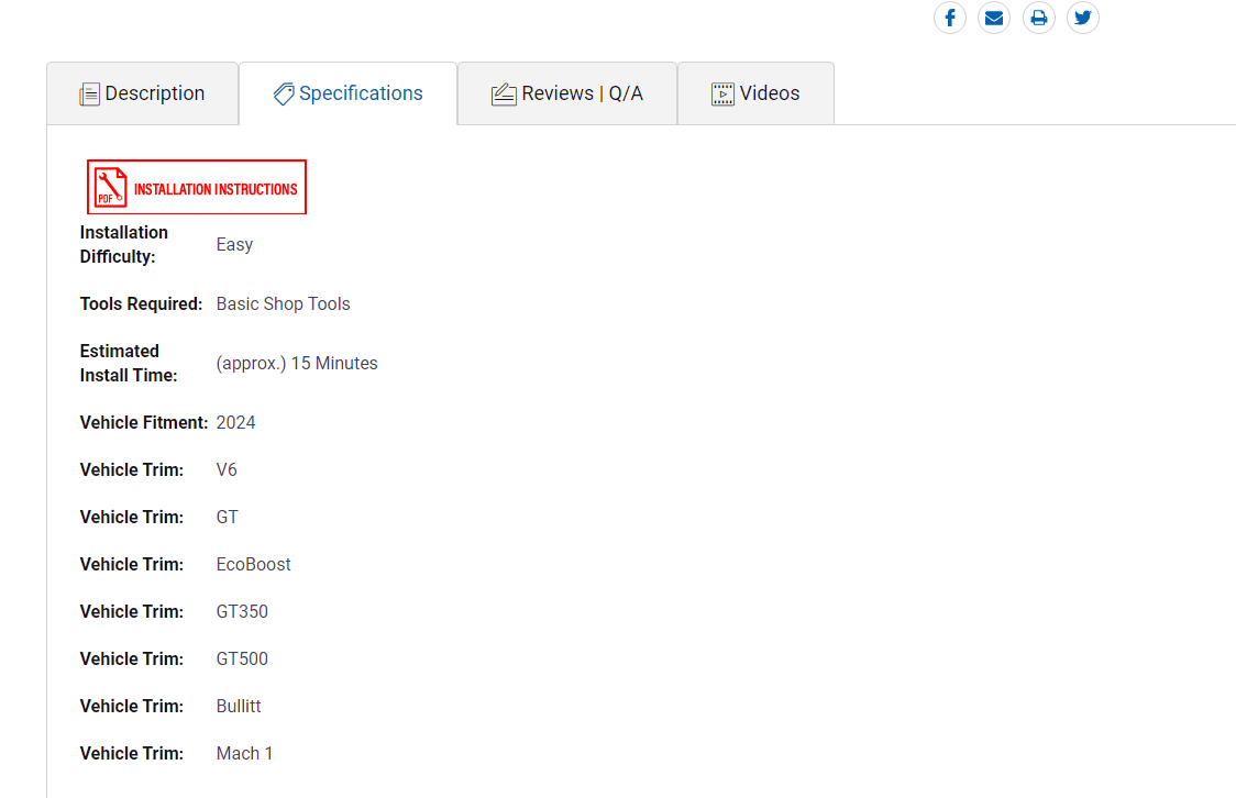

I just got mine from Steeda and I didn't seem to get any kind of instructions for 2024. Is there a .pdf anywhere?
tj@steeda
Mar 21, 2014
124
2,476
865
2015 Steeda Mustang
There should have been a QR code driving you to the online instructions, under the product page, we have them listed here:

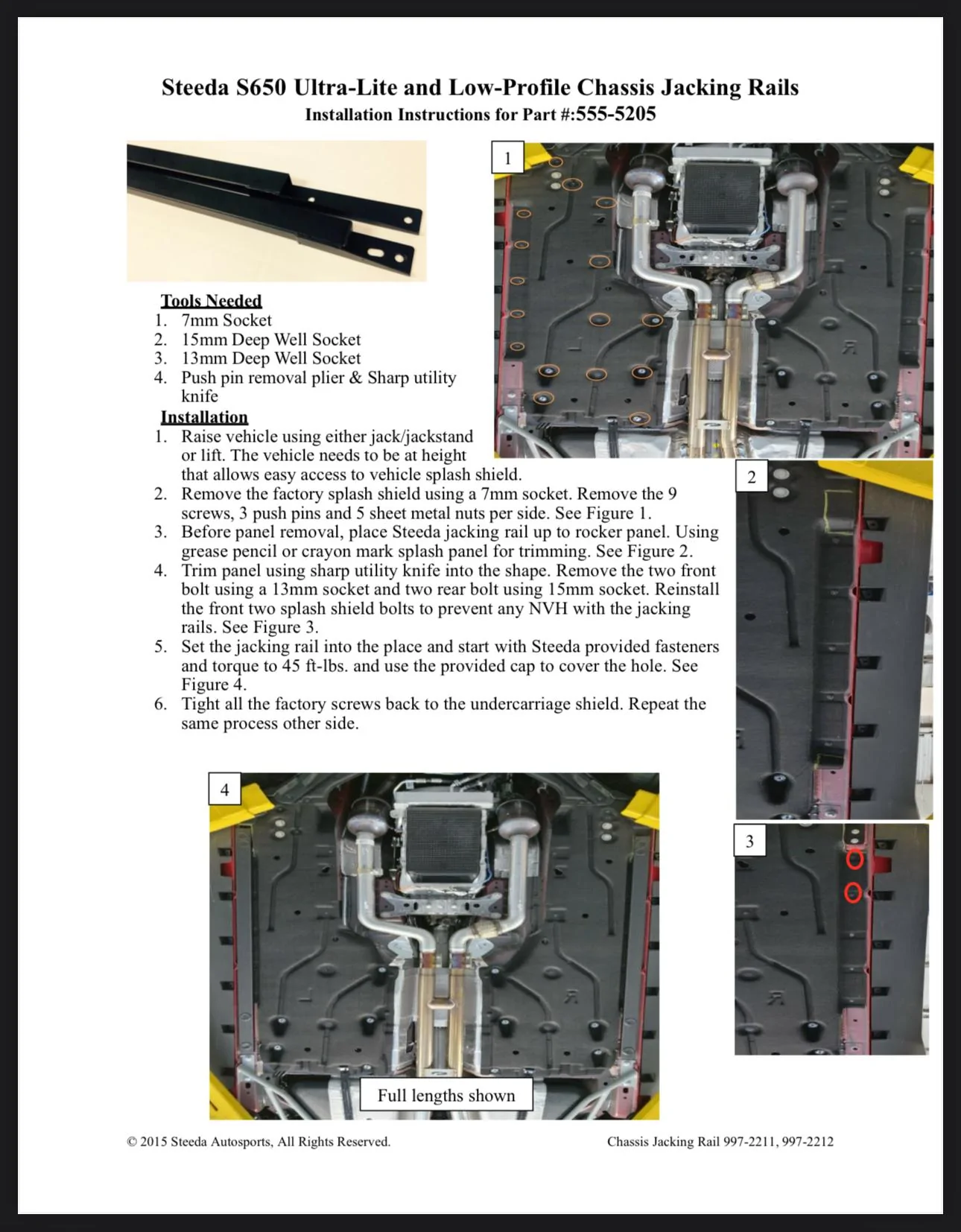

Other than feedback from others who have installed them - I spoke to manufacturing & the labor-intensive part is removing the factory splash shield so that the rails can sit flush in their desired position.
The confusing parts for me were step 2 says to remove the splash panel, then step 3 says “before panel removal”. And can you explain more about why the front 2 bolts have to be installed early to prevent NVH in step 4? Maybe it will make more sense when I get under the car, but I’m having trouble visualizing whats going on there.
Do the rails sit flush with the pinch weld seam or do they stick out a little further?
I'm trying to understand if the lift pad on my jack will touch the pinch weld at all. The edges of the pad are turned up and I dont want them digging into the seam.

Video coming next week. Our tech team indicated the following.
S650 Mustang Jacking rails 1697718971057
