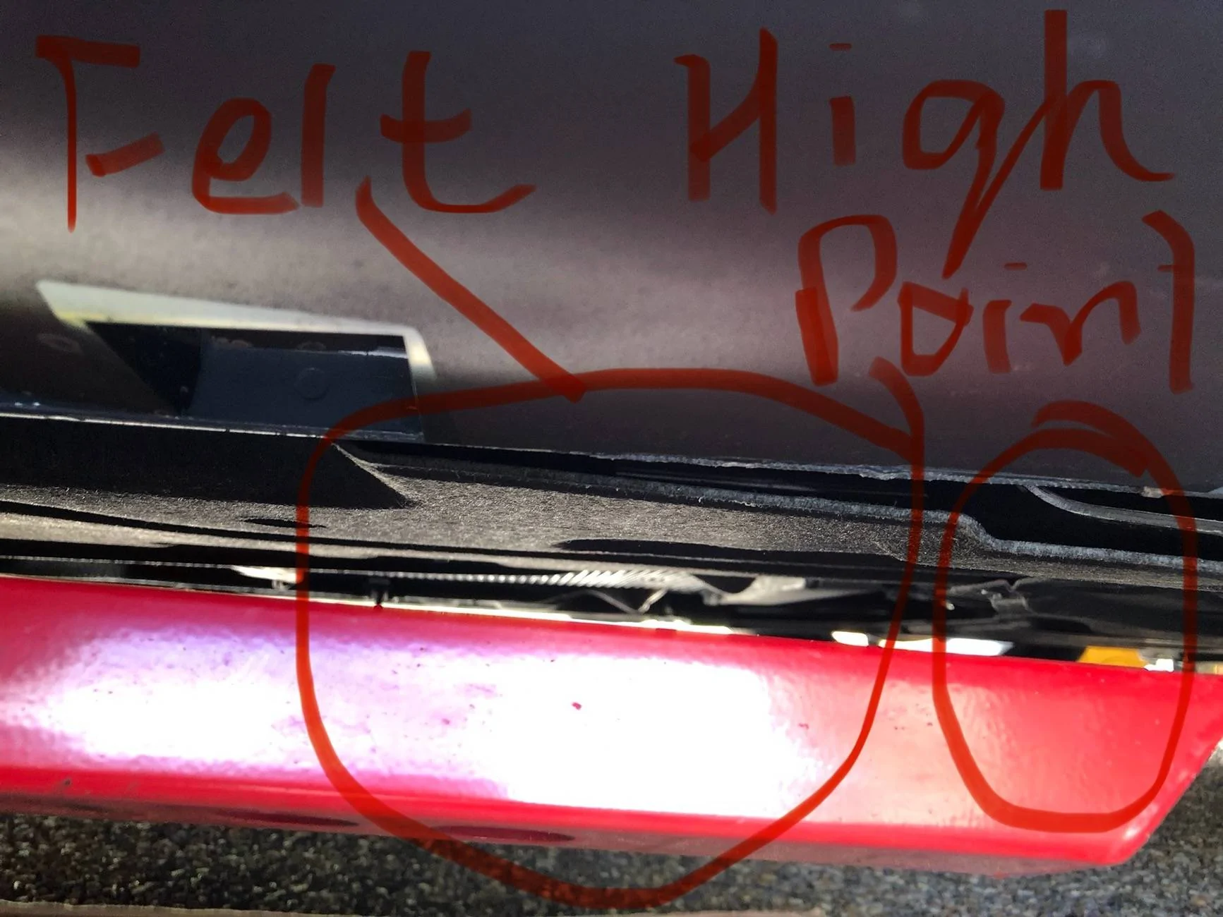

Has anyone put S550 jacking rails that are on the inside of the pinch weld on an S650? I believe it is the same as the Gen 6 cars since the floor pan is the same. https://www.cjponyparts.com/bmr-jac...ammertone-pair-mustang-fastback/p/BMRCJR760B/
I tried today mine did not fit on S650, due to the length of these rails. But mine are full size and NOT the same as shown in the link.
Mine are little too long at the front. They don’t fit despite cutting the felt.
There is a high point right next to where you cut the felt for front bolts.
But these short chassis and steeda one are shorter so they should install ok but old BMR full chassis length one are long and they simply donfit.
I had these rails on my S550 but they do not install on my Dark Horse.
but ones shown in your link should fit fine.
