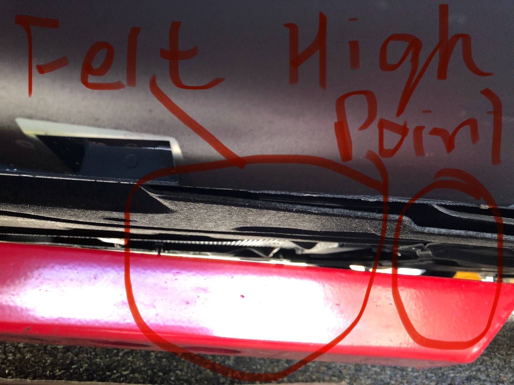

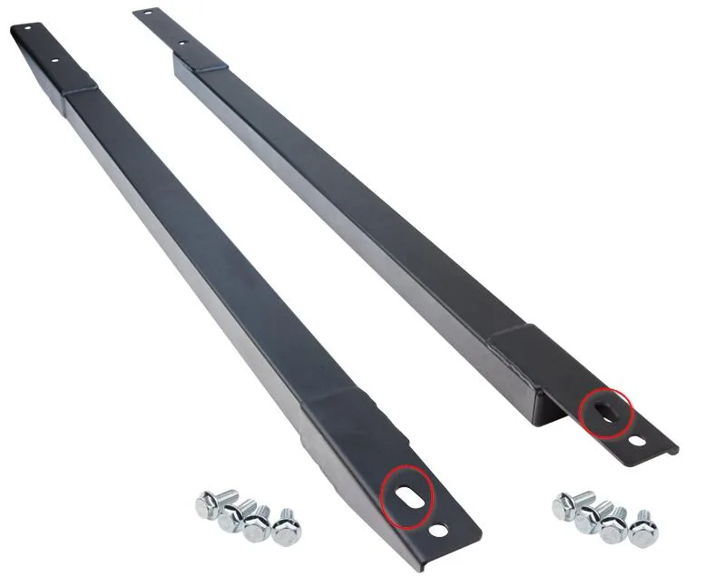

I tried today mine did not fit on S650, due to the length of these rails. But mine are full size and NOT the same as shown in the link.
Mine are little too long at the front. They don’t fit despite cutting the felt.
There is a high point right next to where you cut the felt for front bolts.
But these short chassis and steeda one are shorter so they should install ok but old BMR full chassis length one are long and they simply donfit.
I had these rails on my S550 but they do not install on my Dark Horse.
but ones shown in your link should fit fine.
I bought S550 ones for my S650 and they fit after trimming the felt.

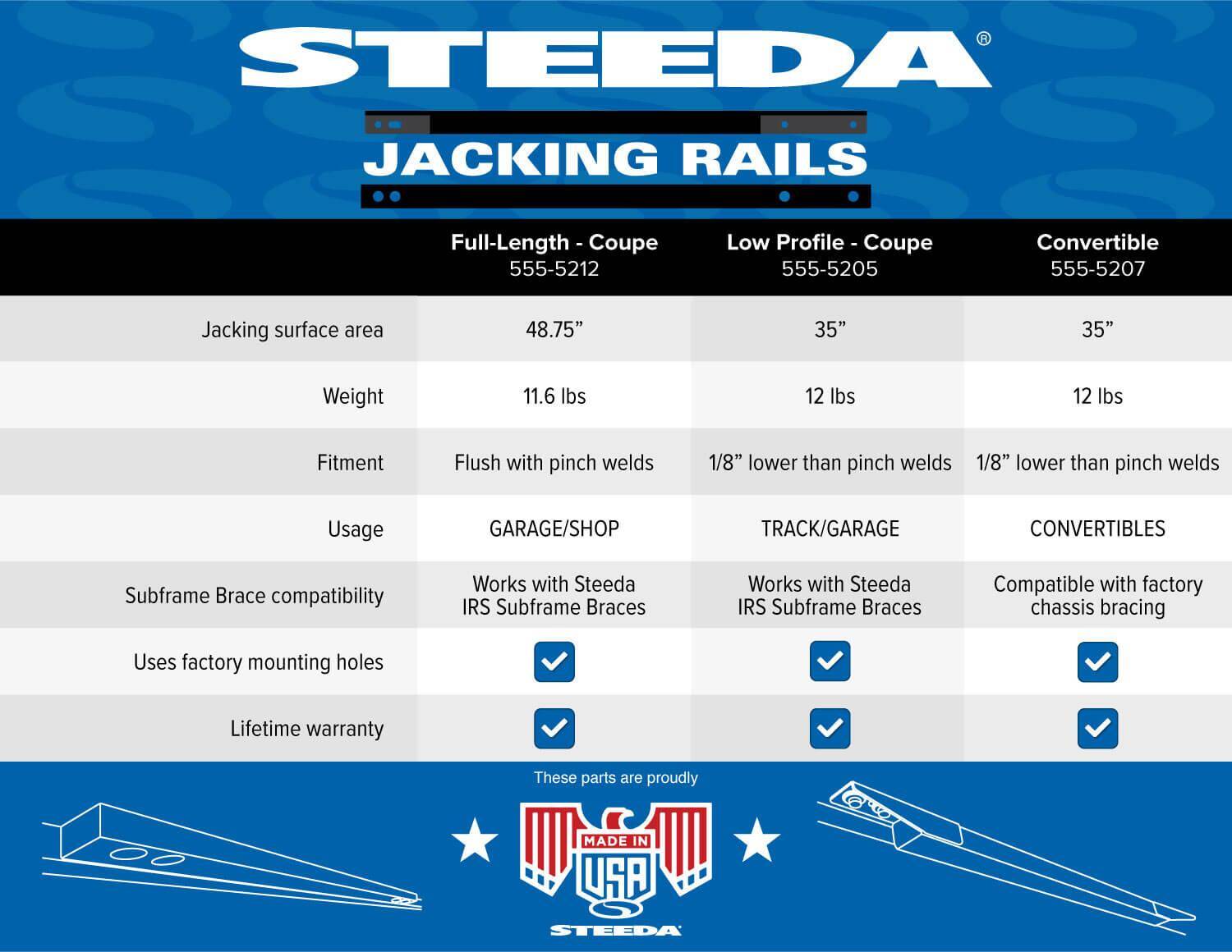

Can anybody explain to me the different jacking rails steeda offers? I watched their video but still did not understand the difference between the two, except the fact that they are a different size, height and weight.
Paul2020
Jan 14, 2020
101
129
Australia
2024 Mustang GT Atlas Blue
I added the Steeda full length rails yesterday. Came off my S550.
They fitted ok apart from the front, where it sits a bit lower as the bolts seem to be attaching to control arm or something so rails don't sit flush like the rear..but still no scraping etc issues.

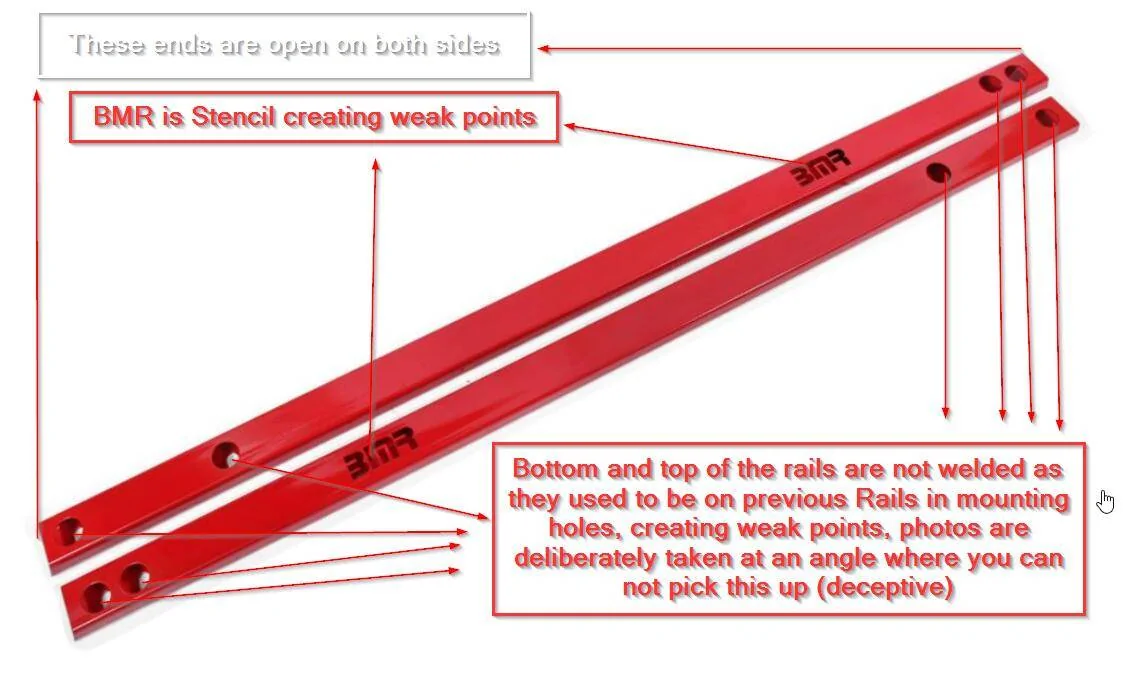

86pagt, I bought full length BMR Rails for my S550 (2016/2017) and they were built good except poor powder coating which i got redone before installing. They were really strong and the way the mounting holes were designed, welded and sealed both ends. Unfortunately i can not install them on my dark Horse, they simply do not fit.
So i bought these low profile BMR Rails hoping it will be same build quality atleast as the previous ones that i had, but i have to tell you i was very disappointed.
  • Firstly the front and rear ends are not sealed/welded, they are simply open which means, rocks water or air will simply go through it potentially creating a flute effect who knows i wasn't able to install and drive so i don't really know.
  • Secondly the power coating also very poor quality as before, it will come off very quickly. I have seen better paint quality then their power coating
  • Then the mounting holes only drill through the top part of the box steel that is closer to the chassis unlike the older ones i have where they have welded the top and bottom to provide that extra strength.
  • Last but not least, they instead of stamping their name in the rail actually stenciled it which means it creates a weak point in the rails where there name is stenciled in the rails.
  • Unfortunately the pictures uploaded by CJ does not show these design flaws in them only described boxed low profile jacking rails and the BMT stencil appears to be a stamped name in the photos.
  • Finally the quality control is not there and they have not left any room for tolerance. I was only able to install one Jacking rail and the other one simply won't line up. Its not that it was out by cms, its quite obvious that if the rail is pushing against the bolt at a slight angle and there is no tolerance then it will damage the bolt threads or the threads in the mounting point of the chassis, which happened in my case.
  • And when raised with CJ, they refused to resolve it either by replacing or issuing a refund. They said they do not have a replacement in stock and then i asked for refund and they won't issue the refund either and said I may not have installed in correctly. How can i install the other side correctly? How can i install the previous ones on my other cars correctly?
  • Just an excuse to deny accountability and do the right thing.
They have previously sent two set of wrong rails to one of the s550 owner. He ordered the rails for convertible and they kept sending it for coupe. It is because of these mistakes they lose money and then try to recover them from customers like us where they try to blame customer for the manufacturing faults in the products they are selling and not backed by manufacturer either. Ultimately us as a customer have to pay the price.
Myself located overseas makes it very expensive because, the cost of shipping itself is about the same as the cost of product. In other words i pay for two set of jacking rails to get one.
S650 Mustang Jacking rails BMR

Looking at the video posted by Steeda, is it me or is the jacking rail above the pinch weld (thus making the rail a moot point)? Flier says flush for full length but it doesn’t really look to be flush.
Sf22giants
Oct 25, 2023
195
261
I’ve got the full lengths on my car. They’re flush.

I wish they made full length that sits 1/8” below the pinch weld which would completely protect it from shop lifts where they just use wide metal lifting pads.
