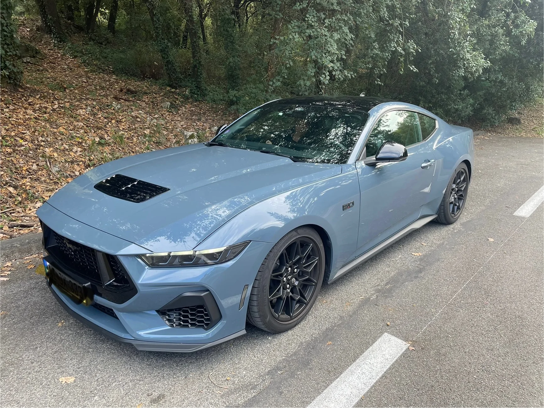

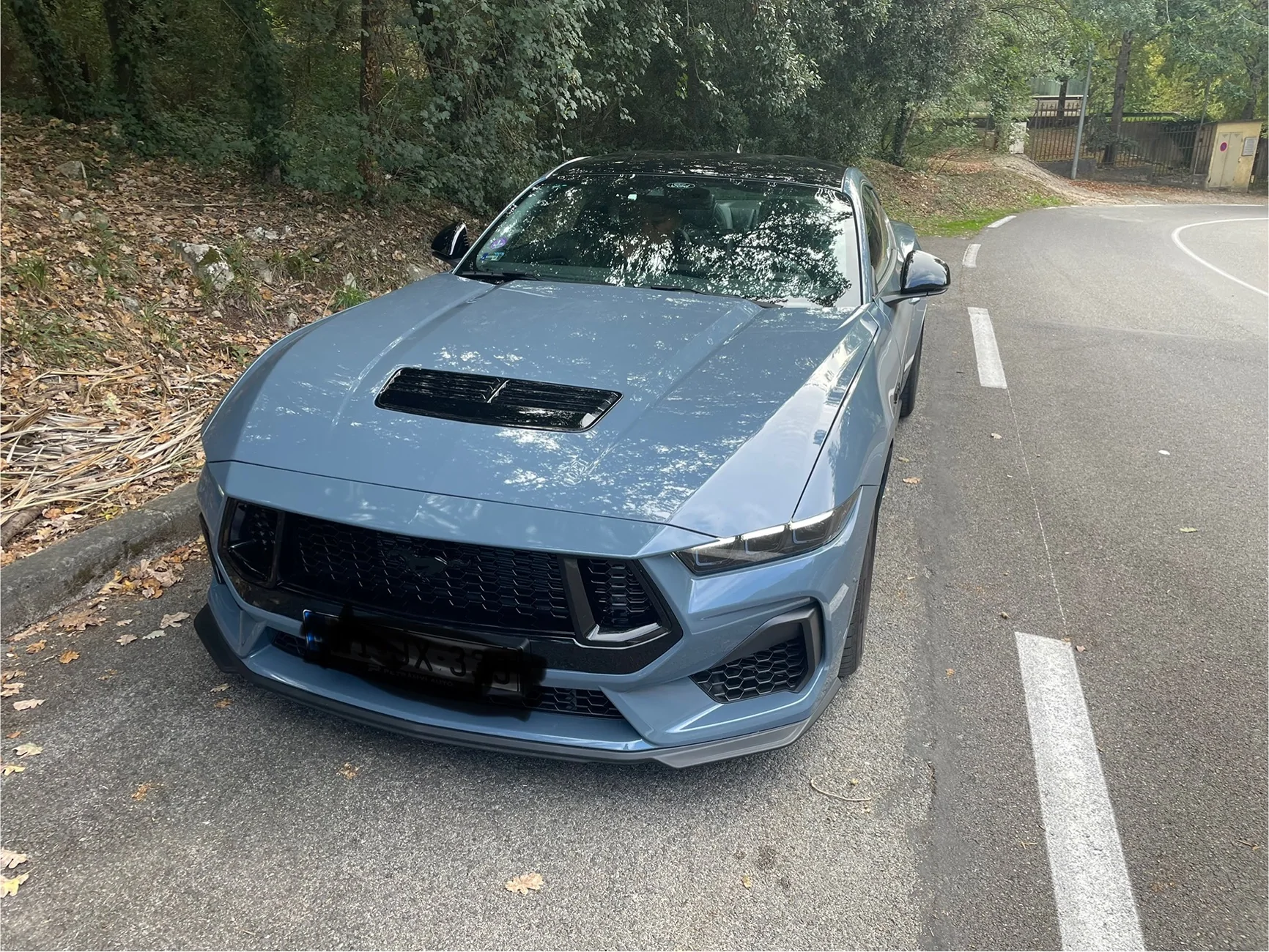

No camber bolts. Don’t trust them and after the springs the front camber stayed at -1.3, which for me is perfect.
I did get the rear camber adjustment kit to bring rear camber a bit upwards (I got -2 after lowering, and put it back to -1.6). No problems with it, the car drives great.
The one small problem is that since my car has magneride I can’t put spacers, so the front tire tucks inwards a bit too much. One day I’ll upgrade the wheels but for now it’s ok.

That looks fantastic! Do you have any issues with ground clearance on speed bumbs, etc?
jml
Jan 13, 2025
90
74
france
Mustang GT 650
Absolutely no issues. I mean, I pay attention when I go over speed bumps, but I never had any problems. No regrets.
