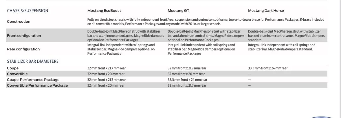

Acknowledging it’s a vert, however why does the gt vert pp get the base coupe sway bars and not the same as the gt coupe pp?

Does MageRide get its own kit? If so, is it the same set for all MR units or differing sizes and or unique programming for the vert and or pp verts, which in turn would require a computer tap (tune) for any edits (mods)?

Could be an error just like the DH 500 HP@ 5200 RPM was listed at.
