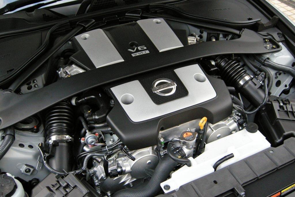

Personally I think Nissan had better implementation of the dual intake concept with the throttle bodies on opposite sides of the intake manifold on the VQ HR engines. This way the incoming air from each intake doesn't get disturbed by the other, like it might with the Gen 4 Coyote design. I'm going to assume packaging/cost constraints prevented them from doing this. And who knows, maybe Ford's CFD models showed that the Nissan style setup wasn't worth it.
VQ37HR for reference

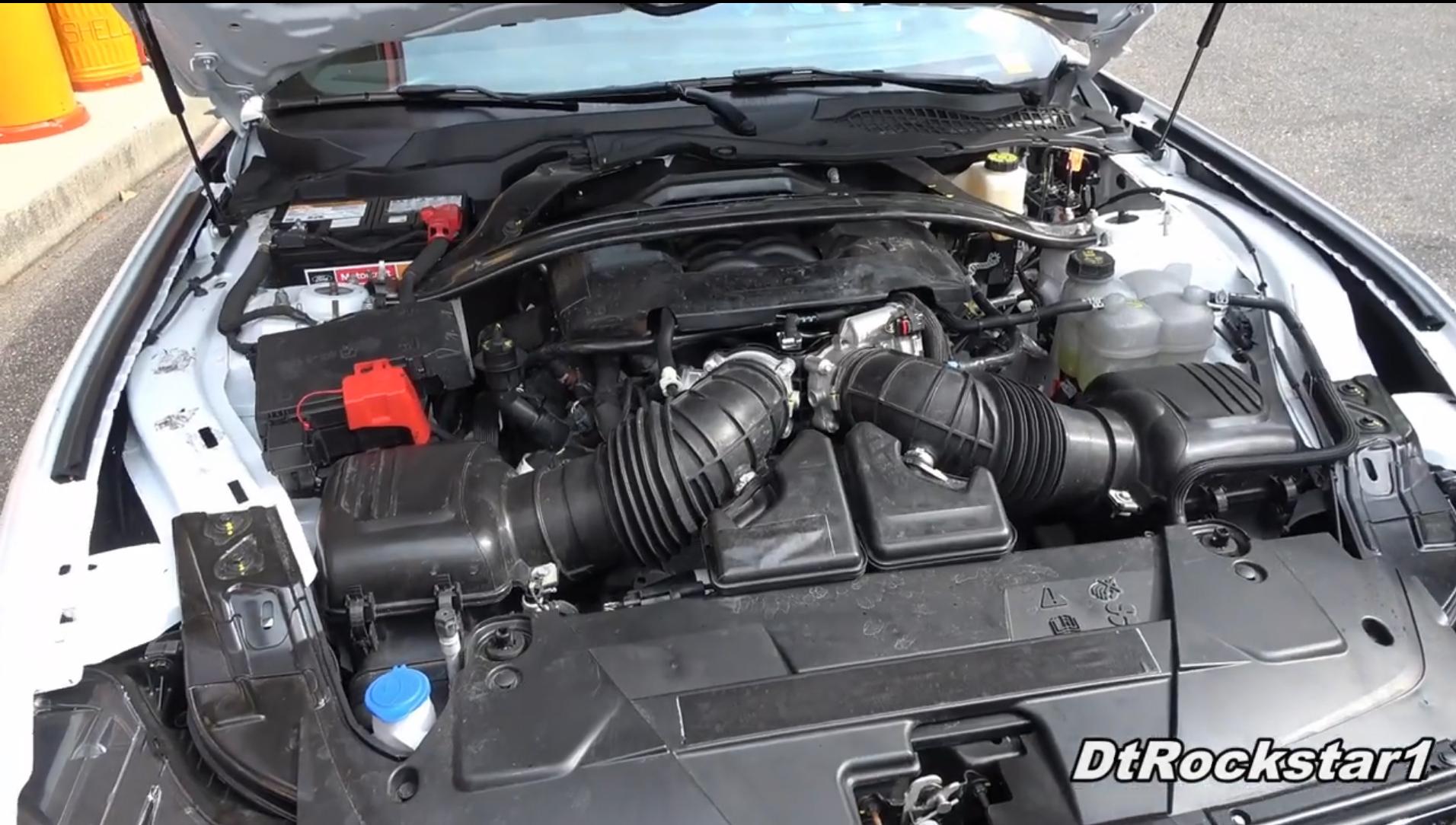

Okay, going to ask the elephant in the room question.
When I first saw the louvers in the hood, I was under the assumption that it was trying to do a mild "ram air" type of situation, where that cold air was going to be going into the engine.
Now that I have seen the setup, all those louvers seem to do is push air into the engine bay. Why are they not trying to extract hot hair from the engine bay? It seems that this would just lower the efficiency of their cooling system as it puts more pressure behind the radiator. Do these hood louvers actually do anything, or it is just a "rule of cool" situation?

I think it is suppose to help the air flow out of the hood during higher speeds to prevent hood lift and help pull out hot air.
