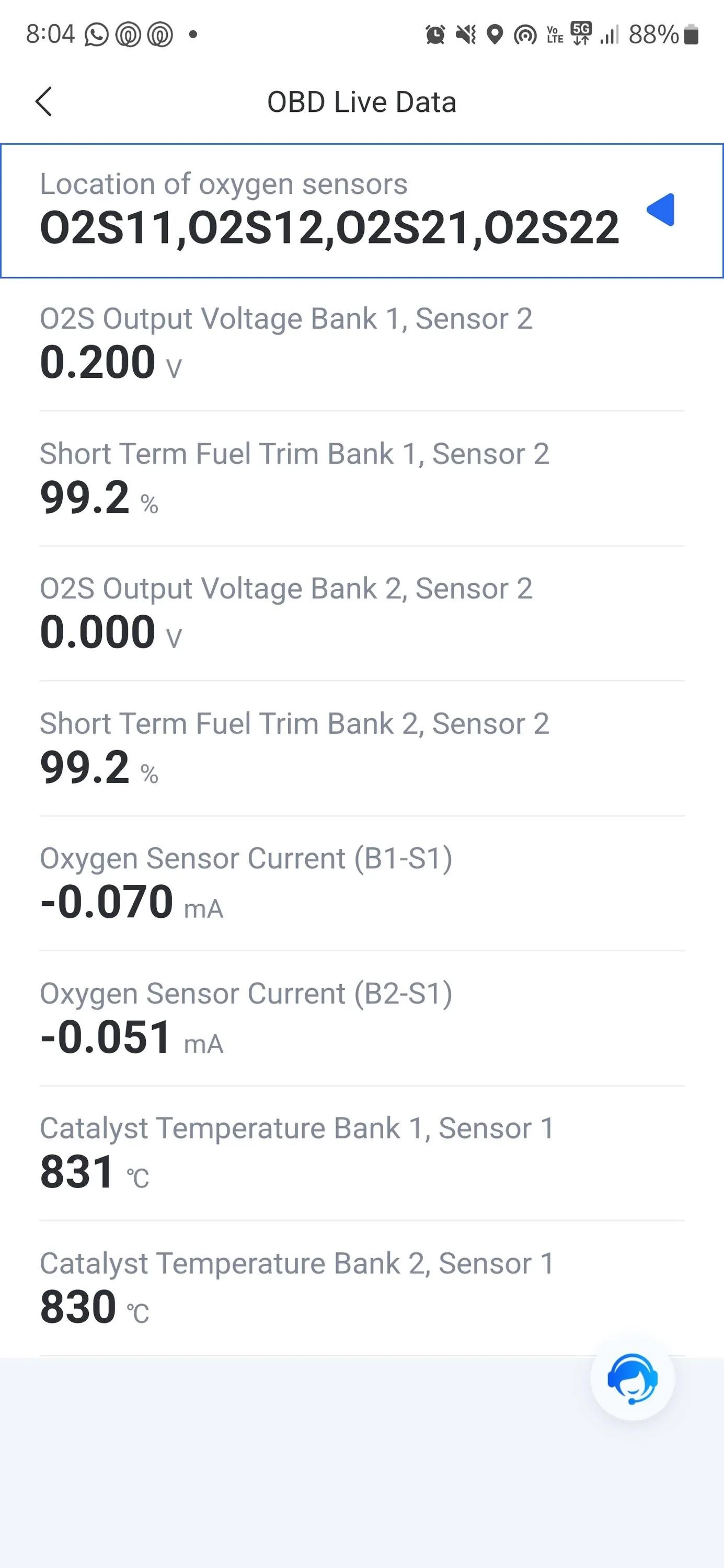

What sort of temps are you guys having on your cars?
I'm seeing 830 celcius (1526 farenheint) @ the cat converters on a stock exhaust manifold and a NA setup.
If you are boosted it'll be helpful aswell.

The cat temp is an inferred temperature based on load, timing, rpm and other parameters.
I'm catless and logged inferred cat temps of 1680f WOT ...
You can go on the 6G forum and search for a thread by engineermike where he's tested exhaust pressure and temps.
